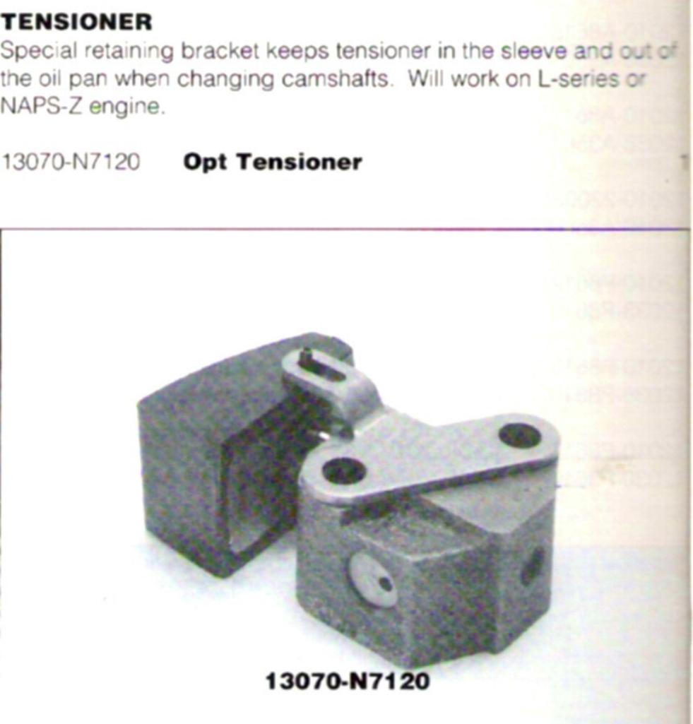

Didn't Nissan make a tensioner that wouldn't fall out. Or was that an aftermarket piece. I have had this happen to me a few times before, it really sucks. When I build my engine I hope to devise a way to prevent the tensioner from falling out. Not that I plan on removing the head, but it will make it much easier if I have to remove the head. Good luck.
Datsun Comp. or Nissan Motorsports made one but I don't think it's still available.
I'm going to have to keep a look out for one of those. The multi-post option really does work. Gary D.
