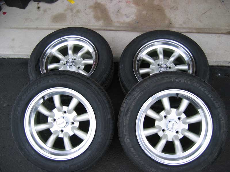

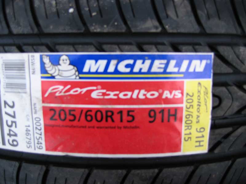

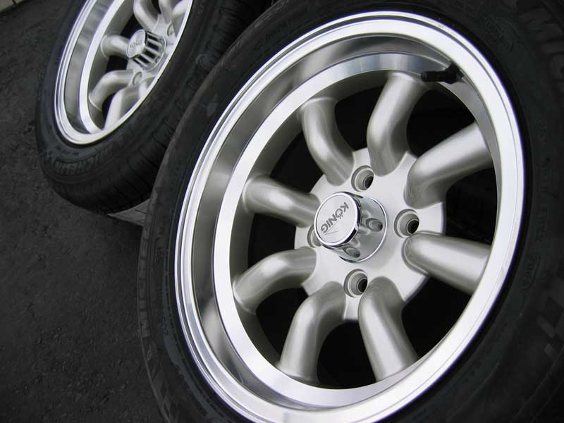

Posted January 1, 200718 yr comment_194441 I finally got the Konig Rewinds I ordered! I got the 15x7, '0' offset in silver. The tires I got with them are 205/60r15 Michelin Pilot Exalto directionals. The back of each rim says 15x7JJ and ET 0. I dont want to bother putting them on now, as Im moving at the end of the month and I dont want to risk getting them scuffed or snowy. The guy said that these tires are a touch wider than most, but that they are good tires. My question is, does anyone know if these tires will be a problem as in they are too wide or anything? I went to the website and found this info: Section Width on Measuring Rim Width: 8.4 on 6 Overall Diameter: 24.5 I just thought I'd ask while I can still take them back and change them if I need to. It wasn't easy finding a local distributor, but Jack at TIREBUTLER in Toronto went out of his way getting them for me. Call him if you need Rewinds! Zak Link to comment https://www.classiczcars.com/forums/topic/22820-finally-got-the-konigs-but-have-a-question/ Share on other sites More sharing options...
January 2, 200718 yr comment_194475 205 are fine I have 225 on my konigs Link to comment https://www.classiczcars.com/forums/topic/22820-finally-got-the-konigs-but-have-a-question/#findComment-194475 Share on other sites More sharing options...
January 2, 200718 yr Author comment_194489 Thanks.Zak Link to comment https://www.classiczcars.com/forums/topic/22820-finally-got-the-konigs-but-have-a-question/#findComment-194489 Share on other sites More sharing options...
January 2, 200718 yr comment_194490 I'm running 225's with Konigs on my car, too. No problems. Link to comment https://www.classiczcars.com/forums/topic/22820-finally-got-the-konigs-but-have-a-question/#findComment-194490 Share on other sites More sharing options...
