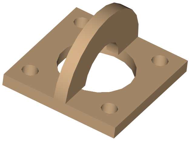

If you have the drum and hardware removed and need to get the axle off look for a description of a special tool in a manual. Most manuals I've seen have a good dimensioned drawing of this tool.

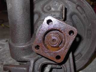

It is possible that a good impact wrench will whizz it off. (400 ft-lb+ rated) The tire would have to be on the ground or held by someone during this.
In the manual the axle nut will come off when you make a tool to lock it. The tool has holes which the lugs attach to and also has a provision for inserting a bar to lock the axle in place. (Mentioned in first reply) Does someone have a picture of the special tool? It is in every manual I've seen made for the Z. It is used when replacing the rear bearings. Trouble is, I can't find any of my manuals to get a picture!
If memory serves me this nut is torqued to 180 ft-lbs. Not having a manual I would refer to one or one of us with a manual before reassembly.

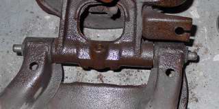

As for the second problem try some penetrating fluid first. (Parts blaster etc...) Allow it to soak for a day or so. If this fails you then a torch should help liberate it. (Think I had to torch mine) Heat the OD of the assembly and try to keep the shaft cool. The temp differential will cause the parts to separate if they are rusted or if there is any interference fit. When I say "torch" I mean Oxyfuel/Acetylene rig as in a "real" torch. A propane torch would not heat it enough or fast enough. If using the torch get new bushings. You were probably going to replace them anyway right? The parts are removed when hot so that the expanded(heated) parts allow to others to slip by freely.

As for the axle locking/pulling tool here is a pic I drew from memory. It's a simple tool made from plate steel. You attach a slide hammer to the tool when pulling the axle or insert a bar in it to lock the axle when using a breaker bar.
Several members of this site make and sell a special tool for removing the spindle pin. With the tool it is a simple and painless job. Don't waste time with torches and such, find and buy the tool instead. You'll be way better off. Here's an eBay link to one of the member's auctions:
http://cgi.ebay.com/ebaymotors/240Z-280Z-Datsun-Rear-Spindle-Pin-Strut-Pin-Puller_W0QQcmdZViewItemQQcategoryZ42609QQihZ002QQitemZ120071161881QQrdZ1
