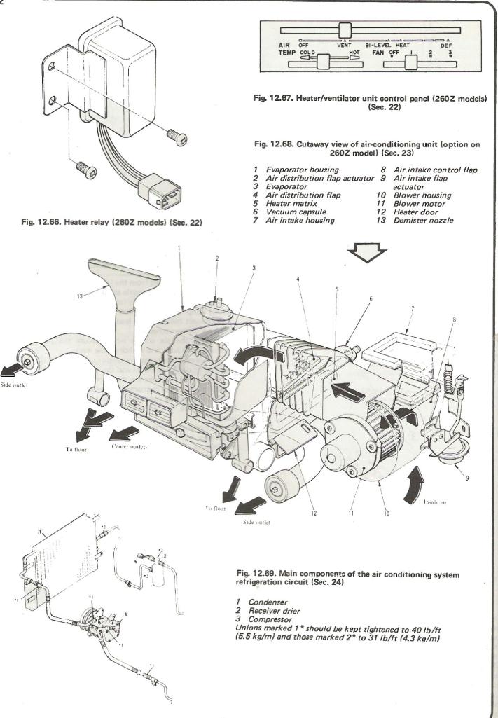

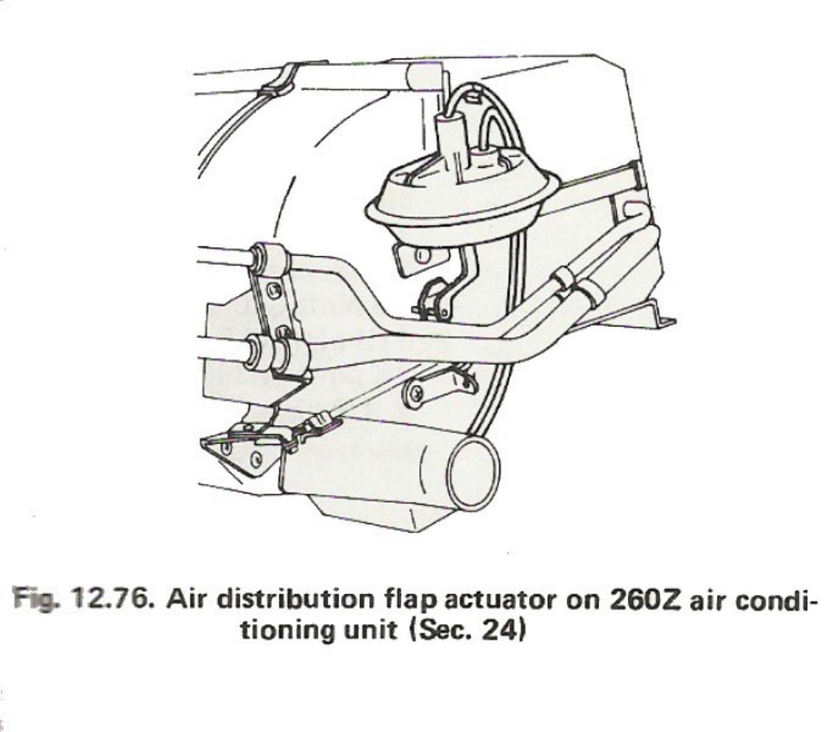

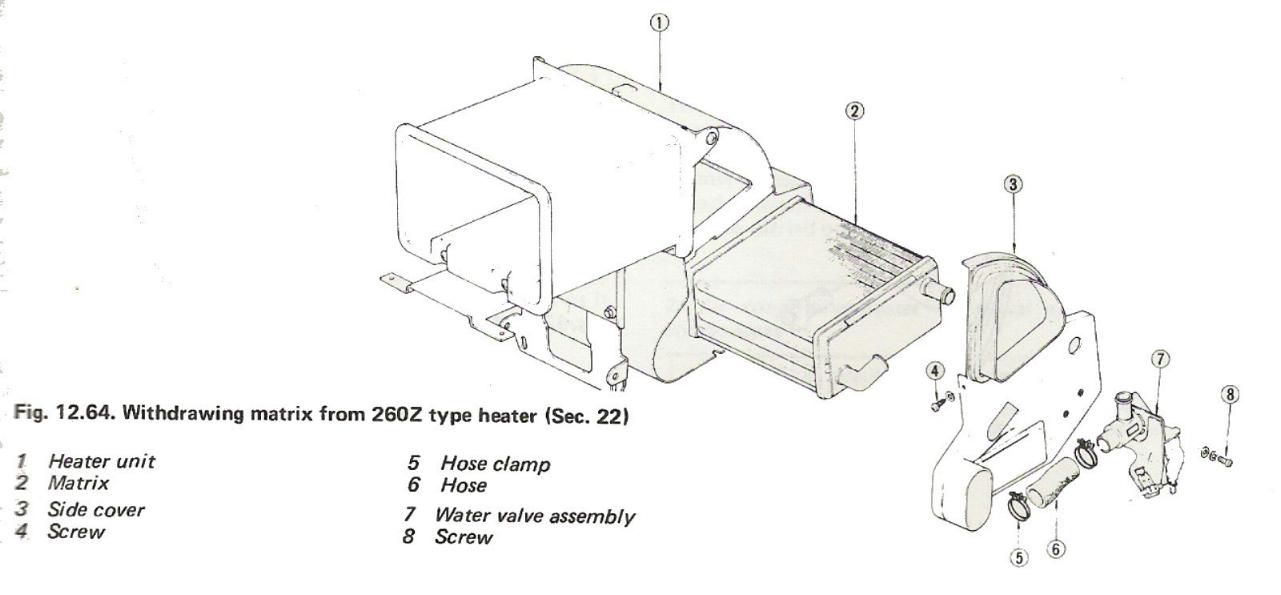

January 7, 200718 yr comment_194905 Nice Stephen! Had a feeling that there were differences between the 240 and 260 "boxes". Do you have a picture of the heater valve/heater core arangement? Hopefully this is as easy as hooking up the vaccum lines or replacing a dashpot. Do you think it's odd that he has only one way flow through his core?Sorry Rebel, There are just a few differences between my system and yours. (Quite a few) The design is the same but it just looks different. On the 240 you have simple cables which attach to the dash controls. Apparently this is not the case on the 260 as it uses a more modern method of actuation... Vacuum actuated dashpots. Looking at Sblakes picture it looks like the heater core is upstream and not in the box like it is on mine. I see there is also a relay for the heater. hmmmA picture out of a manual will tell you a lot more than anything I've shown. I'd be looking at Blakes 1st picture part numbers 4,5&6. (Heater stuff) The one way flow through the hoses still has me stumped.Jim Link to comment https://www.classiczcars.com/forums/topic/22864-water-pump-change-question-260z/?&page=2#findComment-194905 Share on other sites More sharing options...
January 7, 200718 yr comment_194912 Do you have a picture of the heater valve/heater core arangement? This is the best I could find. It's from Haynes as I don't have anFSM for a 260Z. Link to comment https://www.classiczcars.com/forums/topic/22864-water-pump-change-question-260z/?&page=2#findComment-194912 Share on other sites More sharing options...

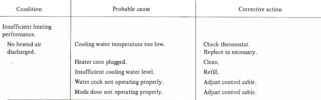

January 8, 200718 yr comment_194965 If it feels cold when the engine is running then the water isn't getting to the heater core. Sounds like the valve is stuck closed or something is blocking the flow of water to the core. This is from my 78 280Z FSM. Link to comment https://www.classiczcars.com/forums/topic/22864-water-pump-change-question-260z/?&page=2#findComment-194965 Share on other sites More sharing options...
