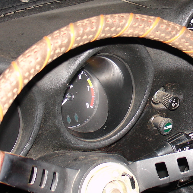

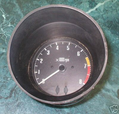

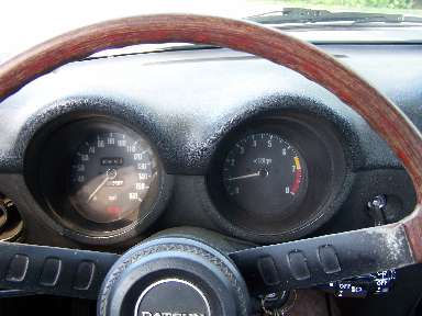

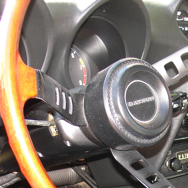

Posted January 8, 200718 yr comment_194964 Well my tachometer redlines at 7k rpm. I think that this is some aftermarket tach. Isnt the redline of the L24 E31 motor 6k rpm with the powerband topping out at 5.6k rpm? I just want to make sure that it is a 6k rpm redline just so that I dont kill the motor thinking that I can take it up to 7k rpm. Link to comment https://www.classiczcars.com/forums/topic/22878-rev-range-is-this-right/ Share on other sites More sharing options...
January 8, 200718 yr comment_194975 Nope. Yellow at 6500 and red at 7000 is normal for 240Z. Link to comment https://www.classiczcars.com/forums/topic/22878-rev-range-is-this-right/#findComment-194975 Share on other sites More sharing options...
