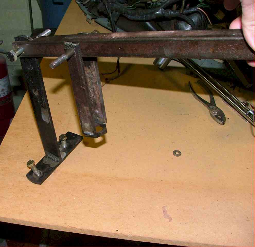

FWIW/ You can make a valve spring compressor pretty cheap. It's another story when you are removing the valves instead of compressing them. It's much easier and faster to make/use a bench tool. The inner springs make things a little complicated when trying to get the collets out/in. (If you try and compress by gripping the springs)

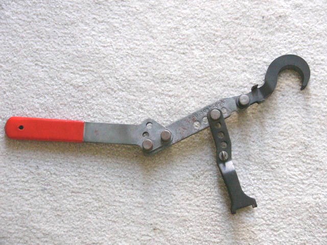

Spring compressors! the clamp kind suck... I speak from experiance. I spent hours trying to take off the springs with the stupid clamp kind of compressor. After I got them off I took a trip down to MSA and I told Sal how much trouble I was having with my valve springs. Sal was nice enough to lend me his "leverage" spring compressor. I was awesome. I put all of my springs back in 45 minutes. JimmyZ Made a great tool, but instead of bolting it to the bench just turn thoes long amrs into hooks that hook around the cam shaft, then you can use the leverage off the cam shaft. It looks just like JimmyZ's design but with hooks instead of table bolts.

Sal was nice enough to lend me his "leverage" spring compressor. It was awesome.
I couldn't agree more. Here's a pic of my "leverage" compressor. It's a K-D 3087.
Edit: Here's one on eBay - http://cgi.ebay.com/ebaymotors/KD-Tools-Valve-Spring-Compressor-KDT3087_W0QQcmdZViewItemQQcategoryZ35625QQihZ013QQitemZ230070894882QQrdZ1
