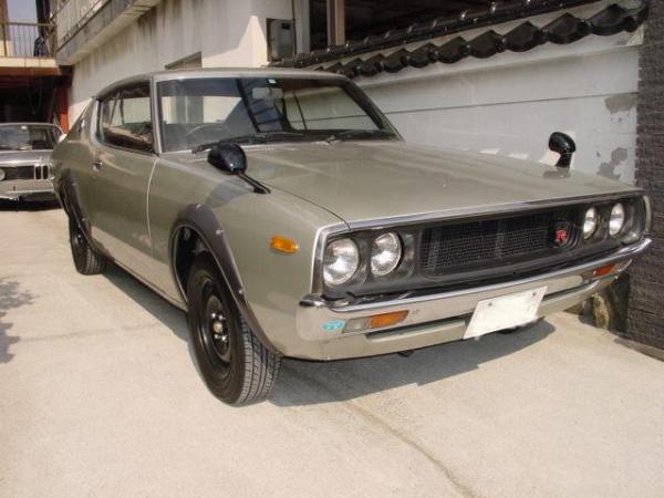

Does anyone have a good stash of real KPGC110 photo's? specifically i would love to get hold of some higher res photo's showing the flares, rear spoiler and front grill.
On the real KPGC110 flares, does anybody know how they are actually attached? are they simply bolted on (like most of the fibreglass ones), or where they actually moulded into the body? also anybody have any ideas what the underside of the wheel well looks like with the real flares on? is the gap between the flare and metal filled? how much of a metal rim does the factory leave under the flare?
since i have stripped my car now, i am seriously thinking about in what order i should fit/paint the flares.. i was just going to clean up the edges of the fibreglass and bolt them on top with a piece of rubber bead between the body and flare.. but i have been thinking lately of actually sticking the flares on the car now, and fill the gaps, then painting them black after the car has it's base coat (then screwing in the rivet heads later on when finished).
I assume the flares on the orginal KPGC110 are just matt black?? anybody got any paint colour codes for these? the mirrors or the front grill?? (i know i am asking questions impossable to answer now!)

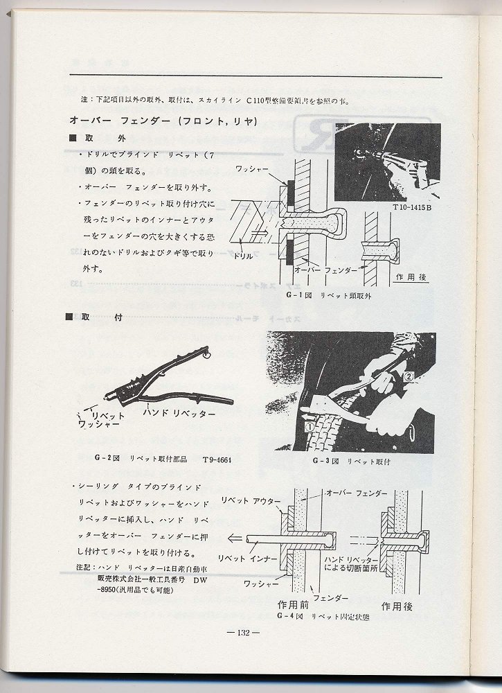

I'm pretty sure that the factory flares were riveted on. I'll check the parts manual, but I recall seeing the rivets listed individually.

They did the same mods to my '71 to make it a GT-R clone. The rear fender is cut up to where it meets the flare. Then the gap is filled with sheet metal that is bolted onto the wheel well arch/inner fender and has non hardening body putty connecting it to the outer fender. The flares are not supposed to be blended, they are clearly bolt on style. The only real difference is that the KPGC110 actually came with front and rear bolt on flares, where as the KPGC10 only had rear flares.

Yes the Flares are rivet on. Can be seen clearly in the Skyline GT-R book by Neko.
As for colour, theres only a couple of colour photo of a red GT-R. They look black, but they dont look the same as the gloss black of the fender mirrors. Looks more like a satin black finish. Doesn't look Matt.
any chance you could scan that page in for me? i dont have too many descent photos of the red GT-R's
pop rivets
no silly rubber bits between flare and body
metallic grey (same colour & finish as rear panel/front grille)
I've seen pictures of what look like satin black flares too. The metallic grey is tricky - it will look black unless in direct sunlight. I am growing to believe perhaps both colours were used (black & metallic grey).
Yeah, I guess Lachlan is right. The grey does look like a satin black.

sorry if you think i ignored you, that isn't the case at all! after reading your post i canned my idea of blending the flares into the bodywork.. I did decide though at the time to stick with my original plan of using rivnuts (i still will), i did faulter there for a second after seeing the factory install page, but i decided i like the look of the hex head screws better!
