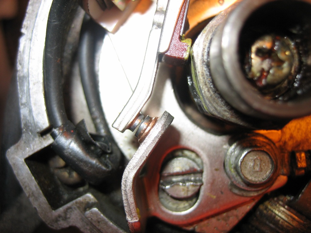

Does this point gap look right to you?
ddezso
I am clearly a novice mechanic. Within the past 6 months my veteran Z mechanic installed, balanced and synched new ZTherapy carbs, valve lash adjustment, timing, new points - the works - and it was running like a dream.
Recently the car has started having mild backfiring when I take it out of gear and the RPM's drop as I coast to a stop - or any time I rev it then release throttle quickly.
I went to the local car show (my mechanic friend is usually there) and since this is a symptom of misfiring we popped the distributor cap and the points were touching which I guess happens over time.
To make a long story longer I adjusted the points which is easy but it is not solving the problem. I've tried all sorts of gaps with no improvement. Plugs are fairly new, plug wires are pretty new, I checked the timing and the marks line up.
Please check out the picture and see if that tells you anything and please advise if you know other obvious things that I am missing.
Thanks..!

Point gap looks kinda small. I also see pitting where the point seized together. You should replace the points. Get new ones at Napa or directly from Nissan. Don't buy cheap points. While you're at it, get a new distributor cap & rotor (from Nissan preferably).
I'm not saying this will fix your problem, but, I believe you should always start with a good set of points and a new cap/rotor. They are cheap (less than $20 for all). These things corrode and can become pitted causing resistance.

Thanks Arne. The emissions equipment is not on the car and hooked up. I'll start with new points, cap, and rotor and go from there.

That point gap looks to be about 1/8" of an inch on this monitor! LOL LOL
Then again, since people are using their monitors for all sorts of :stupid: things, I did adjust the CONTRAST and they don't look scorched at all!
(It's amazing what you can do with the different controls on your monitor, you can even make BLACK look GRAY! ROFL Which means I'm going to have to be "VEWY VEWY CARE-FUL when I use it to match paint colors to send to my printer!!!)
J/K
