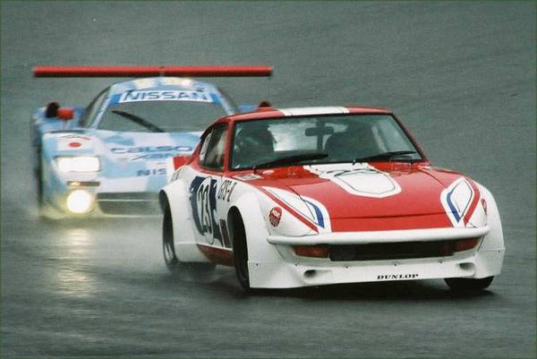

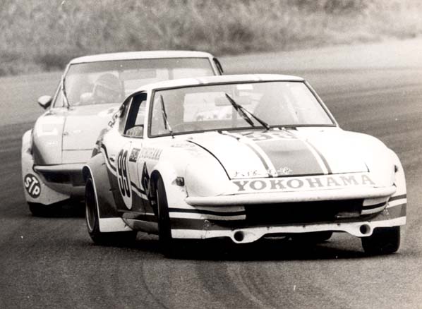

January 20, 200718 yr comment_196256 Nissan produced various body modification parts during the early '70s for racing homoligation purposes and the term "wide body" is used in American slang context. In all probablity, the ebay car is made up of aftermarket parts. To some extent, our cars are so old that aftermarket parts are considered rare. Let me share what little I know about the real Nissan stuff. At the time the Z was introduced, a series of "Sports Option" parts became available and were published in Sports Option catalogs. In America, the sports option parts were sold through the Datsun USA Competition department. The earliest Datsun competition catalogs date back to the roadster and 510. The Nissan Sports Option catalogs included many items for the S30 - Z - exclusively including engine and transmission parts, suspension parts, seats, roll bars, you-name-it, and body parts such as fender flares, spooks and spoilers. I most usually associate the fender flares on the ebay car with flare kits Nissan sold for the HS30-H. Those pieces included fender flares and front spook / air dam components. Fender flares from Nissan came in two sizes and I think MSA sell pretty good repros of the smaller flares. All of the authentic Nissan pieces I have seen are made of the FRP material we know from the early headlight scoops and were mechanically fastened to the body with rivets, screws or bolts. Having said all this, let me point out that there are many threads on this site discussing this very subject and the guy with the most information is "HS30-H". A search through the archives should reveal a wide range of discussions and has been the source for all the information I have collected. Other references I might suggest include Pete Evanow's book; "35 Years of Datsun's Sports Car" and Brian Long's; "Datsun Z". Link to comment https://www.classiczcars.com/forums/topic/23000-what-is-a-wide-body/#findComment-196256 Share on other sites More sharing options...
