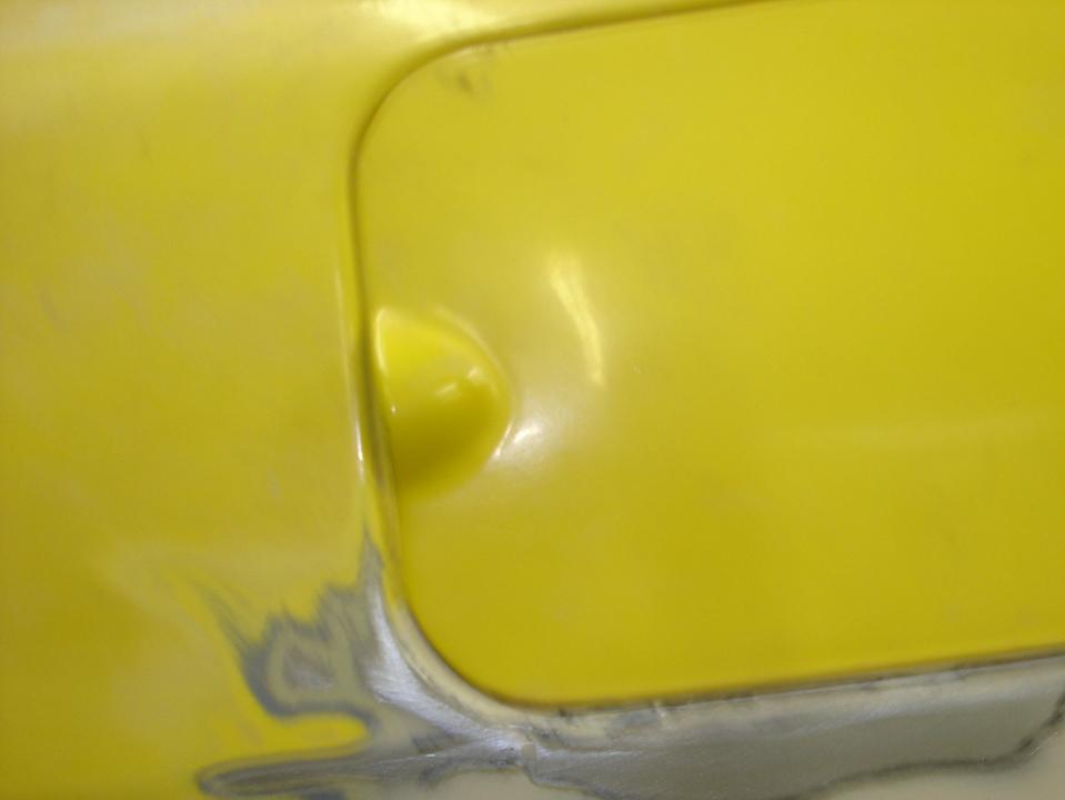

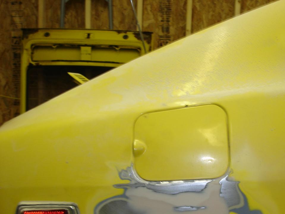

So far it is coming along good, had had to manufacture some small panels and cut out and weld in, pretty proud of myself, looking ok, of course Im ANAL, so if the filler dosent look right i take it all off and redo it again LOL.

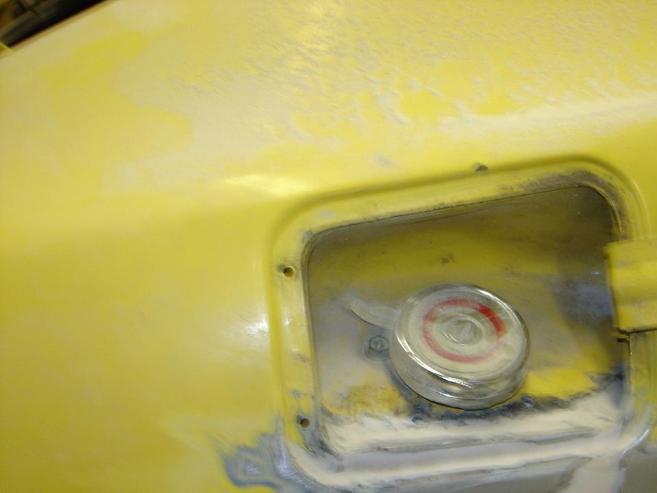

here are a couple pics of the gas fill compartment that was rusted thru on the inside panel and on the outside body, I cut both out and hand made new and welded in.

The first problem I see is - body filler on bare metal. NEVER put any type of body filler other than lead on bare metal. All modern body fillers are some type of plastic... ie epoxy fillers. As they dry, they will suck moisture out of the air, and through the metal they are in contact with.
Actually "suck" is figurative - the process is osmosis and sheetmetal is permeable.
Always cover bare metal with an epoxy primer - to seal any body fillers away from the metal. Then allow enough time for the body filler to dry, shrink etc.
When you see a paint job that is less than 5 years old - with the body work bubbling up.. you're usually seeing the effects of body fillers that were not sealed away from the metal - or body fillers that were used to fill holes that should have been metal patched. When you see fine cracks in the body fillers, it is usually because not enough time was allowed for the filler to dry/shrink completely (90 days isn't unusual in the better restoration shops and many allow 120 to 180 days)
The glazing putty - is used for final filling in very thin coats. It dry quickly, and sands out less porously or smoother and shrinks less. Some types resist absorption of the primers/paints applied over the top to provide more uniform color with thinner coats..

Thanks carl, But i did put primer on first, I used a rust type converter over all bare metal and any areas or rust that wernt bad enough to cut out, like surface rust that had a little pitting, thought that stuff would be the safest to use, then I used filler over that , then sanded down to smooth. Ddint know about the filler shink/cure time though.
so if I understand the glazing putty thing right, it is used over the top of filler in thin coats to fill like pitts or minor swirls/scatches in the filler?, what about small tiny chips in paint , whats the best way to do them, with filler or putty or sand down to bare metal in a larger area?
Because I really dont want to take the whole body down to bare metal, the paint seems real solid!
