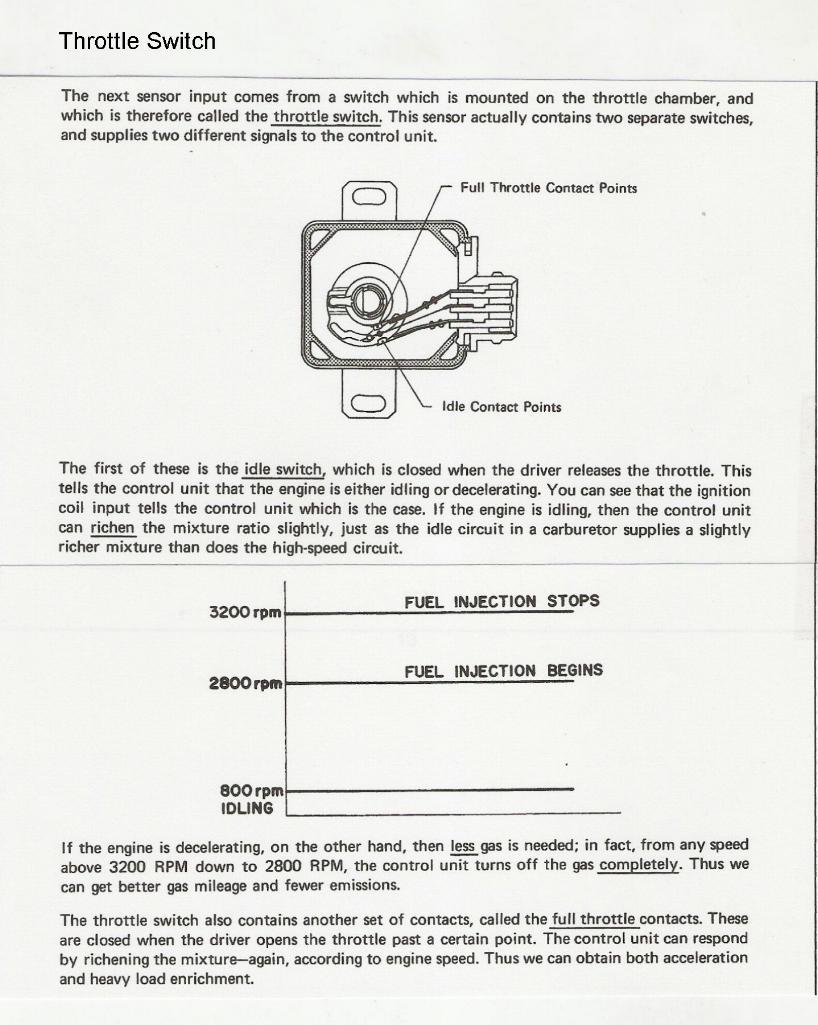

The throttle valve switch has two sets of contacts for your car. At idle, one set of contacts is closed. When the throttle is opened any amount they should open.
At full throttle, the other set of contacts close but are open at all other times. This is for fuel enrichment correction.
Easy thing to test. Perhaps all it needs adjusting or the contacts cleaned.

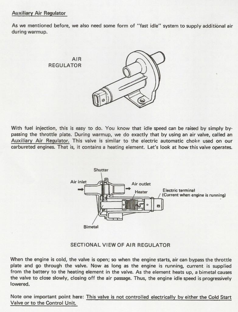

The area I highlighted in your post is not a function of the throttle switch. What you describe is what the auxiliary air valve does. Look at these two attachments.
Thanks for the info. Also, with the tps connected, if you're in second gear for example and you hit about 2800 rpm, a wiplash effect happens because I learned that one set of the contracts tells the efi computer to shut off the injectors at 2800 for de accleration if one set of the contacts are corroted. And by disconnecting the tps, this goes away.
