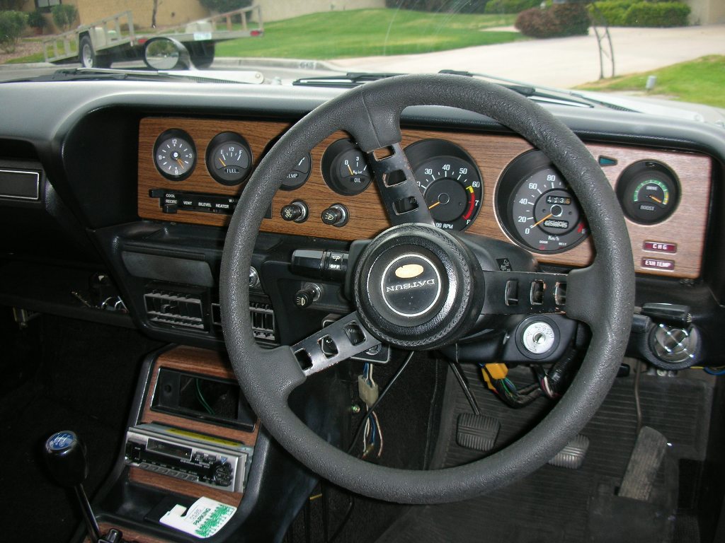

Trying to find out a little more about the 1977 GC111 I just got.
The dash has a boost gauage (far right side of panel next to speedo). Gauge is marked boost and just above the needle reads "DRIVE". From looking on the web, i thought the GC211 was the first style for the turbo EFI motor.
My car was modified in Japan with triple DCOE carbs, but the EFI harnes remains in the car.
Any help or comments......
Yeah, vacuum gauge.
If it was boost then it would have a 'zero' position somewhere within the scale and the pointer would sit on that marker with engine off.
Has to be done that way so the gauge can display both below and above atmospheric pressure.
Possible that JDM had a L20E that early but very unlikely an L20ET

Thanks for the input guys. I thought is was strange to call it a boost gauge if all it does is measure vaccum. I don't want to pull the dash apart just to track down where the lines run to. Maybe if I switch over to the brushed metal look instead of the fake wood grain I'll take a look at the back side.

Yeah they put the vacuum gauge into cars and called them economy meters, since the greater the vacuum, the more fuel you were using.

Vacuum gauges setup for in dash reading generally show a sweet spot or a range that indicates best economy driving. Hard acceleration would show low to nil vacuum, while overrun will show high vacuum.
I still swear by them for tuning older carbed engines.
