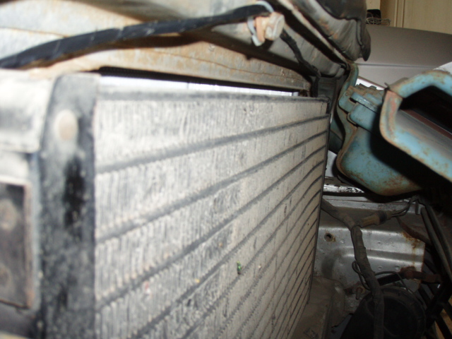

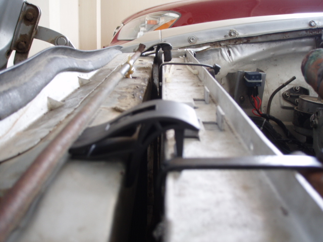

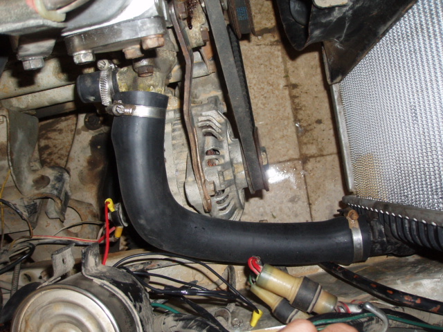

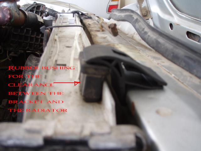

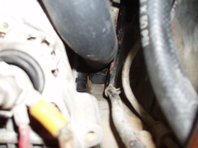

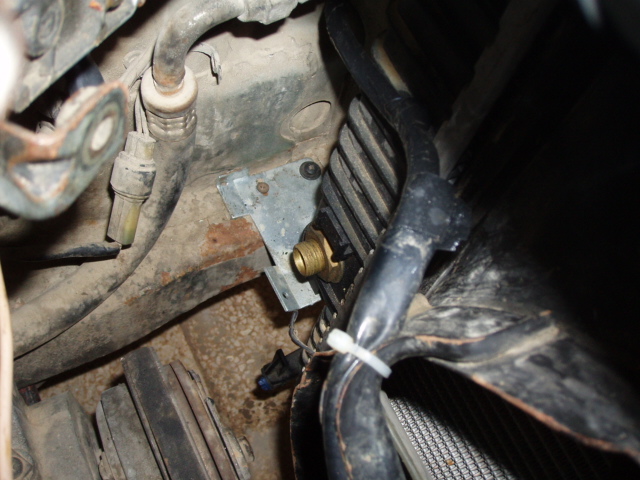

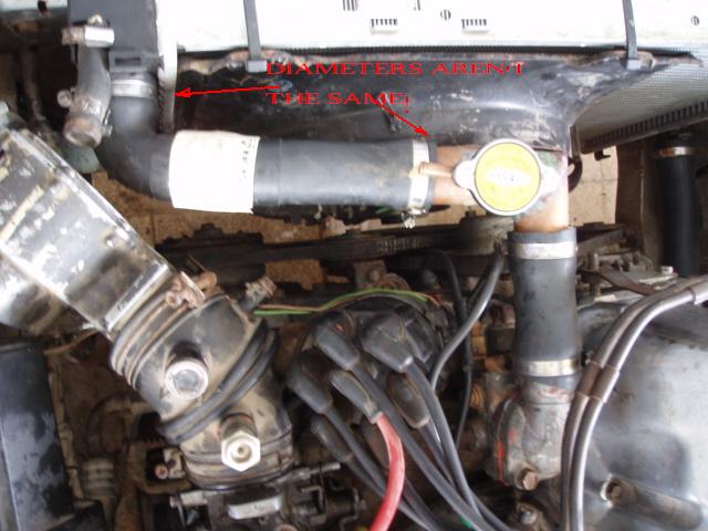

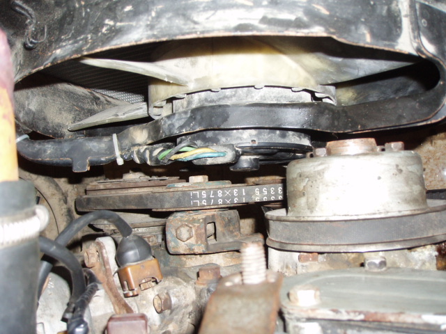

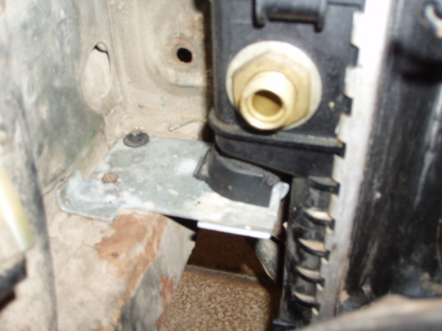

February 1, 200718 yr Author comment_197648 sorry for being so late, I was busy with the 4 U-JOINTS I distroyed in my 300ZX Z32:stupid: anywayz.. the combination is like this: -radiator of BMW325i 1988-1994 (they vary only with the transmission cooler at the side) -upper hose of 325i 1991 -lower hose of 535i 1990 -brackets of 525i 1988 (if I'm not mistaken') -strong plate to support the radiator's bushings seat for the left side ( I choosed left side to give space for the AFM and the condencer pipe.. ok let's start over.. pic #1: the first picture shows the overall result with some details (I hope they will be fine) pic. #2: in the second picture we see the top view of the upper hose, notice that the flange of the radiator is bigger than the L-Pipe and the thermostat flange.. pic. #3: the lower hose form the 535i. pic#4,5 and 6 show the lower seats of the radiator the left one is attached to a plate to reach the radiator from the body frame, it is just a plate wit holes to screw them with the body and a screw to hold the radiator's seat, while the right side the seat can be directly mounted on the frame with one screw (it will hurt when making holes in the frame):hurt: note that the 6th pic is from behind the alternator to show the right side mount through.. pic. #7 and 8 show the upper brackets from the 1990 BMW 525i the difference between the one that has bushing and without, they fit perfectly as if the were originals, the folding of the metal is exactly the same as it is in the BMW! pic. #9: the clearance between the 2 speed elec. fan and the pullies.. I'll get a nicer fan, I don't like this one. I'll make the second speed optional with the Temp sensor at 80C pic.#10: the secret path of the fans wire:) and I changed the Thermostat to 76C because the 82C was closing and opening too much, which caused unstability of the temp.. the radiator cools so much I guess:smoke: the 76C mainatained better because it opens faste which matches the heat exchange at the radiator.. we tried to make the fan stop and run depending on the Temp. but it didn't work because the sensor at the rariator gives different response than the Temp sensor of the dashboard gauge.. but I have to wait until summer comes so I will see the real ability of heat exchange at 54C!! this is the challenge with the A/C on! feel free to ask.. I'm here for you guys even if can't be here so much temporarely.. forgive my gramatical mistakes.. coz I'm in a bg hurry and I like to give the best help here.. wish me good luck in fixing/selling my Z32 to afford the price of a very clean 1977 280Z with centerline wheels!! I'm done from that car!! bye for now... Link to comment https://www.classiczcars.com/forums/topic/23121-transplanting-a-bmw-cross-flow-aluminum-radiator-in-my-280z/#findComment-197648 Share on other sites More sharing options...
