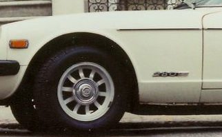

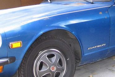

Agree with Mike. To me the lights don't even look different. See attachments. Possibly the area under the bumper differs, but the rubber on your larger 280 bumper will cover up any minor alteration (drilling) that might possibly be needed.
