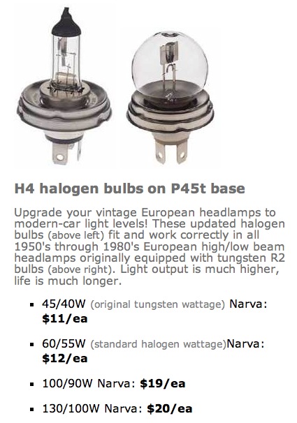

Thank you for all of your replies and info. If the Cibie lights could be located, can they be converted to accept H4 bulbs?

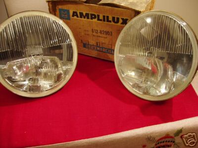

What I'd really like to find is a nice pair of Marchal Amplilux headlights. Each lamp used a pair of H1 bulbs, one for low beam and one for high beam. Each bulb had a separate reflector. Since the H4 bulb was not introduced until 1971, Ampliluxes were the high performance choice for 7" headlights for early Zs. I'd love to have a pair.
Yes, although the lens pattern is not at all optimized for H4 bulbs. The attached screenshot is from Daniel Stern Lighting.
They are the type that uses the H4's ... it's the reflector design and the glass that were the problem.. I do not know how much more wattage you could use with them other than the originals... don't know if the materials of the reflectors would hold up to high temp.'s
