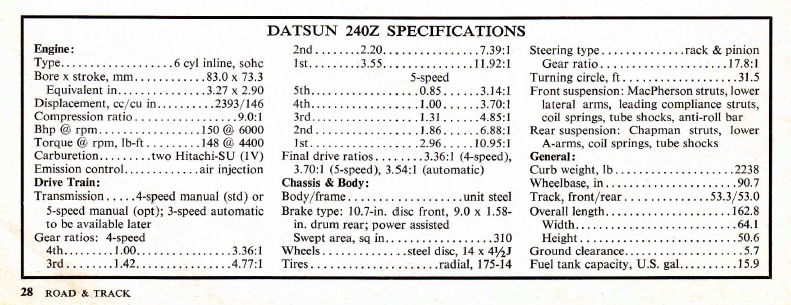

Hello...I have had my 1972 Z for 29 years and have always wanted a 5 speed trans. It now has a 4 speed. I have a friend that has a 5 speed from a 1982 280ZX . He says it will fit right in my Z but I'm not so sure. Does anyone know if it will bolt in ? I can also get the drive shaft if needed. Thanks in advance... Dave
