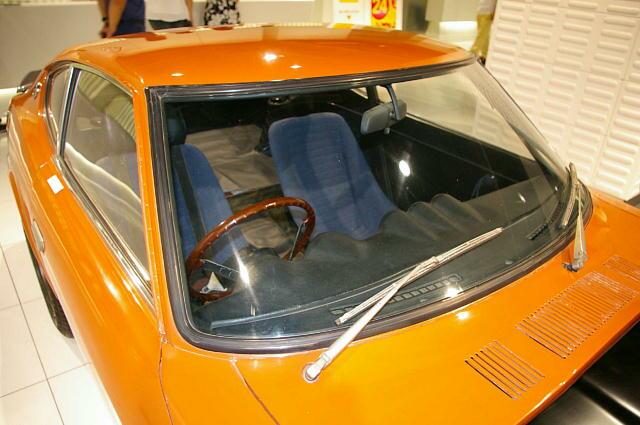

The black is from the 432 style becAuse it was made out of a light weight fiberglass, essentially trying get it to look this from a meseum in Japan

The 432 had a steel bonnet ( hood ). I think you are getting it confused with the 432-R, which had an FRP bonnet.
The car you pictured above is a genuine 432-R, and the pictures were taken at a temporary display on the ground floor of Nissan's main showroom in Ginza, Tokyo ( not a museum, unfortunately ).

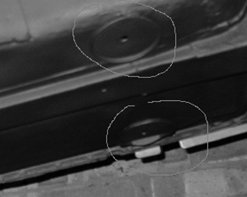

Have you got the attachment point strengtheners that were welded to the floor on cars that were equipped with the passenger footrest from the factory? Those are the most difficult bits to get in my experience ( for obvious reasons ).

You might want to try and replicate the original pieces, which had a lip on them ( for added strength I think ). The outside one had a distinct 'ear' on it to clear the sill seam.
Crap photo ( apologies ) attached below to illustrate:
