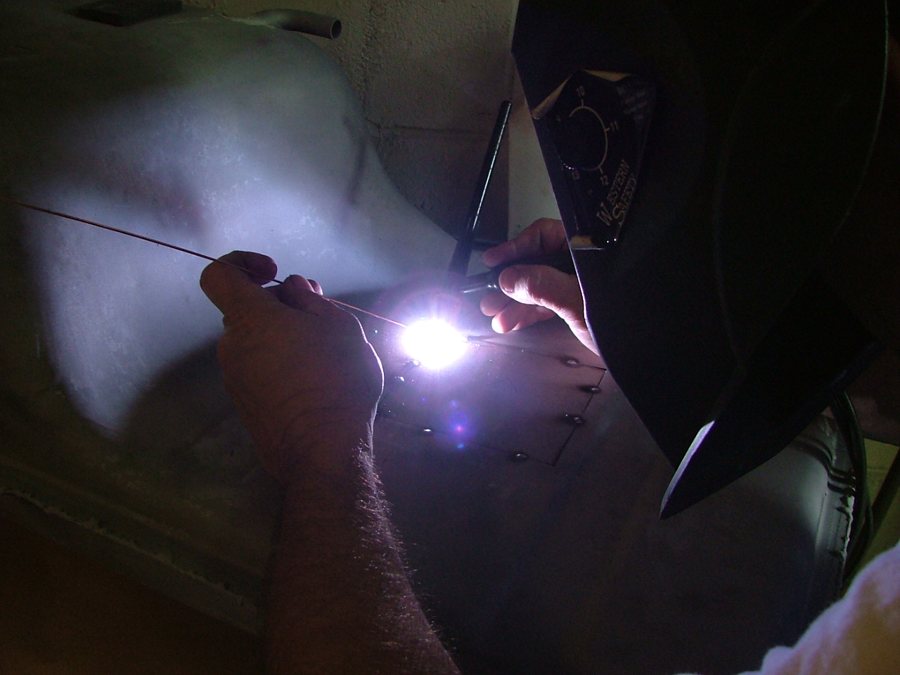

February 4, 200718 yr comment_198061 While taking machine shop I got some welding instruction at the Vo-Tech. I'm not certified but have had many cert weldors say I would pass easily. I own a 200A/MIG, 300A/ TIG, Oxyfuel set and plasma cutter. All of these came to bear on the Z at one point or another. TIG is too slow and filling holes with MIG is easier. Just use some .023 wire and Argon/Co2 with a decent MIG. Once knew a guy that TIG'ed all of his patches on a VW. Beautiful work, but the concours judges spotted some areas which had weld beads near the engine. (Points off for that) This was a shame because his patchwork was meticulous otherwise. For autobody MIG seems to be best to me. Distortion is less with MIG unless you go to great pains to keep the heat down with TIG. (Using a .020 tungsten for instance) Fitup and cleanliness is more critical with TIG than MIG. To me, using a foot pedal beats the crap out of a silly torch mounted switch. Such a switch is almost a must when TIG'n parts on the car. It is possible to TIG and end up with a weld that is perfectly flat on the front and back sides. There was need to cut an access hole for sandblasting in the top of my tank. (Picture below) Something critical like this could be MIG'ed but since it is a life threatening thing to have a gas leak I chose TIG. Link to comment https://www.classiczcars.com/forums/topic/23170-mig-or-tig/#findComment-198061 Share on other sites More sharing options...
