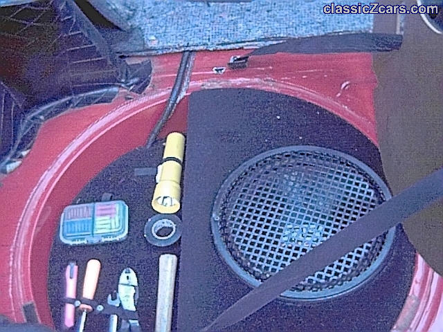

February 6, 200718 yr comment_198332 I own a 70' and it too only came with 1 speaker on the left rear quarter. So I took the speaker plate and duplicated it in reverse using 1/8" ABS plastic. I did this because I did'nt want to put holes in the plastic interior peice.I then used "Slim" style pioneer 5 1/2" 2-way speakers. With the exception that they are aimed at each other, they sound pretty good. But me being me, I went ahead and put 4" kicker A400 2-ways in the doors. The P.O. had already cut small holes in the door panel so I figured it could'nt hurt to fill the holes.I also made a fiberglass enclosure in the wheel well for a 12" MTX subwoofer. It only fills the well 2/3 of the way, which left room for a 200 watt sub-amp to sit next to the box in the wheel well.I obviosly had to run all new speaker, power and RCA wires but I used stock locations and wrapped them to look like a stock harness. I also ran a pin switch wire for the alarm and new power antenna power wires.But after all this, you only see the door speakers and pioneer CD player, which also has XM Satelite Radio (tucked under the dash) and I'll be putting in a 4 channel amp behind the seat where the car jack used to go. Then I'll make a cover for it that will resemble the old style jack cover. I'll most likely use 1/16" ABS for that. Link to comment https://www.classiczcars.com/forums/topic/23172-240z-audio-system/?&page=2#findComment-198332 Share on other sites More sharing options...

February 6, 200718 yr comment_198348 Dave (Zs-ondabrain), So am I correct that you travel without a spare tire? Which is also why you travel without a jack? I like the idea of the hidden sub but don't like the idea of no spare... I do too many distance trips for that to be an option. I remember some time ago that Pioneer had subs that mounted inside the rim of a spare tire. Hmmm maybe I'll just stick to the idea of building an MSA style box for an 8" and two 5.25"s or just two 6" woofers.Red Dog... Have you come up with a firm idea/plan yet? I'll be interested in seeing your approach... Link to comment https://www.classiczcars.com/forums/topic/23172-240z-audio-system/?&page=2#findComment-198348 Share on other sites More sharing options...

February 7, 200718 yr comment_198389 Dave (Zs-ondabrain), So am I correct that you travel without a spare tire? Which is also why you travel without a jack? I like the idea of the hidden sub but don't like the idea of no spare... I do too many distance trips for that to be an option. I remember some time ago that Pioneer had subs that mounted inside the rim of a spare tire. Hmmm maybe I'll just stick to the idea of building an MSA style box for an 8" and two 5.25"s or just two 6" woofers. YUP! Thank god for AAA and my best friend who drives a tow truck. I always keep up on all my maintenance (both tires and motor). I usually only drive within a 30 mile radius and if I'll be traveling any farther than that, I carry a spare. I'm nuts, but not totally stupid :stupid: You were right about Pioneer making a "Spare Tire Sub" I'm not sure if they still make it but it was a great idea at the time. My wheel well sub enclosure only takes up 2/3 of the wheel, I'm also going to move the amp that sits next to the sub in the wheel well to the area behind the passenger side seat. Which will free up room for a small jack, and other tire repair stuff. Not to mention flares, flags, oil, spare plugs, rags, wire repair items and fuses. And I ALWAYS carry a small tool bag that has every metric wrench and socket neccesary to probably tear the whole car apart with. ALWAYS!! Link to comment https://www.classiczcars.com/forums/topic/23172-240z-audio-system/?&page=2#findComment-198389 Share on other sites More sharing options...
