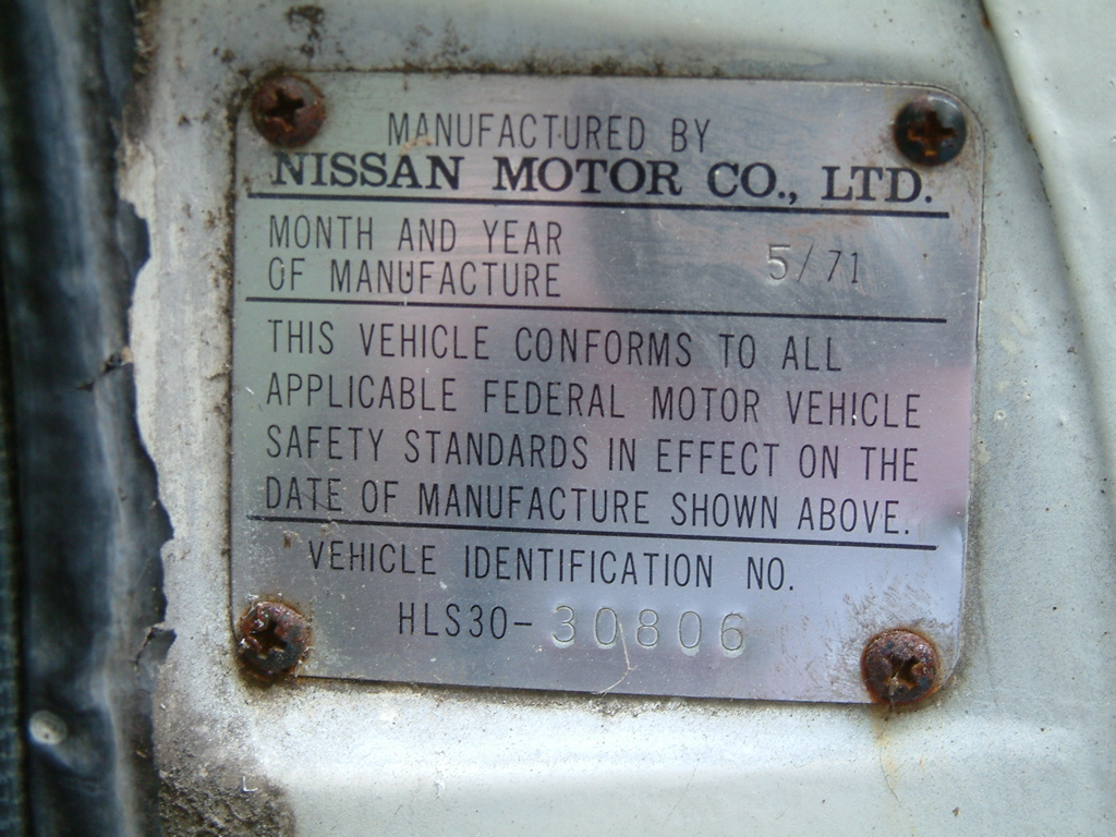

February 13, 200718 yr comment_199097 Also - does anyone have photos of their ID plates you are willing to share so I can use them as examples for engravers to copy (with my numbers of course)? Here is a shot of my jamb plate.... Link to comment https://www.classiczcars.com/forums/topic/23262-adhering-vin-plate-and-engine-id-plate/#findComment-199097 Share on other sites More sharing options...
February 13, 200718 yr comment_199108 Yes, they are available at just about any hardware store that carries rivets. And as you can see from "BRE-240Z"s picture, Aluminum rivets are the better way to go. The original screws rust and the rivets are flatter and look alot cleaner.I don't know of any one who'll redicule or judge you for using rivets rather than the original rust ready screws.Good luck with the Z,Dave. Link to comment https://www.classiczcars.com/forums/topic/23262-adhering-vin-plate-and-engine-id-plate/#findComment-199108 Share on other sites More sharing options...
