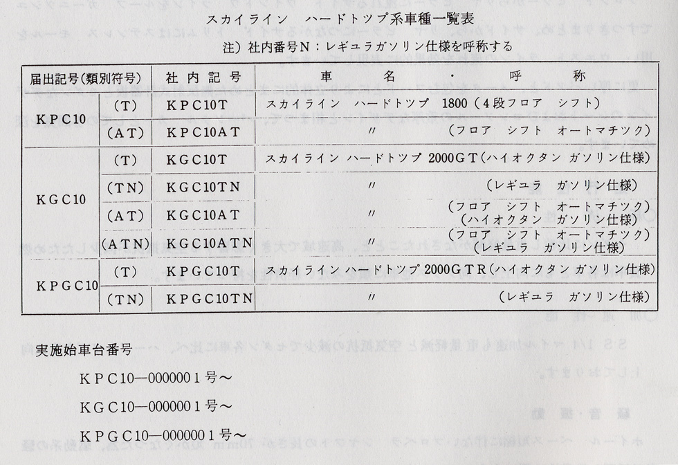

March 27, 200718 yr comment_203776 Aside from going red, spluttering some unprintable expletives and very pointed remarks about smartasses who hadn't climbed out of short pants when these cars were being built, he was actually very interested. Well, if one of these "smartasses" got something wrong I invite you to correct it on this thread. Here's your opportunity to put down some good information to be brought up in future by users of the SEARCH function. But be careful, as you might get somebody labelling you a "smartass" too.......... Nissan actually had three seperate 'lines' for C110 cars, one for K code hardtops, one for sedans and a completely seperate 'line' for GT-R's.Export market cars were actually built on the same 'line' as domestic cars in batch runs. So, all K codes received sequential numbers, all sedans a seperate sequential number series and the GT-R had its own series. Hold on, I think it was a little bit more complicated than that. This talk of "lines" is a little misleading, and I don't see what the number of "lines" had to do with the number of body serial number sequences ( ?? ). As mentioned before, each distinct prefix type had its own body serial number sequence. Are you saying that - for example - the KC110, KPC110 and KGC110 models all shared a body serial number sequence ( "So, all K codes received sequential numbers......" )? I'm sorry, but I do not think for one minute that this is correct. Perhaps you misunderstood? The production figures and body serial number sequences published by the Japanese motor vehicle ministry show that it is not the case. The main point is that a GT-R was effectively an individually handbuilt car. The likelyhood of a GT-R receiving such a high serial number as this exanple carries and that number being recorded on the Car Identification Plate or stamped into the firewall is virtually non-existant. That we can agree on. But it is not news is it? The PGC10, KPGC10 and KPGC110 models are such a specialised and well documented subject that the body serial number sequences are common knowledge amongst enthusiasts. You are only 'confirming' a fact that you were effectively disagreeing with earlier in this thread. Something he also pointed out as being a complete misrepresentation of the facts was the use of the term VIN or 'Vehicle Identification Number' in association with cars of that era.I have since been able to obtain the exact wording used by Nissan at the time (direct from Nissan) and I quote: "IDENTIFICATION NUMBERS The car and unit numbers are stamped and registered at the factory. The car and engine identification numbers are used on legal documents. These numbers are used for factory communication such as Technical Report, Warranty Claim, Service Journal and other information. CAR IDENTIFICATION PLATE The plate contains the car type, engine capacity, maximum horsepower, wheelbase and engine and car serial numbers." A true VIN actually identifies a lot more and is a whole different and messy ball of string. , That's all straight from the C110 series export model factory service manual! Have you only just noticed it? Some of us are very well aware that the term "VIN" ( Vehicle Identification Number ) is a more modern term, and that the 'VIN' on modern cars contains far more information than that seen on the cars of the period we are discussing here. But the reason we use the term 'VIN' is just for convenience sake ( so that everyone knows what we are talking about ). You only have to turn to the first few pages of a factory service manual to see the 'Model Variation' list, and the meanings of the prefixes and suffixes. The fact that the suffixes hold a lot of information on the model variant, and yet were never attached to the car, is unfortunately seldom acknowledged on forums like this. If I start using the real terms that Nissan ( a Japanese company! ) used in the period, namely 'Katashiki' and "Shadai Bango", wouldn't that just confuse you a little more, and give you even more reason to label me a "smartass"? That's why we use the colloquial vernacular of 'VIN' etc. Nissan did also confirm that there was another P engine code used on C110 cars - for the G18 engine of all things! Further, they stated that engine would not have been used in a K code chassis anyway as there was never a short wheelbase K code. So there were TWO P code engines! I'm tempted to welcome you once again to the 'Model Variation' page of the C110 export model factory service manual ( welcome! ) as you don't appear to have noticed it before. Heaven only knows what kind of euphoric epiphany you will experience should you see the Japanese home market model variation page. Maybe you ought to sit down before looking at it? .......and a PGC110 a GT-R sedan with an S20 (if they ever built any). No, I don't believe they ever built any. Unless you know better? And someone wants to imply that the factory only ever did sensible things?? I think it is well known that the factory ( factories ) occasionally did things we find difficult to get our heads around, but we are standing on the outside and we - essentially - have no God-given right to all of the information that might make things a little clearer. We are often reduced to the level of archaeologists trying to decipher the Rosetta Stone. That's just the way it is. Personally I find it fascinating. The weakest links in the chain ( the ones that are often seen to be the least 'sensible' ) are ourselves - the amateur enthusiasts. Alan T. Link to comment https://www.classiczcars.com/forums/topic/23270-unusual-kenmeri-qld/?&page=4#findComment-203776 Share on other sites More sharing options...
March 27, 200718 yr comment_203785 Nissan did also confirm that there was another P engine code used on C110 cars - for the G18 engine of all things! Further, they stated that engine would not have been used in a K code chassis anyway as there was never a short wheelbase K code. Apart from the 'KPC110' of course. Maybe you should ask your source at Nissan about that, as they would seem to have forgotten it? The existence of this model would also appear to blow your following statement out of the water: So, all K codes received sequential numbers.............. See chart of K-prefix C10 model types below. Not C110 series admittedly ( I don't have the C110 chart to hand, but somebody else participating in this thread does - so hopefully they will pipe up ) but it does at least illustrate the fact that the KPC10 and KGC10 ( and the KPGC10 - but we already knew that ) had their own different body serial number sequences. The C110 series followed suit, I'm sure. Alan T. Link to comment https://www.classiczcars.com/forums/topic/23270-unusual-kenmeri-qld/?&page=4#findComment-203785 Share on other sites More sharing options...
