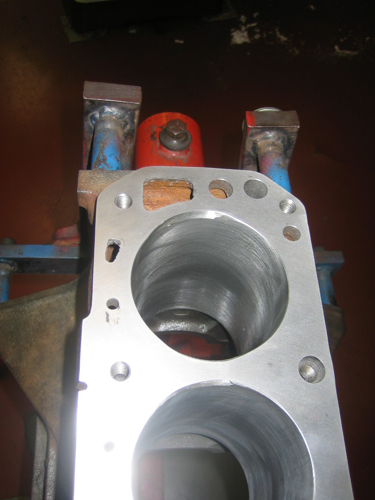

Posted February 15, 200718 yr comment_199431 Well it looks like I need a complete head rebuilt. I was wondering about putting larger valves in my E88. I have heard that this is a great way to increase flow. I am running a L24 engine. Do you run into the same problems as with an N42 head on an L24. That is, will I have to notch the block to make it fit? Any input would be appreciated.Thanks,Adam Link to comment https://www.classiczcars.com/forums/topic/23293-large-valves-in-an-e88/ Share on other sites More sharing options...
February 16, 200718 yr comment_199434 Yup. Doesn't matter which head casting, if you have big valves you'll need to notch the block, unless your block is already bored oversize. Link to comment https://www.classiczcars.com/forums/topic/23293-large-valves-in-an-e88/#findComment-199434 Share on other sites More sharing options...
February 16, 200718 yr comment_199438 Like this? Link to comment https://www.classiczcars.com/forums/topic/23293-large-valves-in-an-e88/#findComment-199438 Share on other sites More sharing options...
