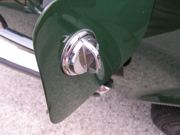

I attached two pictures,the one green is the earliest knob sits north/south when it is closed.I took this picture in the convention last year,the car belongs to Mrs.Anne HLS30-00346.I guess this knob is only for 1969 240Z and Z432R or very early 1970.Part number should be -E4600.
26th-Z said this looks plastic made.

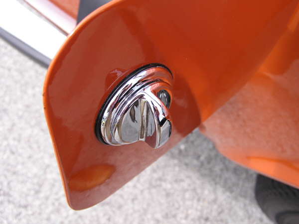

The one orange is later type,sits east/west when it is closed.Also this shot was taken in that convention,the car belongs to Mr.Dan Banks his car is 1971 Z.This knob is familier for us.We always see this knob in the 1970 to early 1971.Anyway I am not sure this is -E4601 or -E4602.Looks different from the green one,you can tell the green one is simple,but this one is little bit fat and metal.
My understanding is,the earliest is -E4600 and sits north/south with simple finish.

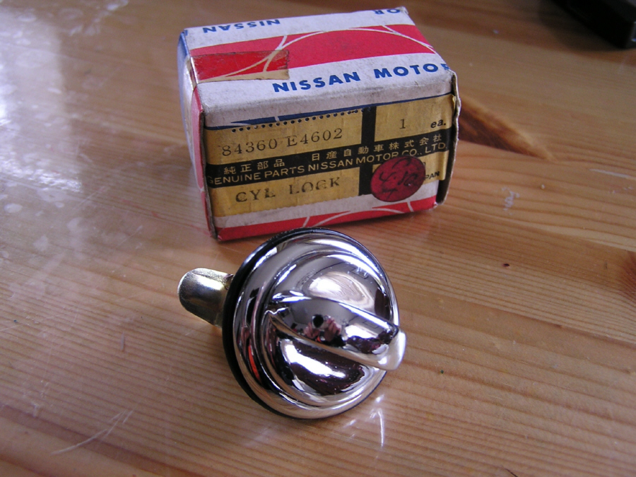

-E4602 is now on ebay,I bought the one from the seller and that is very very fantastic one.
