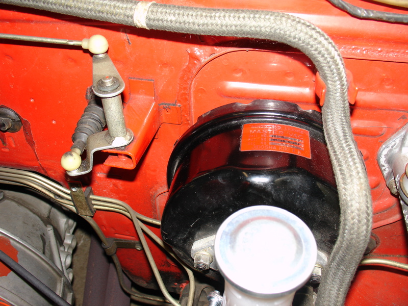

I don't have any good leads on the "correct" finish for the booster. Humble's book and the FSM are not much help. I had been using Eastwood Products for the black components, and to me it looks like a higher gloss than the Chassis Black which is a 60-75% gloss, and definitely glossier than Underhood Black (10-20% gloss). So I ultimately went with an 85% Gloss Black. Not sure if it's right. Here are some pics so you can make a better evaluation/informed decision...
Sorry if the detail's bad. I can try to get some better pics, but getting a good photo of something black can be tough.
Thanks and good luck!
Steve
Thanks xray,
That looks like pretty much the same finish that was left on the original unit. Was the sticker in that nice condition or did you get a replacment somwhere? Mine is mostly shot.

I have a new NOS booster still in the box from Nissan, for reference, that is not high gloss. It is slightly less than high gloss. I would gauge it to be about 90%. If you were to apply polish to this booster it would bring the luster to a full gloss look. So I hope this gives you some reference. If you are spraying it try to avoid making the final coat a wet one. By putting it on a little drier it will keep the gloss down. I hope this helps. I would take a pic of the booster I have but I am afraid the flash will distort it but if you need on let me know and I will try.
Bob
I'll second that - the booster in my low-miles red 240Z is more of a semi-gloss or satin finish. It is very smooth, but not high-gloss. I've painted a few parts with some Satin Black from Griot's garage that is very close.

Best I could do. Took several shots at varying exposures to try to capture it. But note the reflection of the red firewall and hoses. Glossy enough for there to be a reflection, but not glossy enough for the reflection to be sharp.
