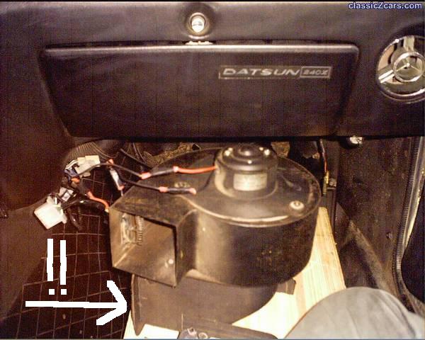

March 7, 200718 yr comment_201469 May I suggest when you pull the blower housing out that you replace the seal on the square flange that mates to the underside of the cowl box. See white arrow on attached picture. Chris A. Link to comment https://www.classiczcars.com/forums/topic/23501-changing-out-heater-core-in-1971-240z/#findComment-201469 Share on other sites More sharing options...
