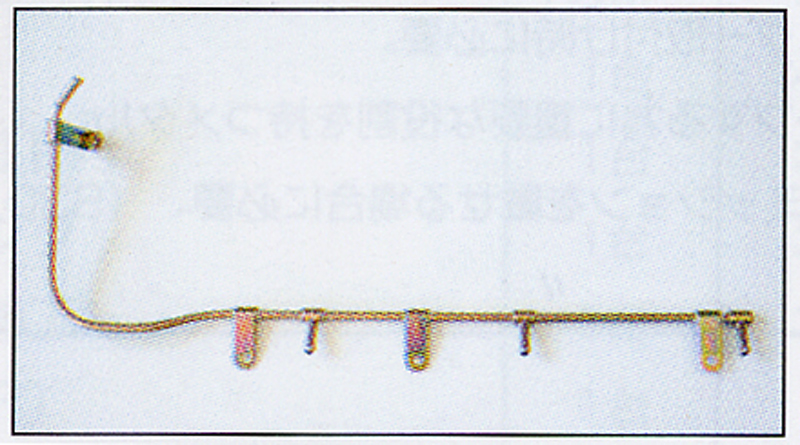

Mike,
The original Nissan triple-outlet hard fuel line is still available in Japan - the same one as they used to sell with the triple carb kits. Last time I looked the retail price was around 4,500 JPY or so.

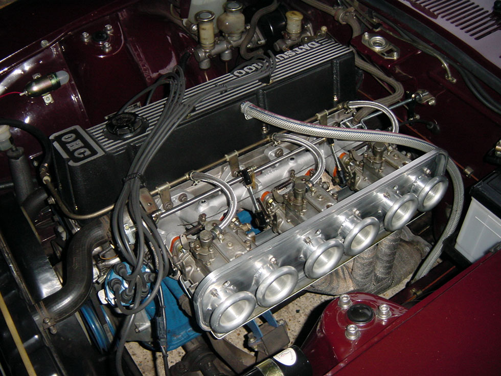

I think it is a neat, effective and unobtrusive solution. I use one on one of my cars ( apologies for the crap photo ):
Alan - nice simple design. I just took the OEM SU fuel rail, cut off what I didn't need and added 3/8 lines (in and return) and then covered those with velcroed silver insulation from the same compnay that does header wrap and spark plug covers. This not only hides the aluminum lines but helps with heat raising off the header. I tried the stock fuel rail but it restricted the flow too much, so I just ended up running a new 3/8 line all the way from the tank (put in new 3/8 line there too). I liked being able to use the original mounting points.
I slit the insulation at each carb for the inlet line and made a loop at the end to bring it back to the gas tank.
My impression of the stock fuel rail is that it gets at least some if not most of it's heat from being bolted to the head. I only had vapor lock problems on one single day with my SU's, but after looking at it my solution was to eliminate the stock rail and get rid of the stock fuel pump. I never had vapor lock again. Basically what I'm saying is I'd avoid any metal line that bolts to the head.
