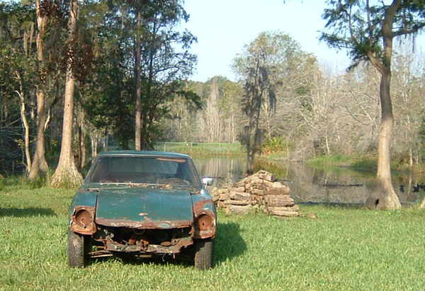

March 9, 200718 yr comment_201629 Does the princess still look like that, Chris? Or is she disassembled? Link to comment https://www.classiczcars.com/forums/topic/23527-looking-to-buy-but-first/#findComment-201629 Share on other sites More sharing options...

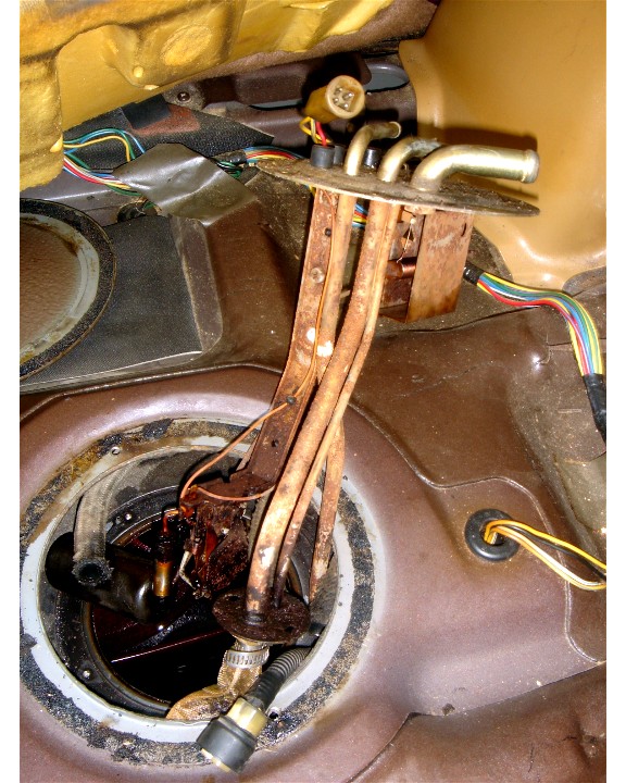

March 9, 200718 yr comment_201641 Don't forget to check under the floor pans too. I ended up getting a spot there, and it looks like someone tried to fix it unsuccessfully, but I might be able to fix it without having to get an entire new floor pan. Also I hear the gas tanks are supposed to get pretty rusty on the inside, so either a good cleaning or a new one would be in order. Other then what the others have said, I can't really think of anything else myself. Recently bought a 240z myself, a California car its whole life, and I would have to say is in excellent condition. Though still needs a lot of money put into it. Link to comment https://www.classiczcars.com/forums/topic/23527-looking-to-buy-but-first/#findComment-201641 Share on other sites More sharing options...

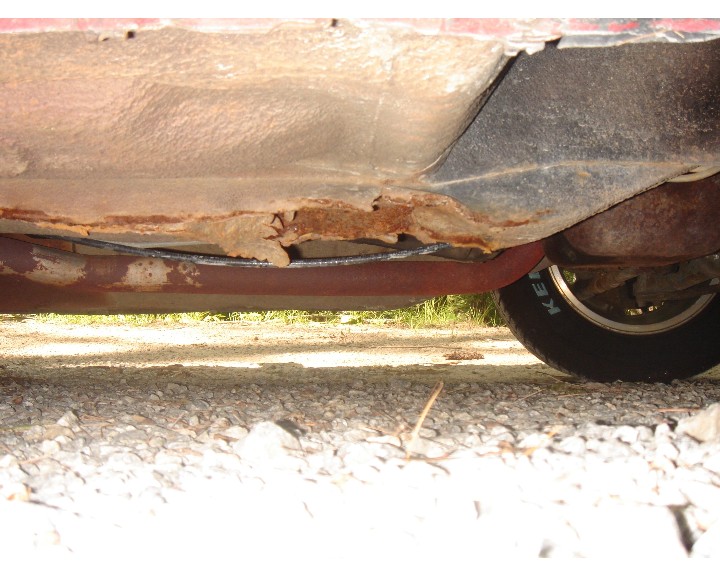

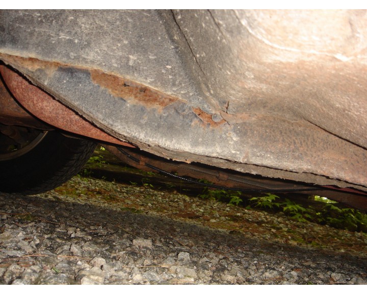

March 9, 200718 yr comment_201650 There's no reason to go for a slow build of a Turbo engine, they can still be found in junkyards (and some of our members have some for sale in the classifieds, for that matter). Frame rails have been mentioned, but here are a couple shots to show how bad they can be, and a shot of my rusty fuel sending unit, straight out of the tank. (yours will be different, if you find an earlier model-this is just for example). Welcome to the club, take your time when buying, and enjoy the ride. Link to comment https://www.classiczcars.com/forums/topic/23527-looking-to-buy-but-first/#findComment-201650 Share on other sites More sharing options...
