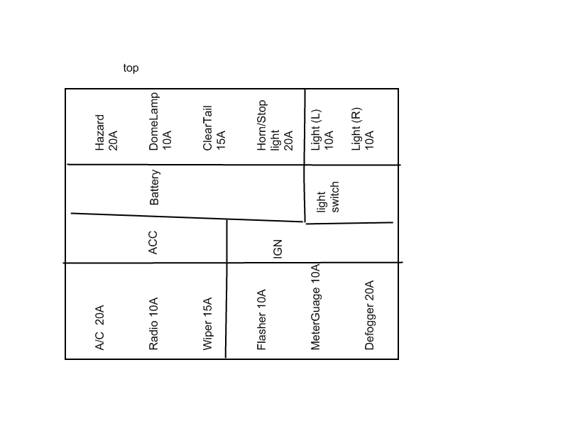

Posted March 10, 200718 yr comment_201739 I just got an S130 for a great price, but it was missing the fuse box cover and has a couple of blown fuses and a short somewhere. I know this isn't the right site, but I figured someone here has an S130 also. Can somebody please post or send me a picture of a legible fuse box cover so that I can start to track down my problem.Thanks in advance.ScottBy the way, it's a 1980. Thanks again. Link to comment https://www.classiczcars.com/forums/topic/23541-help-with-my-new-s130/ Share on other sites More sharing options...

March 10, 200718 yr comment_201748 I've got a '79, I would imagine that the fusebox is the same. If not, I am sure someone will chime in and provide the correct info. Congrats on the ZX purchase-I'm sure you'll enjoy yourself. Link to comment https://www.classiczcars.com/forums/topic/23541-help-with-my-new-s130/#findComment-201748 Share on other sites More sharing options...
