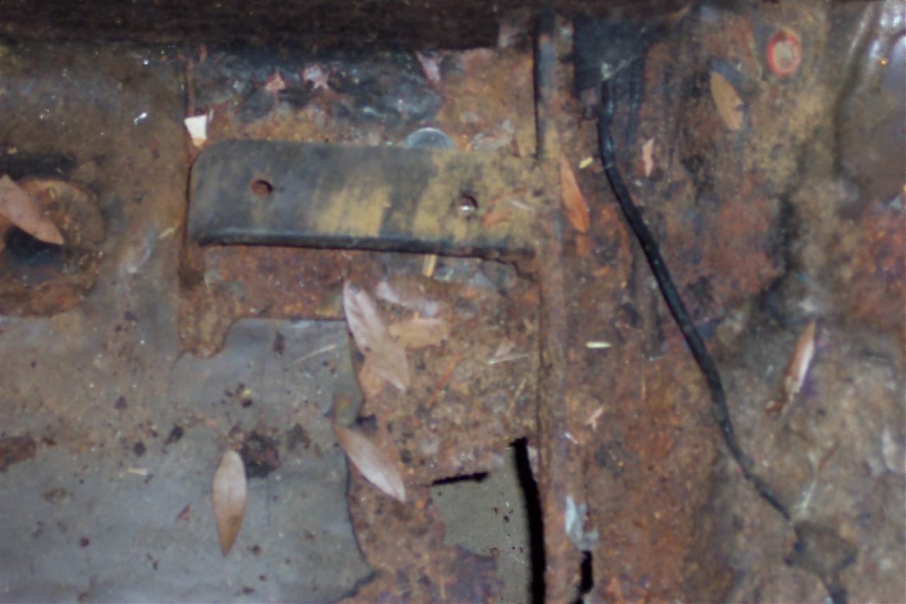

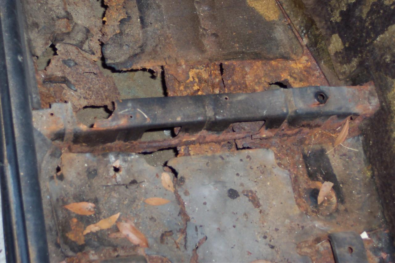

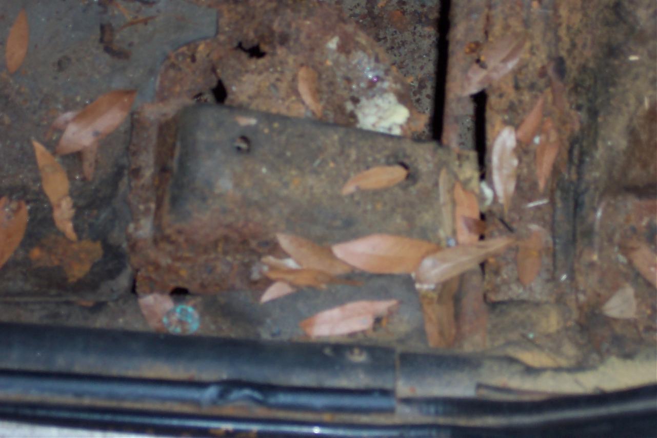

I have finally gotten around to fixing the floor pans in my 72 240Z. After pulling the seats, etc. I couldn't believe just how bad bad was. So now I need some help. I had planned on getting the replacement floor pans for Charlie Osborne at Zedd Findings. I looked at these floor pans and I released that they don't have the cross piece for the front seat mountin points and they don't seem to have the back seat mounting points. So I guess what I am asking is for any comments you may have on replacing floor pans, where did you get the pans and what leasons learned you could share with me.

Yikes, Jimmy! You're right those are in bad shape. I've never seen new mounting pieces sold separately before; in most cases, the old ones are reused then welded on the new floor pans. I would check some junkyards and see if they can cut some mounting brackets out of a Z for you. The Zedd Findings floor pans are the best ones available out there (also available from Motorsport).

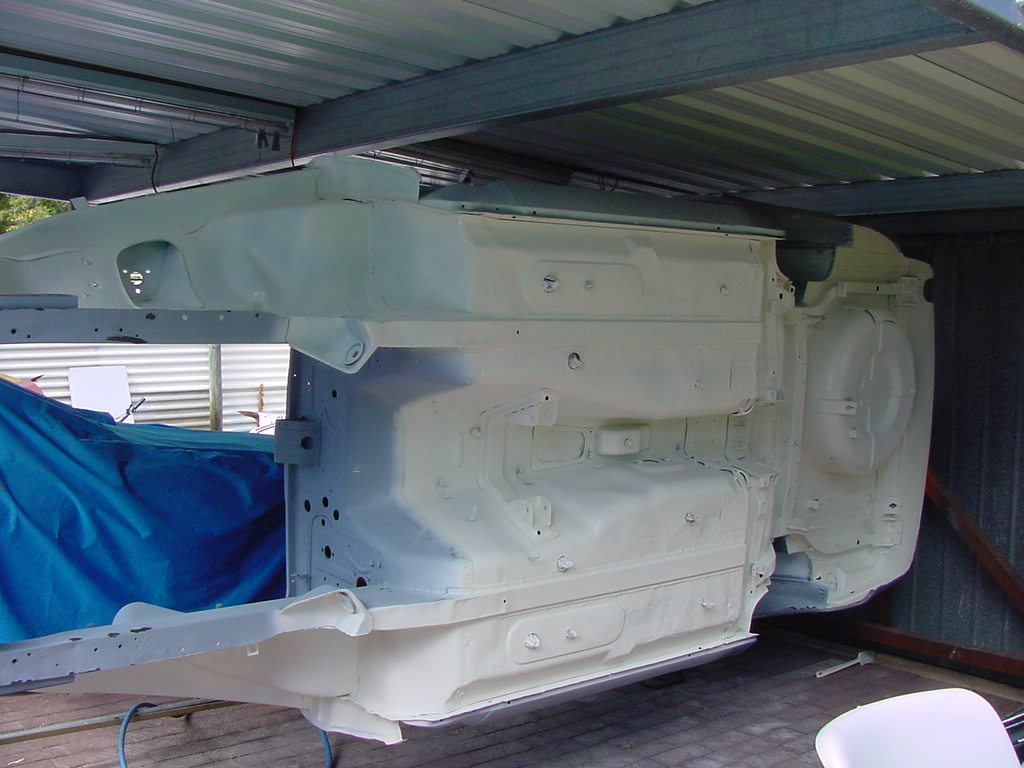

When you fit the new floormetal, modify the re-inforcing channel that is welded beneath the floor.
I had some new 2mm thick channels folded up by a local sheet metal shop that extended full length to the rear of the floor pan, not 1/2 way like the 240Z stockers do.
These add quite markedly to the rigidity of the floor and can be enclosed or left open ended.
It wasn't until sometime later that a friend of mine remarked that the 260Z channels were the same design.
I didn't know this at the time but I guess I was on the same wavelength as Nissan re the problem :)
