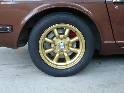

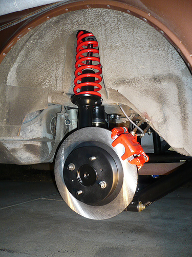

April 7, 200915 yr comment_280042 Yes, the Modern Motorsports rear disc conversion will not work with 14 inch rims and you need at least 15's. I believe that is the case with many of the others too. It is worth it though IMHO. I did the MM setup on the rear on my '72 and am still running stock on the front and it is light years better than stock. Link to comment https://www.classiczcars.com/forums/topic/23567-240z-rear-disc-conversion/?&page=2#findComment-280042 Share on other sites More sharing options...
April 7, 200915 yr comment_280049 I had my stock 14" shelby 500 rims on and the brakes are fine Link to comment https://www.classiczcars.com/forums/topic/23567-240z-rear-disc-conversion/?&page=2#findComment-280049 Share on other sites More sharing options...
April 7, 200915 yr comment_280088 Yes, the Modern Motorsports rear disc conversion will not work with 14 inch rims and you need at least 15's. I believe that is the case with many of the others too. It is worth it though IMHO. I did the MM setup on the rear on my '72 and am still running stock on the front and it is light years better than stock. And it's purty too! Here's a shot with 15" Konig rewinds. Link to comment https://www.classiczcars.com/forums/topic/23567-240z-rear-disc-conversion/?&page=2#findComment-280088 Share on other sites More sharing options...
