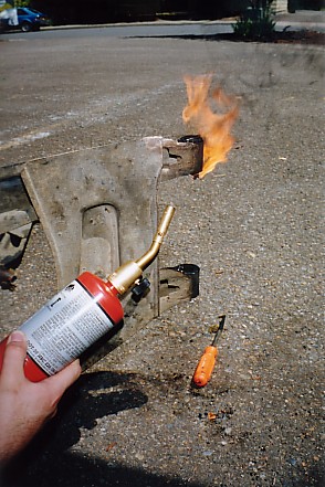

Back in the day, (can't believe I just said that) I took a few pictures of my rear suspension project.

So, I burned out the rubber..... NASTY NASTY NASTY. (I like the other version of NASTY much better) This is for the dogs and really doesn't get me goin.

I found a really good way to remove the bushing (front or back) quickly with simple tools and minimal heartache (once you get the control arm free of course). You need a propane torch like Mike's using, vicegrips, a drill with a 1" paddle bit, a hacksaw and screwdrivers and mallet.
1. Heat the rubber for a few minutes.
2. Attach the vicegrips to the metal bushing inner sleeve. As the rubber softens while being heated start to use the vicegrip as a fulcrum and you physically pull the inner sleeve right out of the rubber. The vicegrip may come free a few times and you'll mutilate the inner sleeve, but who cares (that is, so long as you

pic 1 is stock bushing not yet removed. Then vicegrips to pull out inner sleeve. Drilling out rubber after sleeve removed. Outer sleeve cleaned up way beter than need be as at the time I thought I was done but then realized this outer sleeve still needed to be hacksawed out. Live and learn.
I tried toasting the rubber too. I got rid of most of it but what was left was REALLY stuck to the metal. I ended up filing/sandblasting the rest off. Sandblasting didn't work very well though - I guess the sand sorta bounces off the rubber. But if you file it down close to the metal it works.
When you heat up the inner sleeve, if you do it from below and to the inside of the sleeve itself it does a really good job of softening the rubber, which is what you want so you can lever the sleeve out with the vicegrips. After the inner sleeve is out, drilling with the paddle bid takes no time at all and the picture you see with the polished interior of the outer sleeve was with the drill bit. You can tip the bit sideways and clean the rubber right off.
I tried burning the rubber out too and the propane torch isn't really hot enough plus it takes a long time and smells really, really bad. The techinque I came up with is fast and there is a minimal burning of rubber so it doesn't gas you out.
