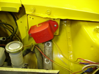

Posted March 28, 200717 yr comment_203881 this 77 I been working on has a Msd 6AL system, can anyone tell me about it, it is limited to 6000 rpm, I want to change that, HOW!!! Also does this replace the ignition module or what is the real purpose. attached is a picture of a part of it what is it !! Thanks Think the mod# is 6420 Link to comment https://www.classiczcars.com/forums/topic/23753-msd-6al-s/ Share on other sites More sharing options...

March 28, 200717 yr comment_203915 That looks like an adapter for your tachometer. Sometime necessary when installing MSD-6. Link to comment https://www.classiczcars.com/forums/topic/23753-msd-6al-s/#findComment-203915 Share on other sites More sharing options...
March 28, 200717 yr comment_203917 Yep, some tachs and injector systems won't recognize the trigger signal and need this adapter to convert it to be recognized... looks sorta like this one.http://www.msdignition.com/pdf/8910_21247.pdfhttp://cgi.ebay.com/ebaymotors/MSD-8910-Tach-Fuel-Adapter-for-Pre-1989-Honda-SCI_W0QQcmdZViewItemQQcategoryZ33691QQihZ020QQitemZ300075316223QQtcZphotoThe adapter unit is used with the MSD-6AL box. Link to comment https://www.classiczcars.com/forums/topic/23753-msd-6al-s/#findComment-203917 Share on other sites More sharing options...

March 28, 200717 yr comment_203943 You can download the manual for it from the MSD website. It doesn't say much about the rev limiter that hadn't already been said. It's just as simple as replacing the module the the RPM limit you want. The item you pictured in your first post is actually the Tach Adapter needed to get many older tachs to work with the MSD ignition in place, but I'm assuming you know that by now.Here's a link to the manual:http://www.msdignition.com/pdf/6%20series/6series.pdf Link to comment https://www.classiczcars.com/forums/topic/23753-msd-6al-s/#findComment-203943 Share on other sites More sharing options...
