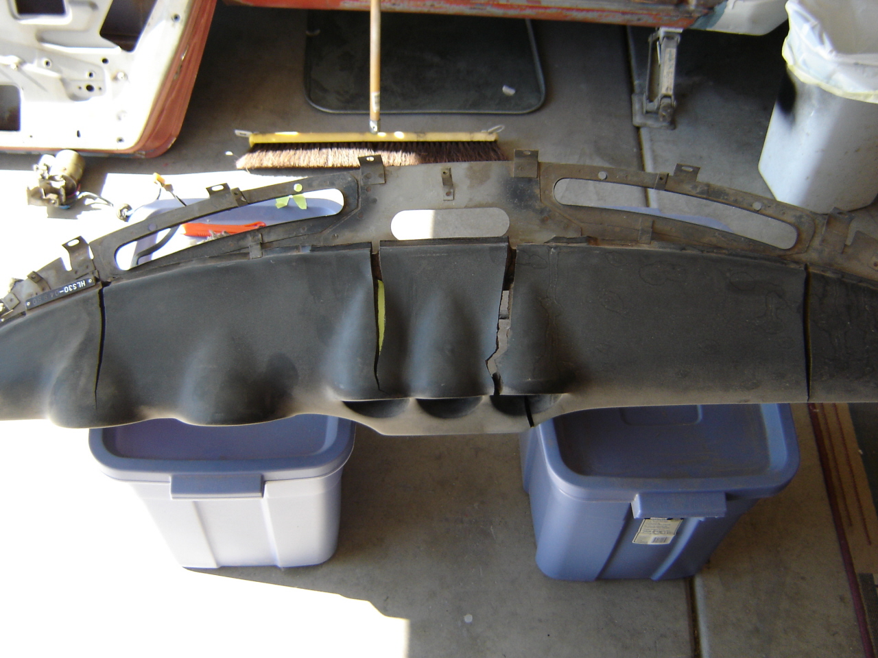

I bought a full dash cap from VB/BD for the 280 and it fit really well. The dash had minor hair-line cracks.
I bought another cap from VB/BD for the 240 and it didn't fit at all. It was so far off that I thought it would never fit correctly no matter how much I trimmed it so I decided to repair my dash. The 240's dash had MAJOR cracks, (picture).
Since we're buying these caps to cover cracked dashes, it's likely the dash has moved (dimensionally). It's possible that some caps will never fit as well as we'd like it to.
VB, MSA, Too Intense and others may be getting their caps from the same dash cap manufacturer. It's also possible you got the wrong year dash cap.
Bruce
