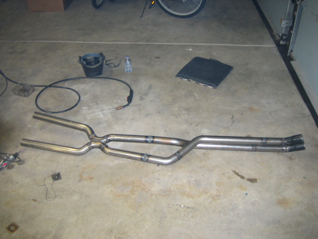

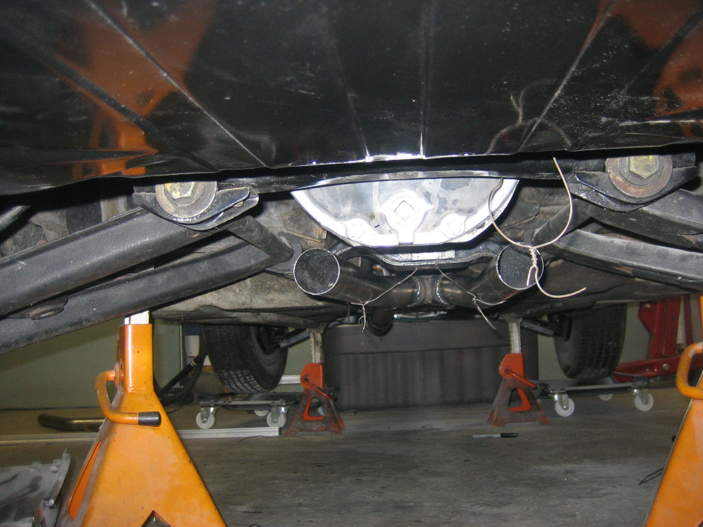

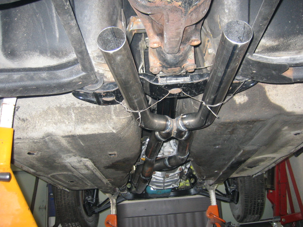

Well it's not done yet ,but the hard part is done ,I hope. I need to make a final decision on mufflers or just glasspacks.And the decision on tips-that's going to be tough. I can't wait to hear it run.

I plan on putting a flange on the mufflers right now ,but still thinking about that. As it is, the whole set up just slides off the header in one piece.I would hope that after disconnecting my mufflers i will be able to drop the exhaust down in a complete assembly since the pipes do not run over anything.
Nice job! Maybe a flange coming off the header pipes would be a good idea. They won't just slide off that easily after a while, especially if they are clamped. You could still drop it in one piece easy enough since you have good support at the halfway point, at the X-crossover. For transmission removal you would be able to undo it at the flange and swing it over and out of the way enough without dropping it completely. Keep us posted on how you finish it up.
