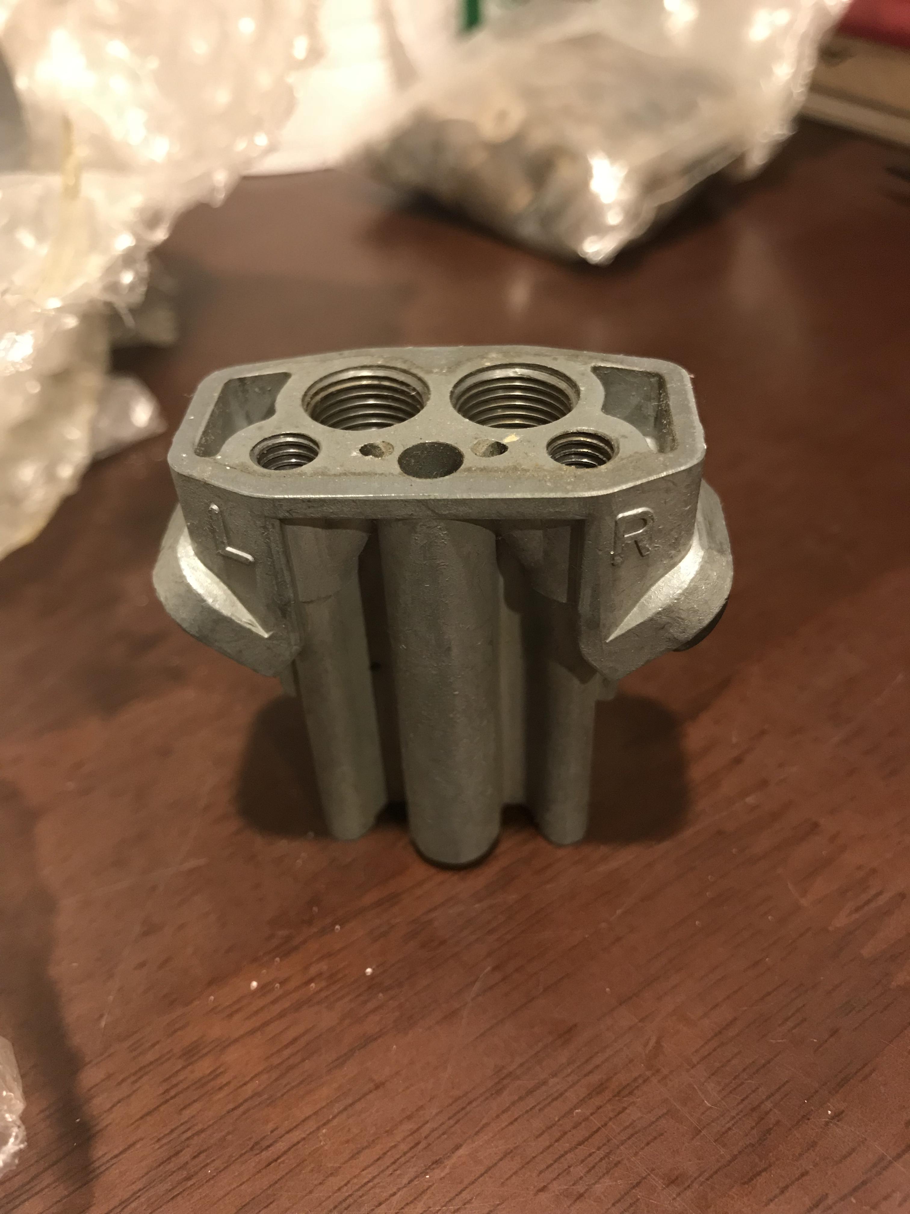

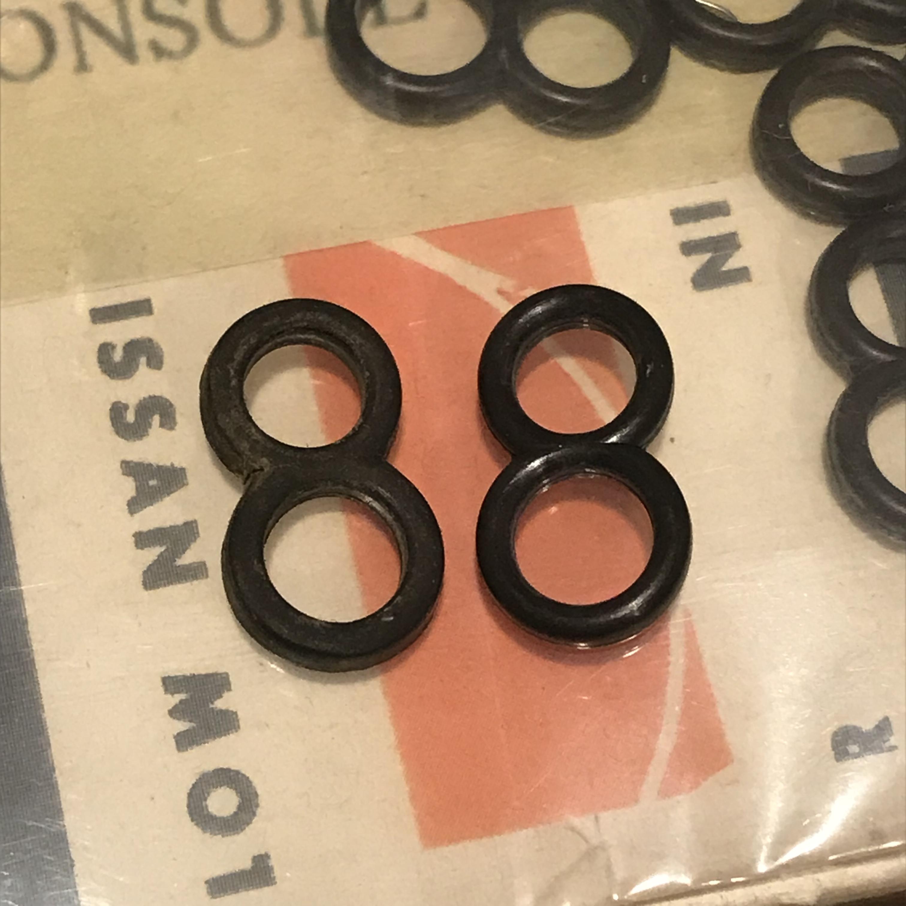

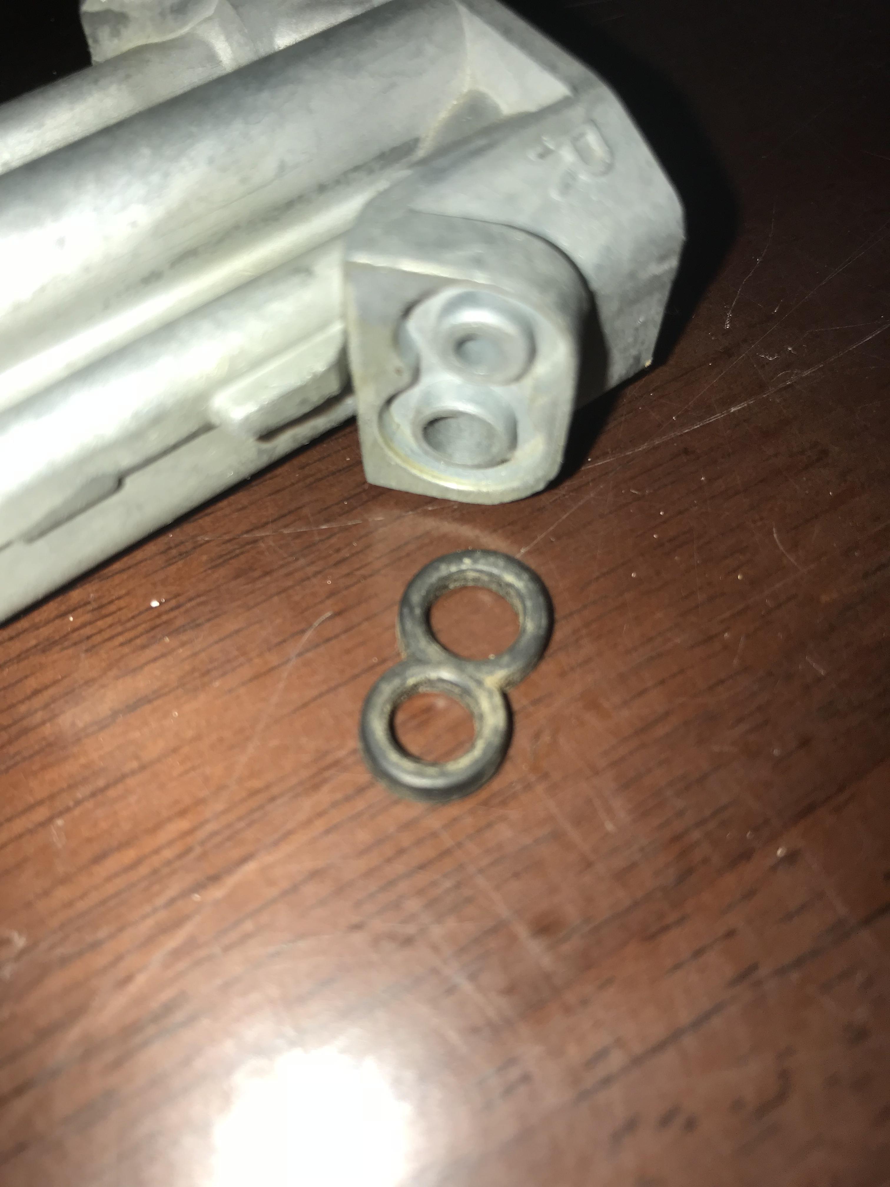

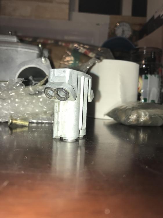

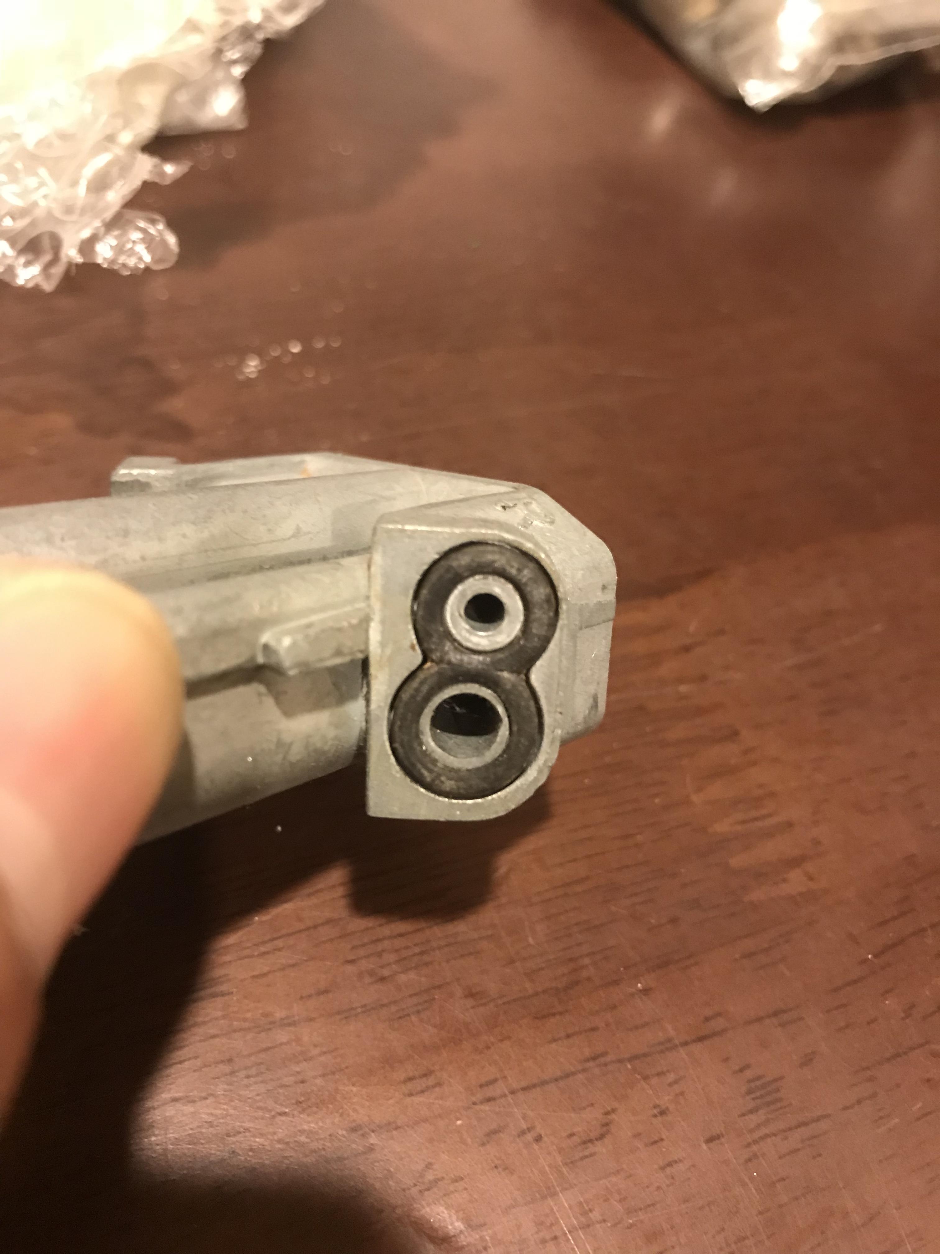

January 28, 20196 yr Author comment_566870 About a Mikuni Solex carb , what everyone is doing about this , eight shape rubber gasket . This gasket is not listed on a service manual / parts catalog because it is not meant to be disassembled. Please see the pictures, you see the eight shape groove on the cast jet block body . If this gasket deteriorated , fuel is not supplied correctly. However , overhaul kit never including this gasket . This gasket is sold by a few venders . The gasket is described “ Factory Mikuni made “ . I have some , yes I think they are genuine by the looks . Each one cost 1000 JPY ( 10 USD ) ! How come this is available, while overhaul kit does not have it . Anyway , I have bought some from a local Mikuni service shop . @nix240z , is there any chance to make this by your hand ? If demand is large enough , a price will be less than 10 USD ? Kats Edited January 28, 20196 yr by kats Link to comment https://www.classiczcars.com/forums/topic/23900-datsun-240z-vs-fairlady-z432/?&page=115#findComment-566870 Share on other sites More sharing options...

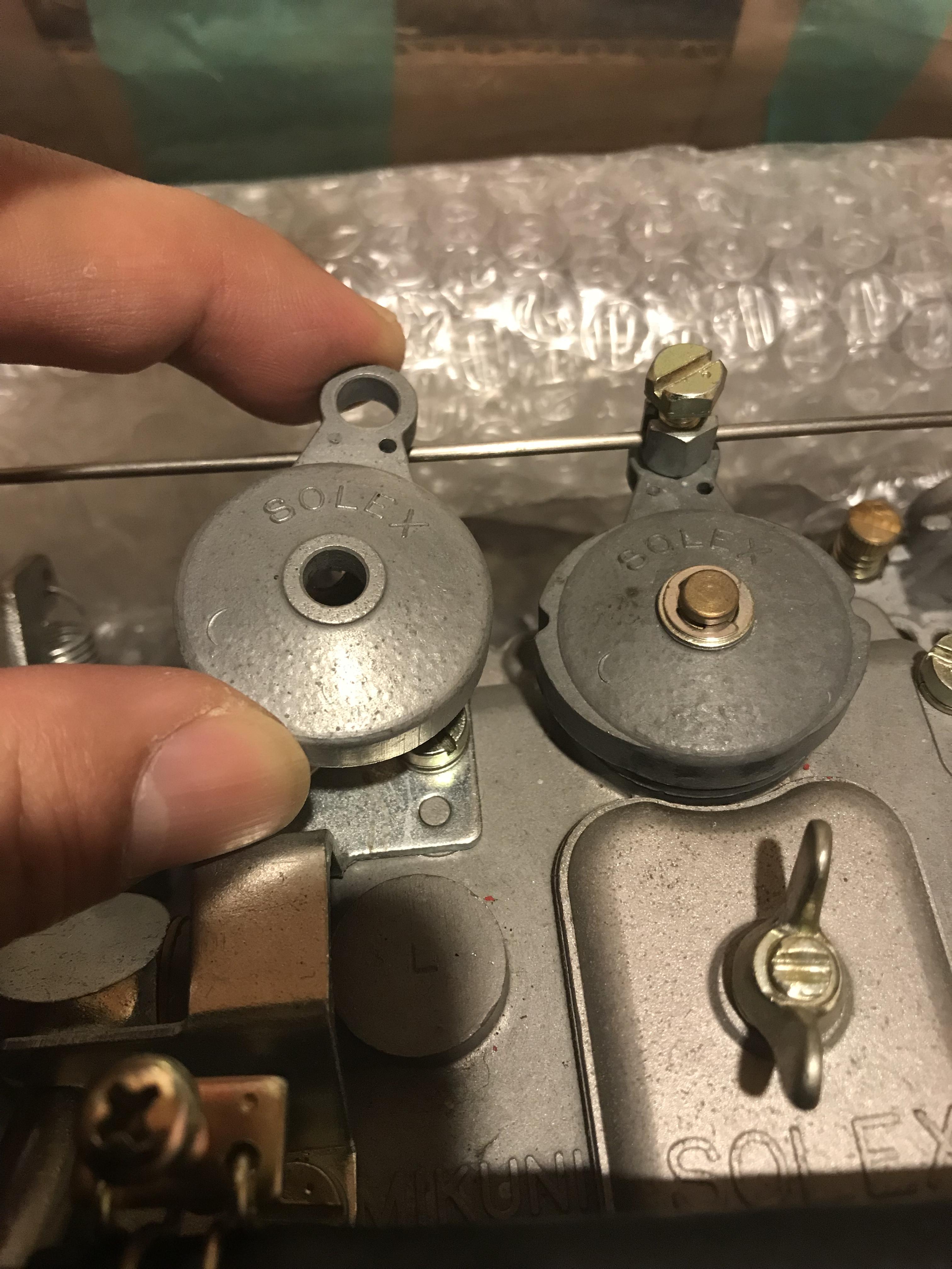

January 28, 20196 yr Author comment_566871 By the way , the left choke disc is an early type , the right one is later type . My spare set of Mikuni 40 PHH is an early type which has straight-head screw for securing top cover . They must have an early type choke disc but , later type is on . Today Mr. Shimoura ( Hakosuka GTR And ZG owner ) gave me an old picture attached on a wooden frame , he told me the engine is for KPGC 110 ( Ken & Merry GTR ) because the oil cap is a black plastic , and the carburetors has Philip head screws for a top cover .And the choke disc is a later type . Kats Link to comment https://www.classiczcars.com/forums/topic/23900-datsun-240z-vs-fairlady-z432/?&page=115#findComment-566871 Share on other sites More sharing options...

January 29, 20196 yr comment_566898 6 hours ago, kats said: About a Mikuni Solex carb , what everyone is doing about this , eight shape rubber gasket . This gasket is not listed on a service manual / parts catalog because it is not meant to be disassembled. Please see the pictures, you see the eight shape groove on the cast jet block body . If this gasket deteriorated , fuel is not supplied correctly. However , overhaul kit never including this gasket . This gasket is sold by a few venders . The gasket is described “ Factory Mikuni made “ . I have some , yes I think they are genuine by the looks . Each one cost 1000 JPY ( 10 USD ) ! How come this is available, while overhaul kit does not have it . Anyway , I have bought some from a local Mikuni service shop . @nix240z , is there any chance to make this by your hand ? If demand is large enough , a price will be less than 10 USD ? Kats Hey Kats, I noticed this also when I pulled mine apart, thought it was odd.. I found a vendor in the US that sells them however, as mine were so brittle when I removed them they broke into several pieces, they were more like plastic than rubber! https://www.ebay.com/itm/TOYOTA-2000-GT-SOLEX-MIKUNI-40-PHH-CARBURETOR-GASKET-KIT/291845981988?epid=1642106380&hash=item43f3604724:g:GuAAAOSw6n5XsK8M:rk:15:pf:0 eBay seller Upgrade Motoring has all the parts from what I can gather. https://www.ebay.com/usr/upgrademotoring eg: https://www.ebay.com/itm/MIKUNI-44PHH-CARB-GASKETS-REBUILD-KIT-W-PUMP-DIAPHRAGM-FIG-8-ORINGS-240Z-510-S30/142838570315?hash=item2141d79d4b:g:ct4AAOSw-RhaWVRn:rk:11:pf:0 This kit is good value. https://www.ebay.com/itm/MIKUNI-44PHH-CARB-GASKETS-REBUILD-KIT-X3-W-PUMP-DIAPHRAGM-FIG-8-ORING-240Z-SOLEX/143029235076?hash=item214d34ed84:g:WdoAAOSwzhZb~HGW:rk:29:pf:0 Or this European seller has them for $3 each. https://www.ebay.com/itm/SOLEX-40-PHH-MIKUNI-CARBURETOR-JET-CARRIERS-O-RING-8-SHAPED/292072596660?hash=item4400e224b4:g:iJwAAOSwJQdXDSoz:rk:22:pf:0 Link to comment https://www.classiczcars.com/forums/topic/23900-datsun-240z-vs-fairlady-z432/?&page=115#findComment-566898 Share on other sites More sharing options...
January 29, 20196 yr comment_566901 6 hours ago, kats said: By the way , the left choke disc is an early type , the right one is later type . My spare set of Mikuni 40 PHH is an early type which has straight-head screw for securing top cover . They must have an early type choke disc but , later type is on . Today Mr. Shimoura ( Hakosuka GTR And ZG owner ) gave me an old picture attached on a wooden frame , he told me the engine is for KPGC 110 ( Ken & Merry GTR ) because the oil cap is a black plastic , and the carburetors has Philip head screws for a top cover .And the choke disc is a later type . Kats I have both early and late but I never knew the fasteners were OEM. I just thought someone had replaced the phillips head screws with the other type! I've got a few pairs of 40's and about 5 sets of 44's now.. (I have a problem) but I love these carbs. I forgot to mention above that with regard to the missing gaskets, I found the same problem with my SU carb rebuild kit, that the fuel filter screens, the crush washers and some gaskets were missing. The rebuild kit also didn't contain new floats, which I thought was odd if I'm honest. So it's not unusual that rebuild kits don't contain everything. I think in most cases the assumption is that you don't remove the jet block when rebuilding these carbs and just replace all the other gaskets and accelerator pump diaphragm? Who knows? I had all my carbs completely disassembled and I vapour blasted them to look like new! Photos here: https://www.viczcar.com/forum/topic/11264-safari-brown-i-mean-gold-the-nsw-project/?do=findComment&comment=205897 Before: After: My SU's I rebuilt myself after having all fasteners plated and manifold + carb bodies vapour blasted. I should really order in the parts to finish my Mikuni rebuild's. Compared to working on SU's, I love the Mikuni's. They are easier in many ways to work with. Link to comment https://www.classiczcars.com/forums/topic/23900-datsun-240z-vs-fairlady-z432/?&page=115#findComment-566901 Share on other sites More sharing options...
