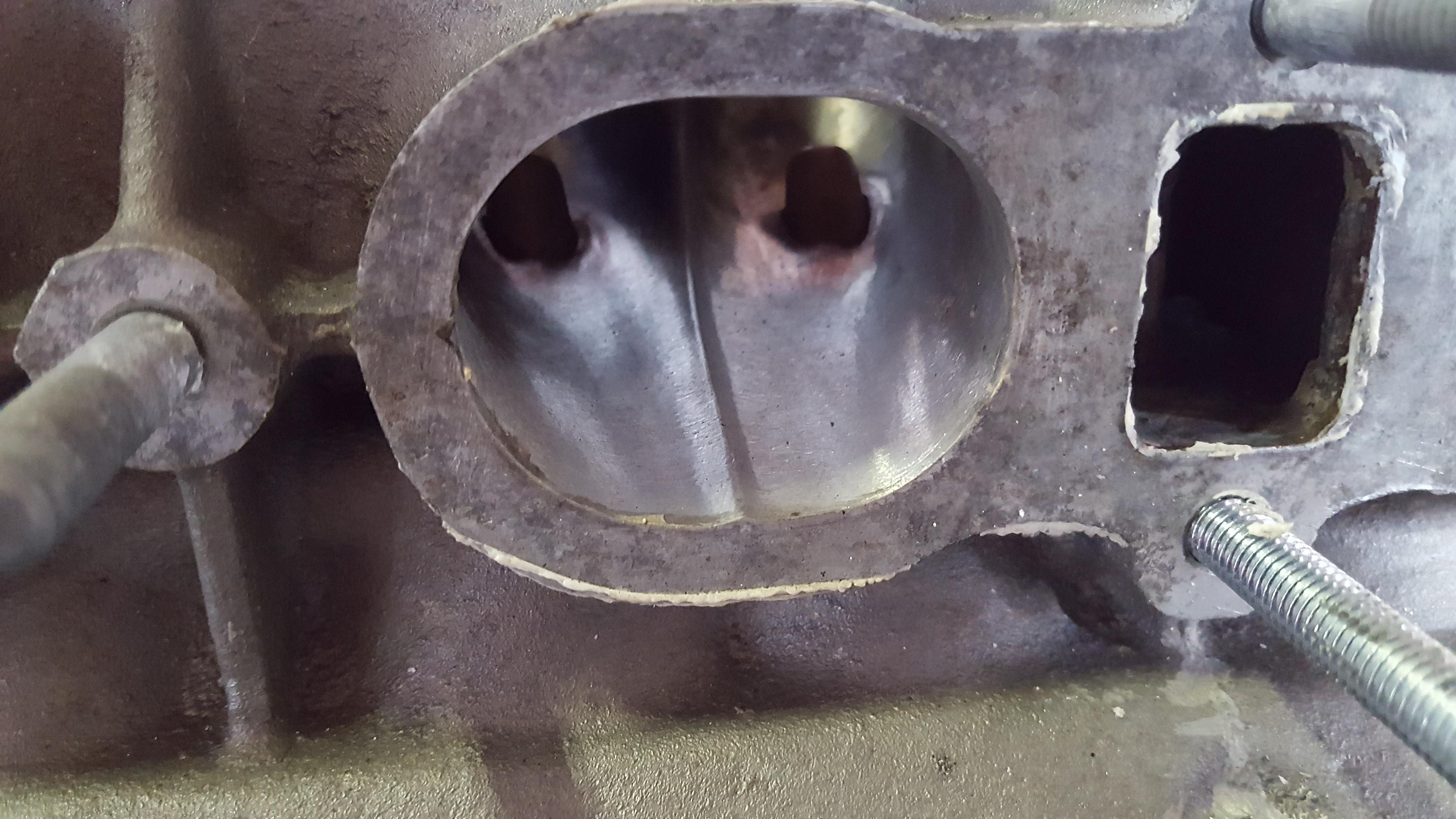

I would like to show this , my NOS S20 head compared to my used spare one.
I found the used spare one had had the hand work in the past , you can see  the surface is trimmed , and grinded smoothly . NOS one looked completely different. As I have heard this used one came from 432-R , so I guess previous owner had put some work into this engine . However, it is a subtle work !
This pictures showing an Exhaust port ,
intake port looked almost same for both .

I have looked at a lot of S20 engines over the years now, and I don't think I have ever seen a head casting in-use that had not received some detailing/'blueprinting' attention inside the port castings. I believe your NOS head is untouched in the ports because it never reached the stage where it was prepped before fitting to a working engine.

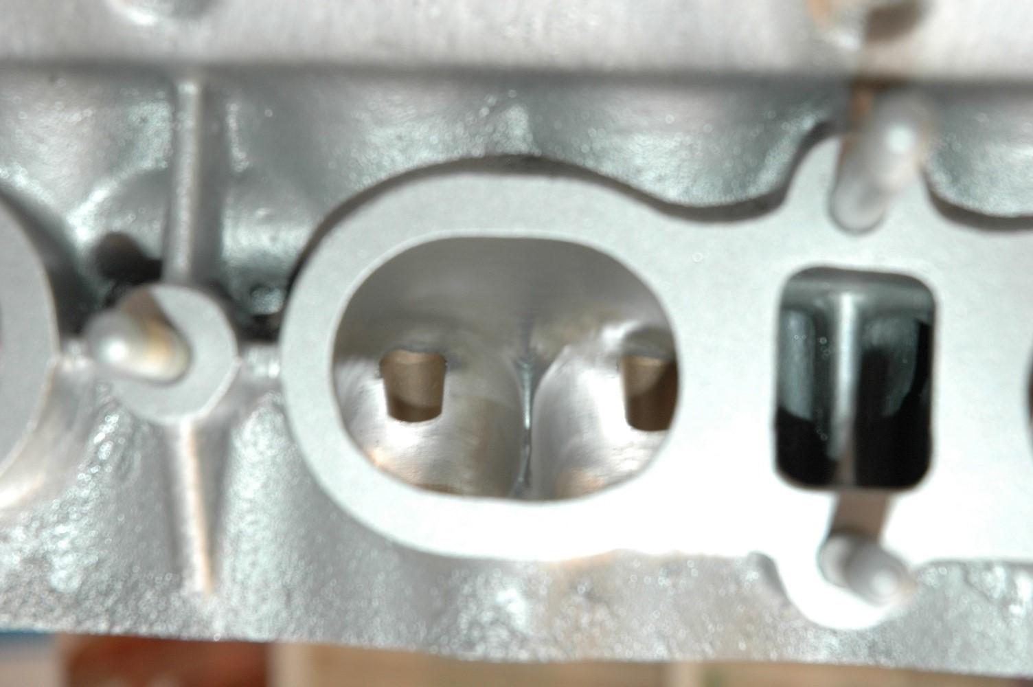

I'm pretty sure that the S20 engine in my 432-R replica (itself a very early 432-type S20 engine) was never taken apart until I stripped it to rebuild it. Both the inlet and exhaust port areas had been hand finished, with the dividing wall between the valves 'knife-edged'. Not the best photo, but you get the idea:

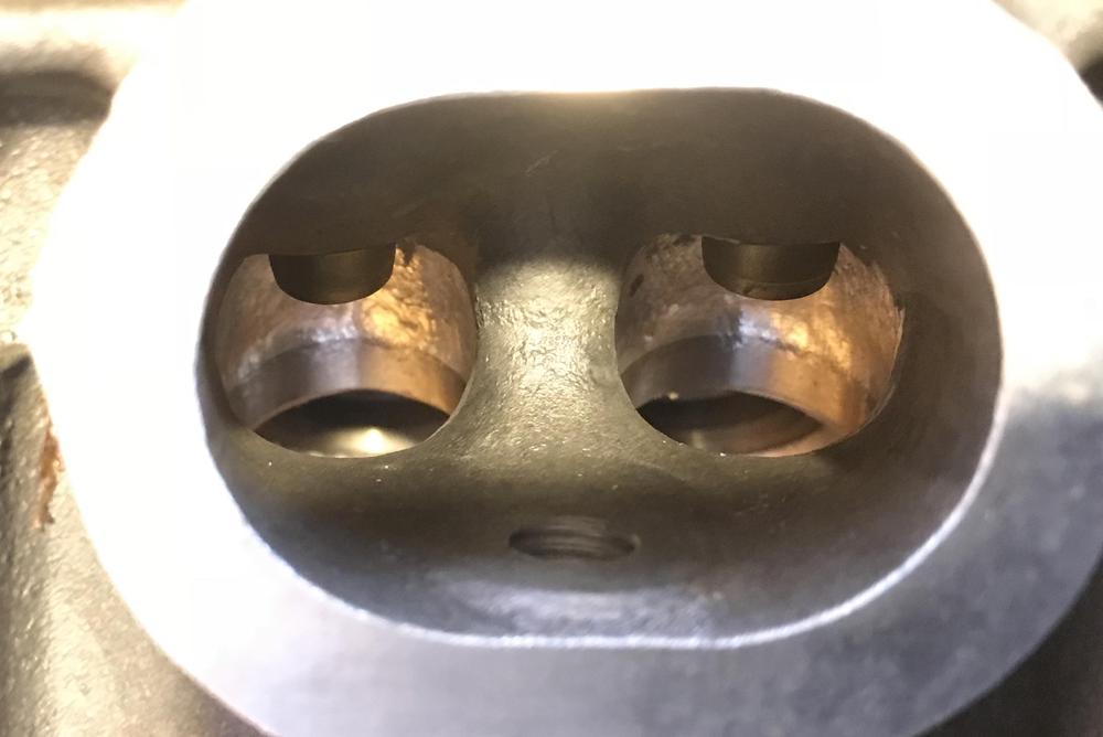

Here's another K3 head:

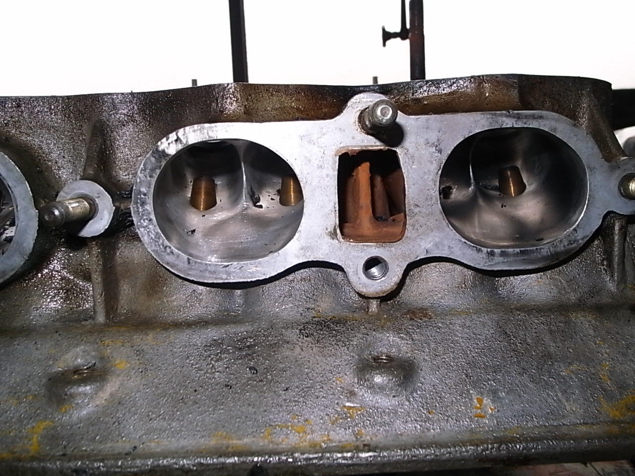

And for comparison, a super rare works race K3R head:
