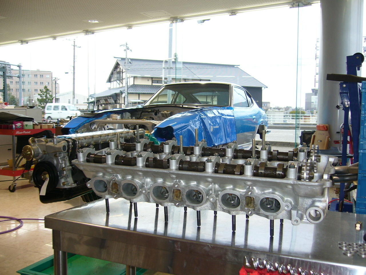

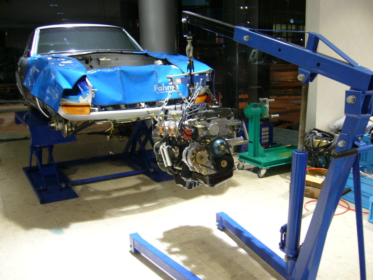

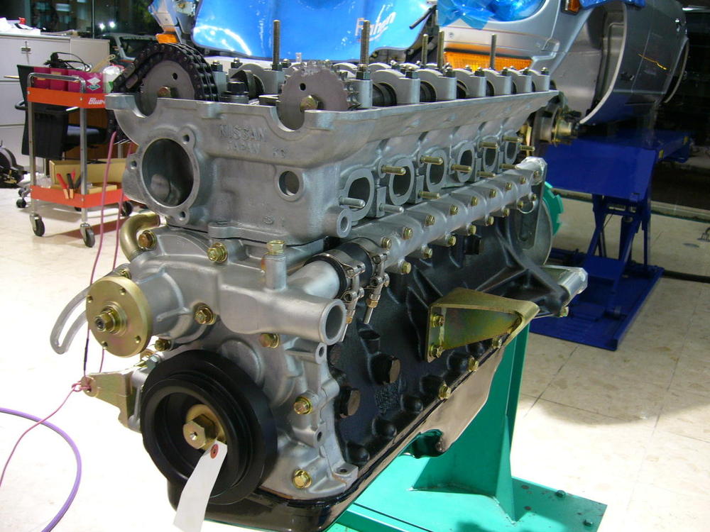

March 7, 20196 yr Author comment_570256 Thanks Alan for the pictures of super rare heads , it is a little bit scary for me to seeing "knife edged " triming as I think there are not much meat left around it. Looks like my Z432 has a hand finished port for each , pictures from March 2007 at the shop . Kats Edited March 7, 20196 yr by kats Link to comment https://www.classiczcars.com/forums/topic/23900-datsun-240z-vs-fairlady-z432/?&page=120#findComment-570256 Share on other sites More sharing options...

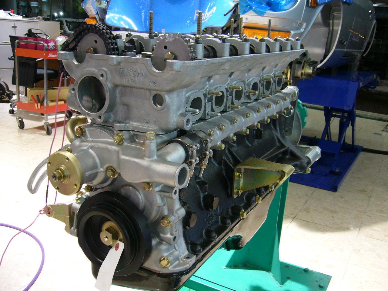

March 7, 20196 yr Author comment_570264 When the car was under restoration, a few things were not correct like a water pump ( for GTR ) , an engine block ( must be silver ) and an oil filter was for non- cooler type . I had changed them as you know , and the parts which shown I attached pictures are going to be on my spare S20 . And some of you may remember Mr. Takei , a chief engineer of developing Europe S30 team . He drove through Europe with his freshly rolled out Euro 240Z after finished his work , that was in April to September 1971 . After he returned, he reported to Dr . Nakagawa like this , “ Japanese automotive technology is far behind from which Europe has , I think 15 years behind “ Then Dr. Nakagawa said to him “ you go to Europe again and learn from them “ The picture was taken Luxembourg. courtesy Nostalgic Hero extra edition No. 564 Kats Edited March 7, 20196 yr by kats Link to comment https://www.classiczcars.com/forums/topic/23900-datsun-240z-vs-fairlady-z432/?&page=120#findComment-570264 Share on other sites More sharing options...

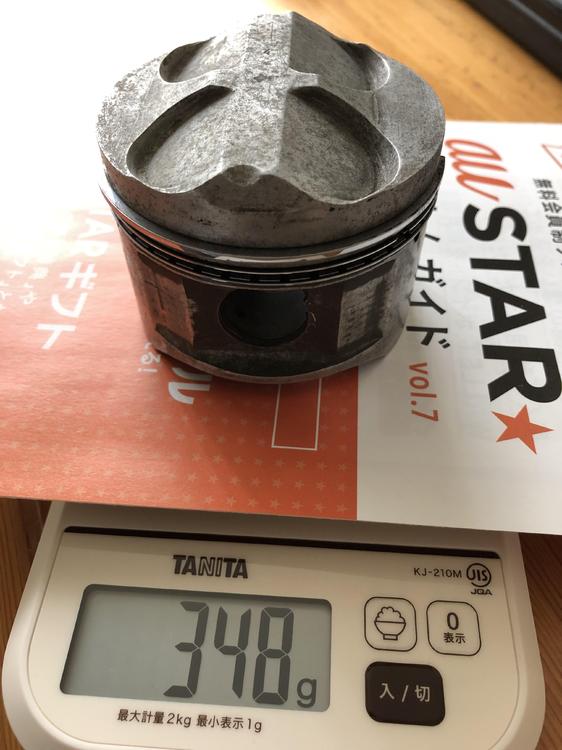

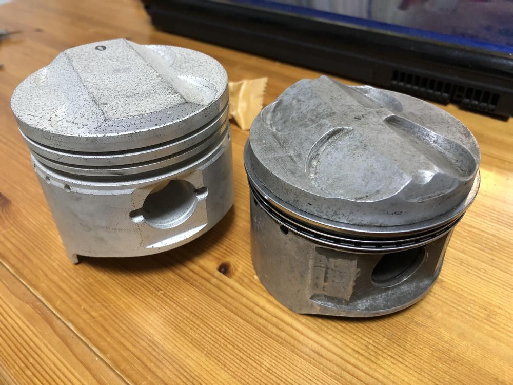

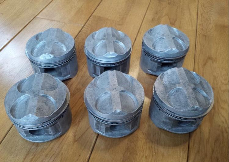

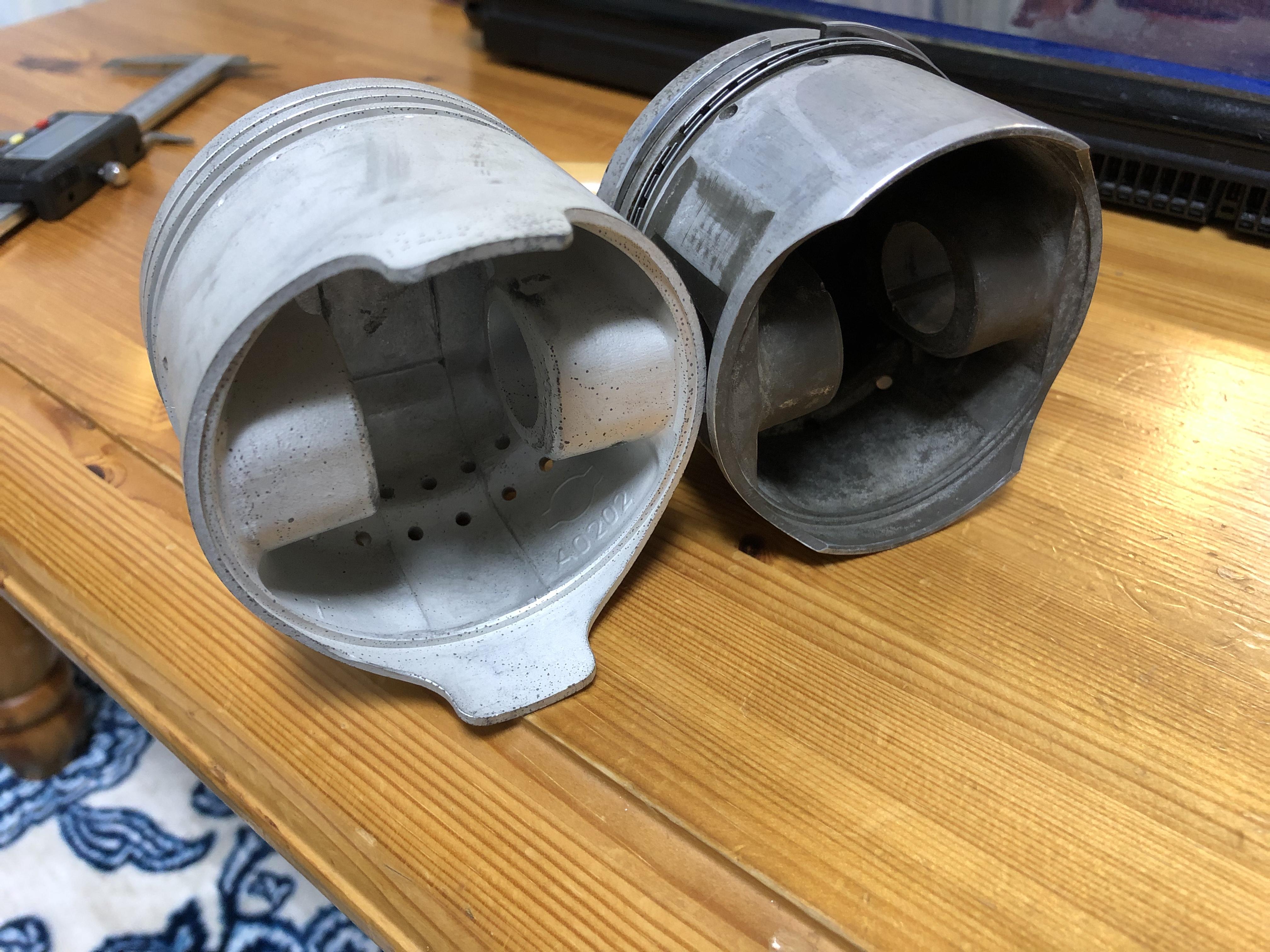

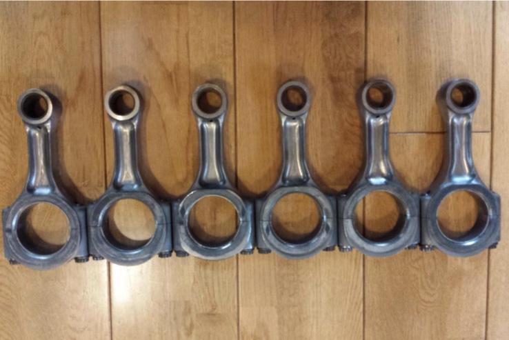

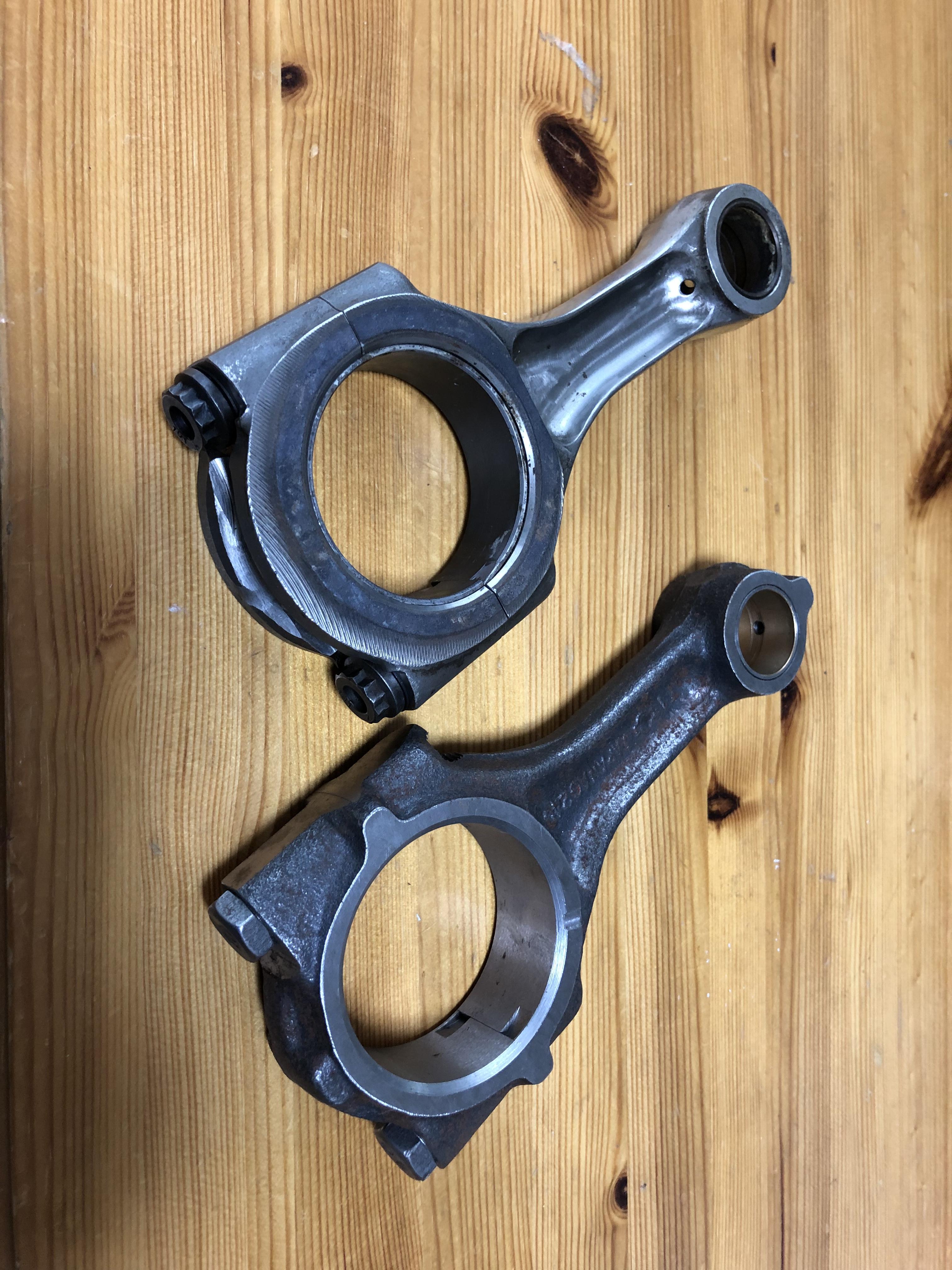

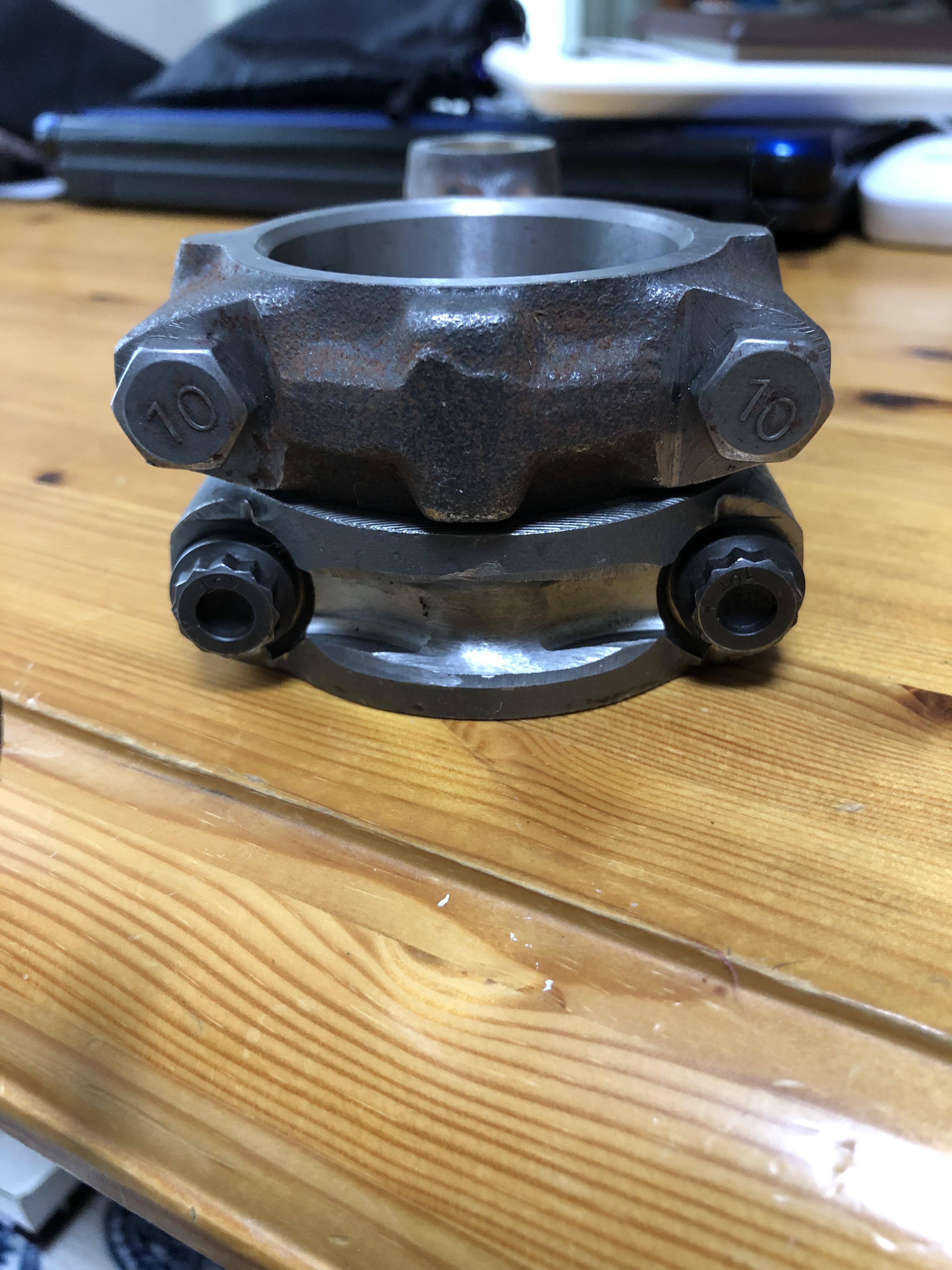

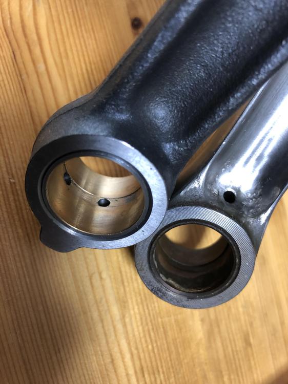

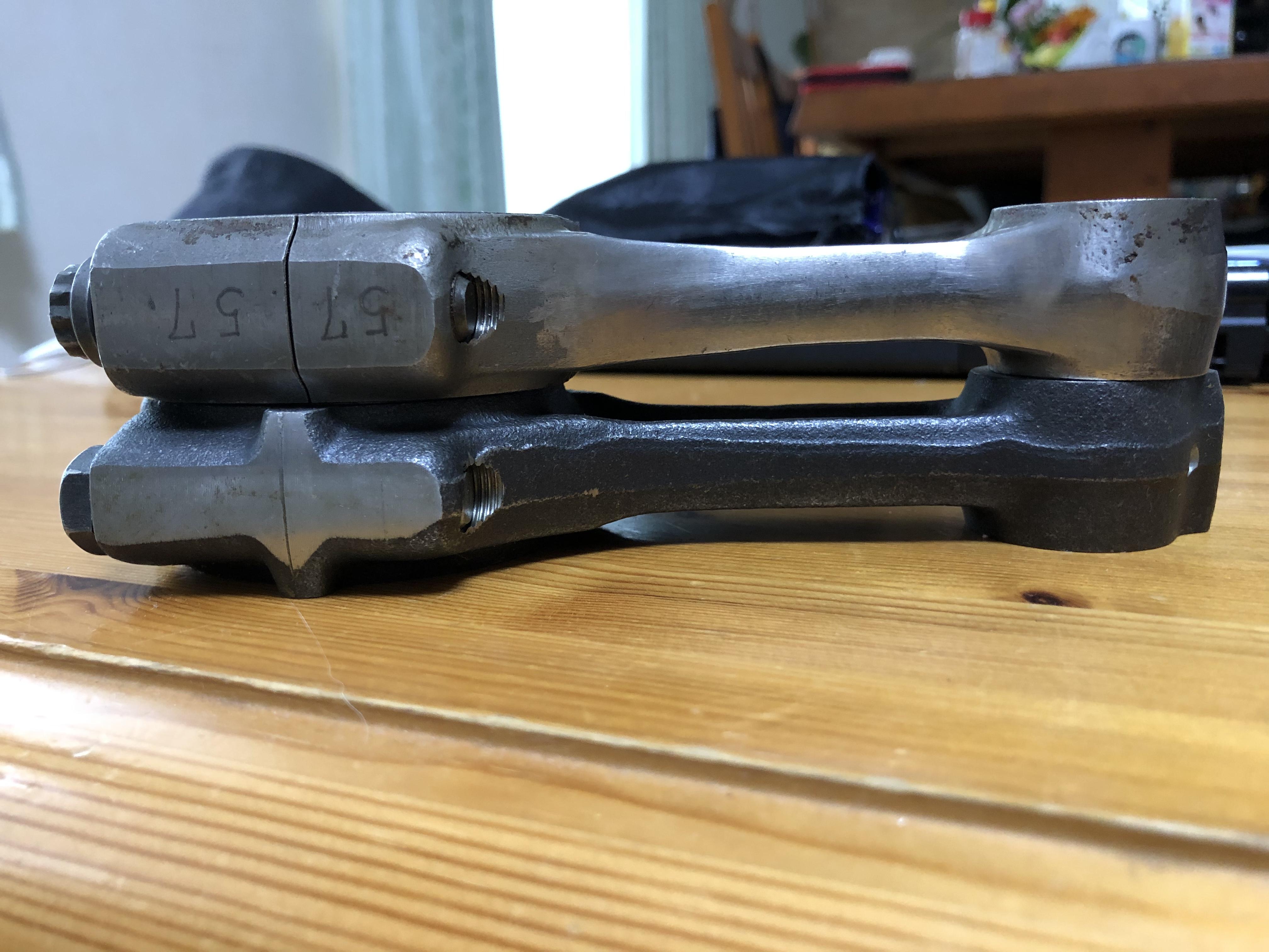

March 23, 20196 yr Author comment_571689 Hi , I have got a set of high compression pistons and , titanium conn rods . They are meant to be used in a racing car ( GTR or Z432-R), factory team or private racer . I try not to expect too much , but I think these parts in front of me are real period correct parts which related to either Nissan Murayama , Oppama , Omori racing factory. From early 1969 to mid 1972 , those factories were very busy every day for developing racing S20 engines . Engineers and craftsman tried so hard making new cams , pistons , etc , testing them , and installing them in racing cars .Even heads as well as blocks , almost each race has new parts . Some parts were the same which were sold as sports option in a catalog , but many of them were not listed in a catalog , factory or some private racer only . This titanium Conn rod is the one , not on a catalog but used in racing. This piston is the same , looks slightly different from others . Alan , could you authenticate these parts ? And please tell us more about racing back in those old days. The titanium conn rod is 474 gram , the std conn rod is 710 gram , I have heard titanium is lighter than steel , it is about 2/3 . So , looks like I have got a correct one ! Kats Link to comment https://www.classiczcars.com/forums/topic/23900-datsun-240z-vs-fairlady-z432/?&page=120#findComment-571689 Share on other sites More sharing options...

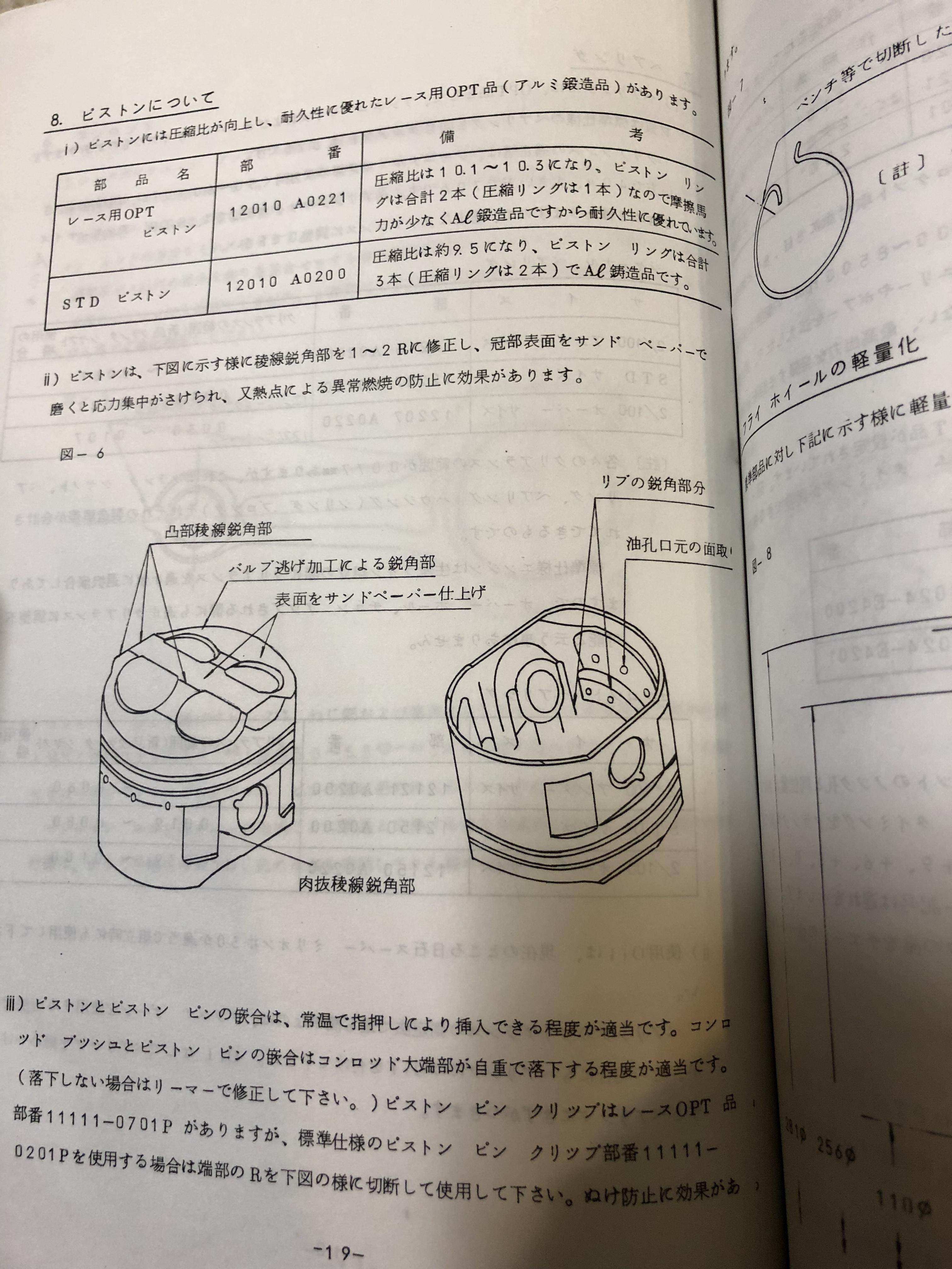

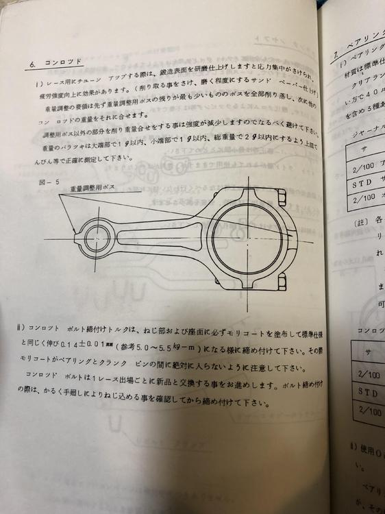

March 23, 20196 yr Author comment_571690 A set of parts , and Z432-R racing manual. It is said that STD pistons are casting made , on the other hand racing pistons are forging made . Even this page doesn’t mention about titanium conn rods , it is the sign of “ titanium conn rods are specifically made for factory racing “ isn’t it ? Kats Edited March 23, 20196 yr by kats Link to comment https://www.classiczcars.com/forums/topic/23900-datsun-240z-vs-fairlady-z432/?&page=120#findComment-571690 Share on other sites More sharing options...
