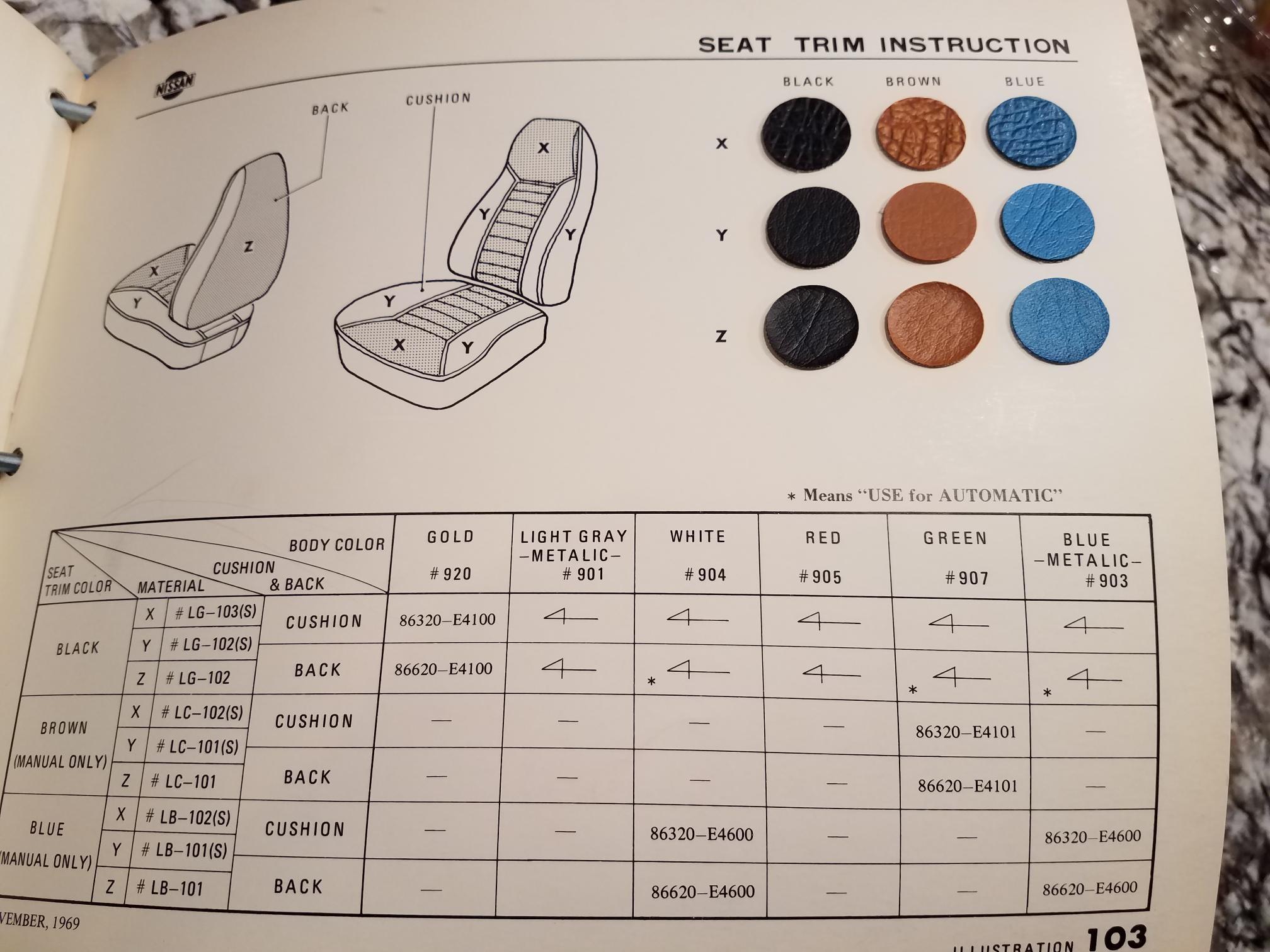

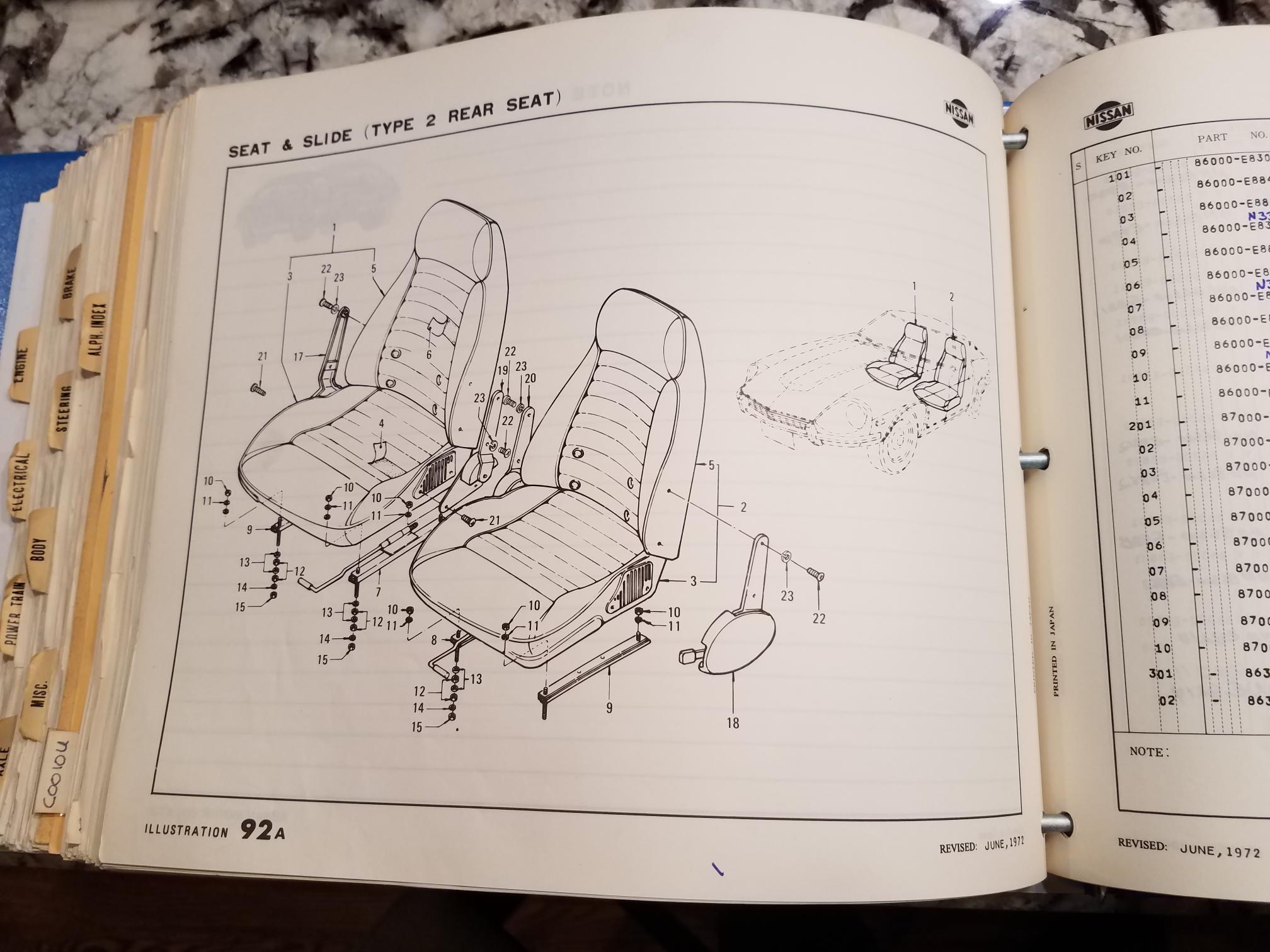

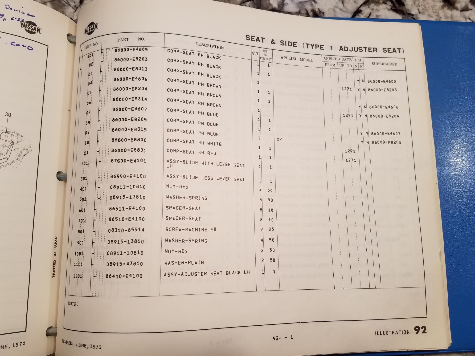

April 25, 20195 yr Popular Post comment_574162 21 hours ago, kats said: Thanks Mike , it is a great help . Don’t you think the parts number is something wrong , do you ? Please see my corrections. Anyway , the number E4103 is for the “ brown “ seats , and this doesn’t mean either the one which is kept by Mr. Sudo or the one can be seen in the test car . We actually have the tan seats as “ brown “ E4103 , don’t we ? Jason240z , I am so glad that you said that to me ! Kats Hi Kats, It looks like the numbers shown in the table are correct. Not sure why the numbering was different on the early RH seats. One of my parts books came from Nissan USA's HQ and has hand written notes when the part numbers changed or when parts were NLA. Also included a picture of the page with the vinyl swatches that includes the blue vinyl. Link to comment https://www.classiczcars.com/forums/topic/23900-datsun-240z-vs-fairlady-z432/?&page=123#findComment-574162 Share on other sites More sharing options...
April 26, 20195 yr Author comment_574219 Thank you everyone , I appreciate those valuable inputs. Kats, It looks like the numbers shown in the table are correct. Not sure why the numbering was different on the early RH seats. Mike , as I am looking at the numbers you showed here , I was wrong about my correction for the part numbers of the RHD seats . Now I have a big question, “ what is different between them ? “ If “ COMP SEAT “ means the seat includes the seat rails , and plastic spacers and plastic nuts , those things would make the difference between JDM and Export models. But I don’t think that happens... By the way, my 03/ 1970 HLS30 , I realized the RHD seat doesn’t slide fully backwards , is this for Export LHD models ? Or just the seat rails doesn’t work properly? My Z432 and 240ZG have a RHD seat which can be adjusted with a sliding mechanism fully backwards, of course. Kats Edited April 26, 20195 yr by kats Link to comment https://www.classiczcars.com/forums/topic/23900-datsun-240z-vs-fairlady-z432/?&page=123#findComment-574219 Share on other sites More sharing options...

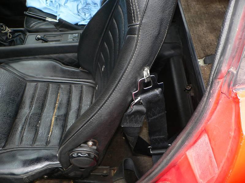

April 26, 20195 yr comment_574226 All 1970 cars I have seen just have the round knob for back tilt. There was no flip forward lever. Here is one with the knob on the outside. Link to comment https://www.classiczcars.com/forums/topic/23900-datsun-240z-vs-fairlady-z432/?&page=123#findComment-574226 Share on other sites More sharing options...
April 26, 20195 yr comment_574232 23 minutes ago, 240260280 said: All 1970 cars I have seen just have the round knob for back tilt. There was no flip forward lever. Only on export cars. As Alan noted, Japanese Market Z-L and Z-432 models had the levers to tilt the seat back that we didn't get until 1972. Link to comment https://www.classiczcars.com/forums/topic/23900-datsun-240z-vs-fairlady-z432/?&page=123#findComment-574232 Share on other sites More sharing options...

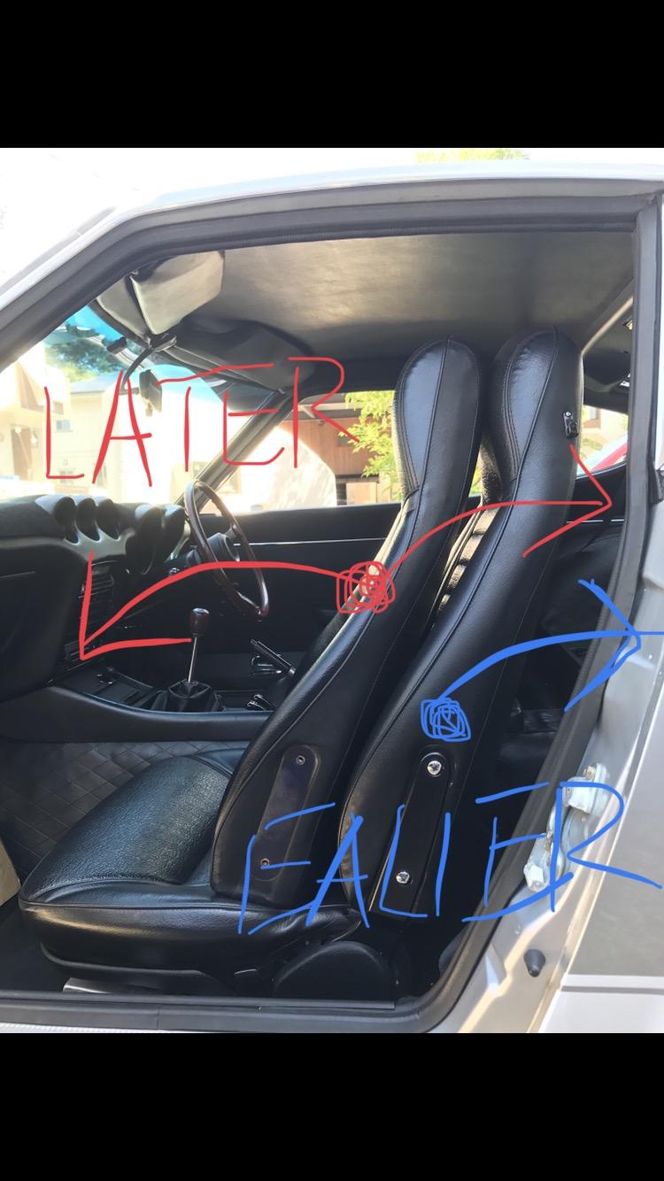

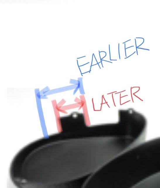

April 26, 20195 yr Author comment_574233 1 hour ago, HS30-H said: Kats, I think a lot of people here will not know that two types of seat were available in the Japanese market from the beginning of production. We could call them 'Standard' and 'Deluxe', corresponding with the models that they were originally fitted to. S30-S 'Standard' model received seats that did not have the 'flip forward' handle, but S30 and PS30 models were 'Deluxe' models and did have the 'flip forward' handle for the seat backs. I noticed on my 4/70 HLS30U that it did not have the 'flip forward' handles on the seats. As far as I can see, the early Export market cars got the 'Standard' seats. Thanks Alan , that is what I too would like to introduce everyone outside Japan , and even more , I want to emphasize this , the first Japanese market S30 reclining seats (10/69 to 01/71 ) don’t flip forward . So there is a difference in the seat reclining mechanism cover . The earlier one has a wide tab , on the other hand , the later one has a narrow tab . This difference comes from the travel amount of the seat back supports . Thanks Blue , the seats is swapped from the other one , this is what I need to do for my restored seats , because I don’t want to make them old ! Kats Link to comment https://www.classiczcars.com/forums/topic/23900-datsun-240z-vs-fairlady-z432/?&page=123#findComment-574233 Share on other sites More sharing options...
