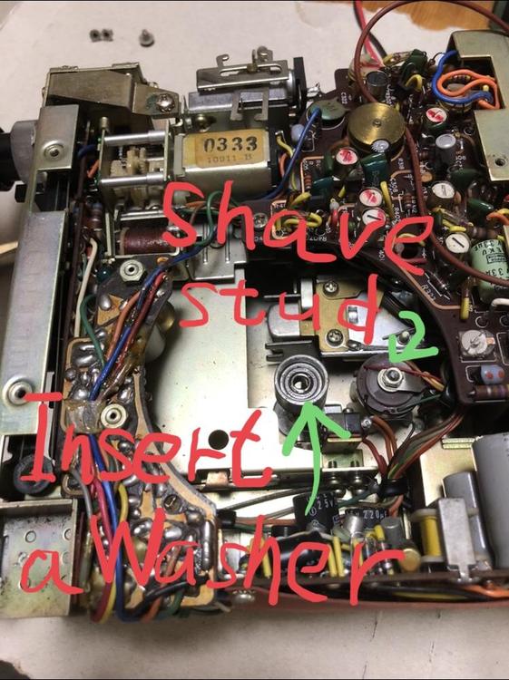

Hi , today I have a lot of things to post here .

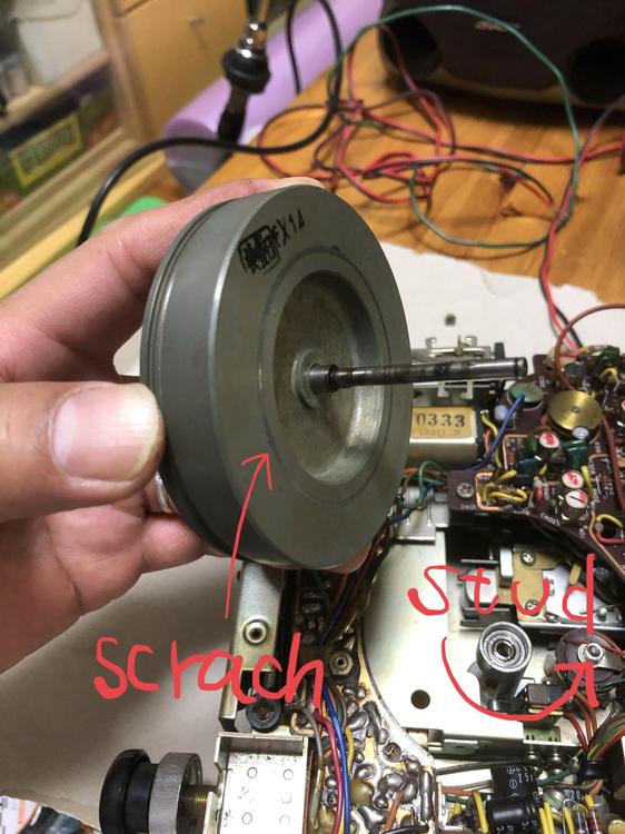

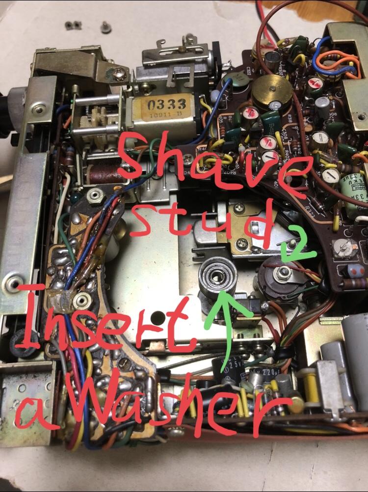

Gavin,  I have only one tip which I can tell you about is , a repair of a  8 track cassette operation . Seems nobody would be interested in it, but anyway I will give it a try describing it.
There is a big fly wheel in the middle of the deck . This fly wheel is driven by the rubber band . This is so heavy so that it has a tendency to sit lower gradually in its life . What happened next ? The result is Lowered fly wheel scratches a head  of a tiny stud . This is a cause of slower turning of the fly wheel , and the music ended up “ very slow “ . Also you will hear a dragging noise dusting operations, even worse some decks  can’t turn the fly wheel .
to be continued.
Kats
The solution is insert a washer to lift the fly wheel just a little bit .Thickness is the matter , you need to be sure that not to insert a thicker washer which would make impossible to snap a E shape clip at the bottom of the fly wheel’s shaft .
And also shave  the stud to make a gap between the stud and the fly wheel .
Kats

Thanks Blue , I am not good at all about repairing those mechanics. But now I am convinced that I can repair this problem. Currently I have three spares , and two of them have this  issue. I guess this will be a common trouble for everyone.
Kats

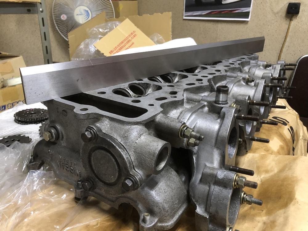

About my spare S20 , the head had an quick inspection at racing shop T- mind .
I am happy that the head is intact and no bent , no need shaving . Also crack was not found in visual check . But of course it needs to be tested with filled water in a pressurized condition.

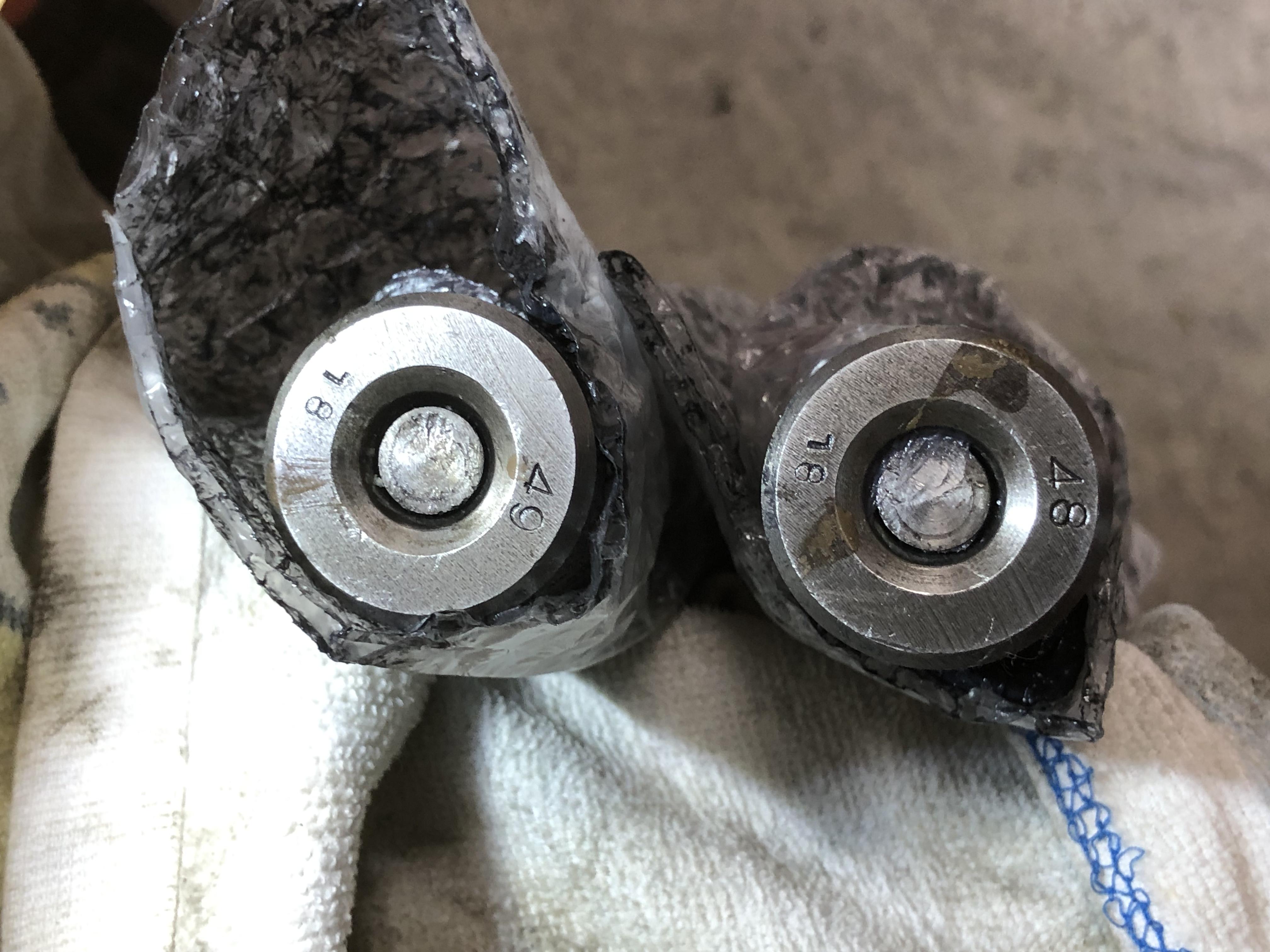

I have managed to obtain a set of race option camshafts , “8L “ is the name which is described in a  race manual . 8H is a lot exciting at a higher RPM but nothing below 3000 rpm .
Please see the picture , one has  “48” and the other has “49” on the end of camshaft.
I think this is a marking for making and assembling .
