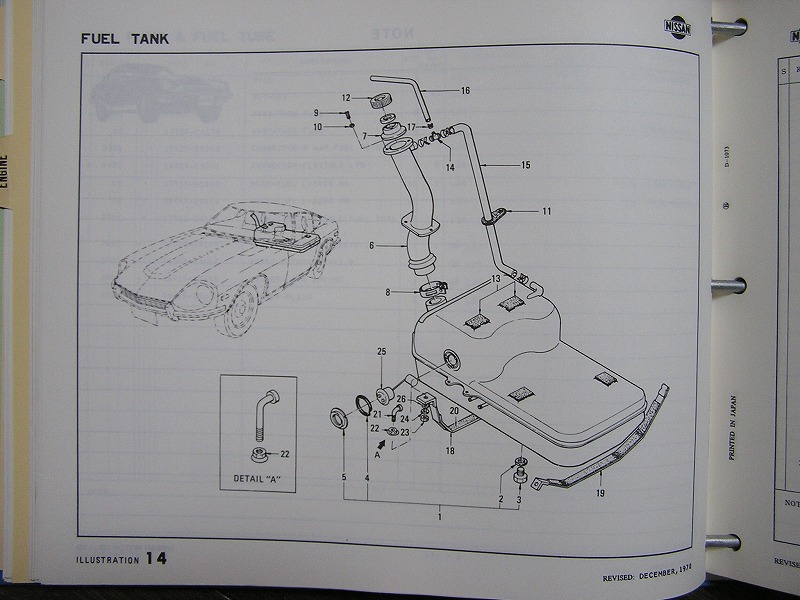

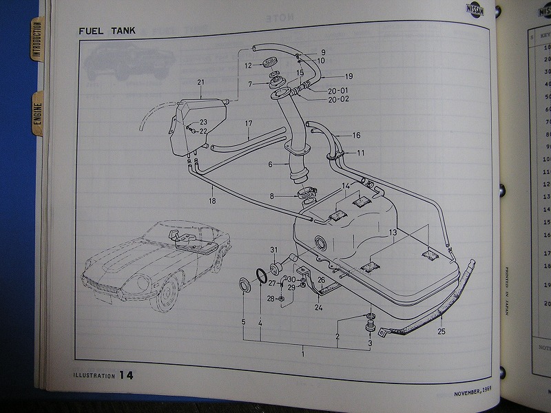

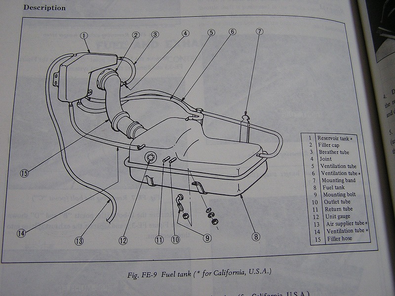

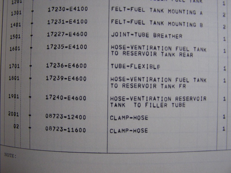

May 5, 200816 yr Author comment_246329 Thank you so much Will, the highest praise. I am so happy you like it:love: Hi Joseph, I was thinking of you,I must tell you this finding and the part number before Chris tells us! I attached pictures from the U.S. and Canada parts catalog and service manual, also 240Z RHD model catalog for comparison. The number is 17239-E4600 , this can be seen in the illustration page , the hose is #18.The illustrated shape is different from the actual part, but it is just matter in this catalog. Joseph, you can buy this hose on Ebay I saw this quite often. Or try some Z shop like Motorsport/Banzai motorworks/e.t.c. I will try local Nissan dealer in Japan if they have or not. kats Link to comment https://www.classiczcars.com/forums/topic/23900-datsun-240z-vs-fairlady-z432/?&page=14#findComment-246329 Share on other sites More sharing options...

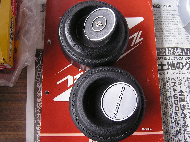

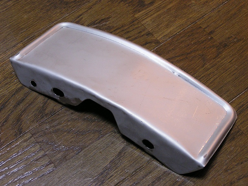

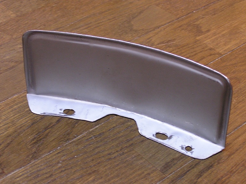

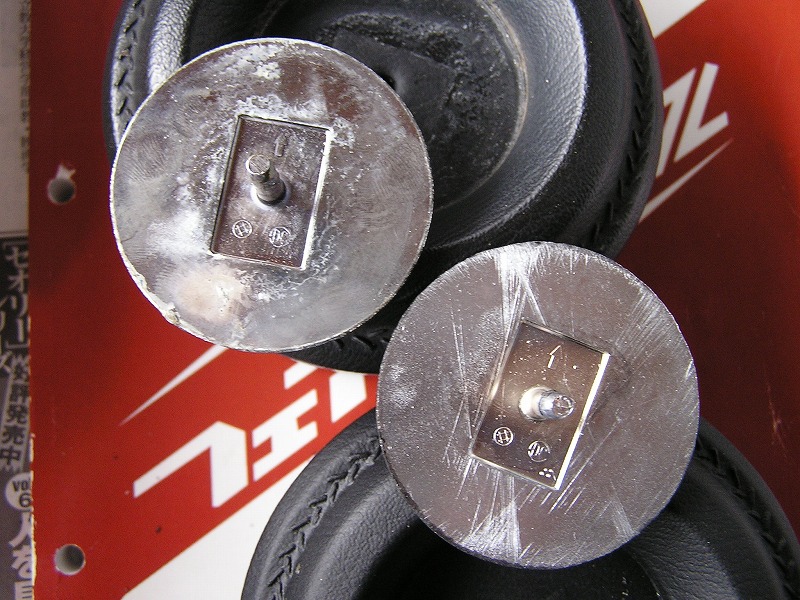

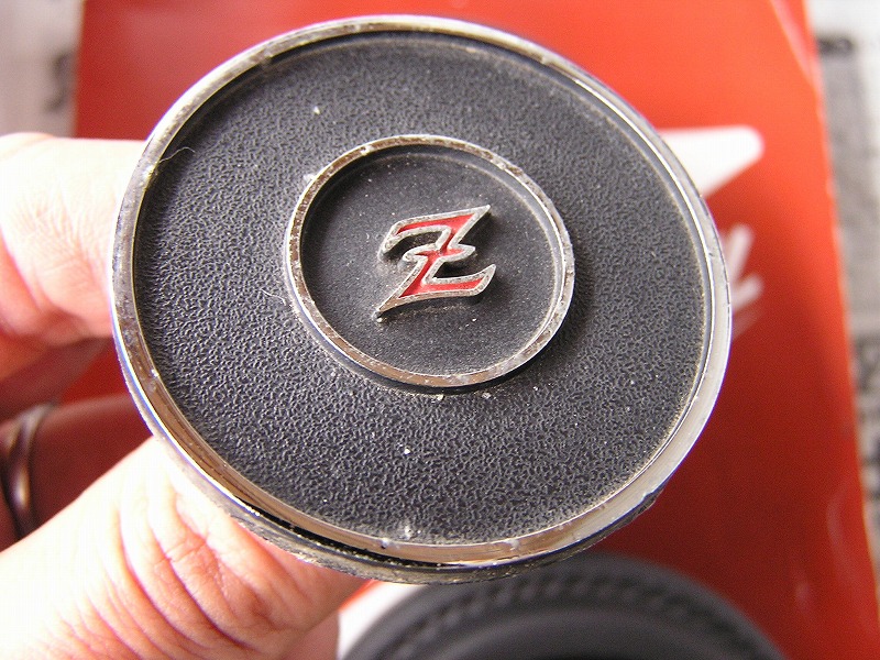

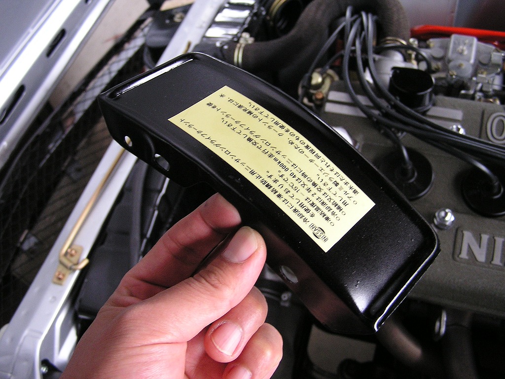

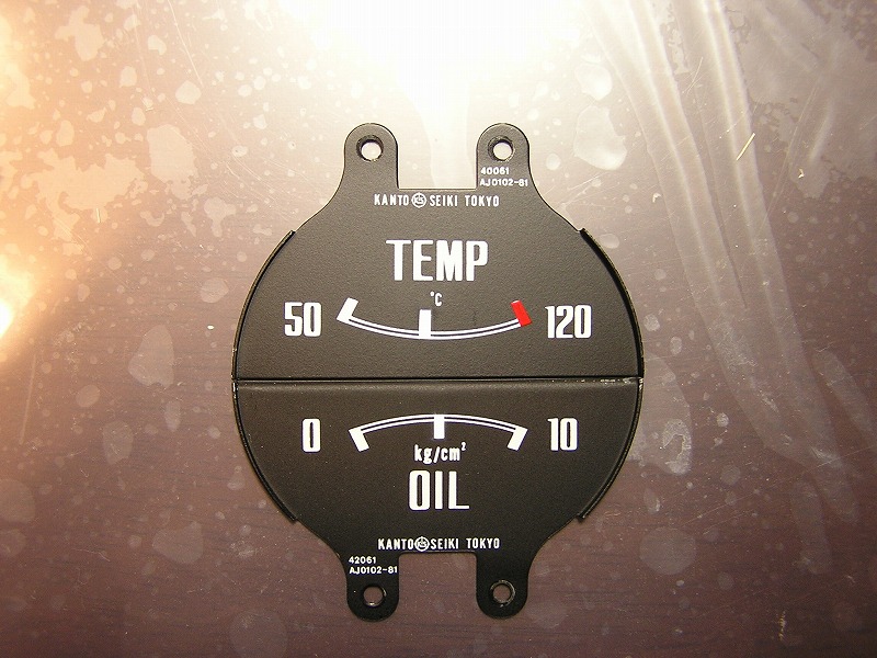

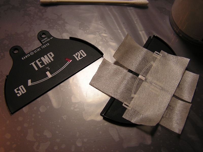

May 5, 200816 yr Author comment_246336 The third day in my holiday: I painted white scale on the water/oil gage by myself!! Not so good but not so bad.Yesterday I replaced new gage face plates to its old originals.But I felt something uneasy. The amp/fuel gage and the clock are nos,so they are very white in their scale/letters.The old one is yellowish due its aging. Then I decided to paint the white dot and tomorrow I will remove heater system and the gage again:stupid: I also replace a horn pad,Z432's pad was cracked,so a new DTSUN pad became a donor,I removed the Z432 center metal badge and applied it to the new pad. Z432's badge is special,the letter of Z is painted red inlay. Radiator fan protector,my Z432 did not come with it. Z432's radiator is made of aluminum, and the protector is attached by screws not welded.But the shape is the same of all the other S30s. Mr.Nishi reproduced it , I painted by myself. kats Link to comment https://www.classiczcars.com/forums/topic/23900-datsun-240z-vs-fairlady-z432/?&page=14#findComment-246336 Share on other sites More sharing options...

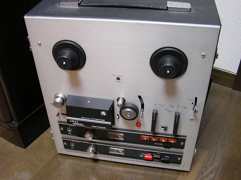

May 6, 200816 yr comment_246482 I have a multi-recorder deck , I made favorite song tapes........katsHi Kats:Did you find/buy new blank 8-Track Tapes for recording? Or did you rebuild older pre-recorded 8-Track Tapes?thanks,Carl B. Link to comment https://www.classiczcars.com/forums/topic/23900-datsun-240z-vs-fairlady-z432/?&page=14#findComment-246482 Share on other sites More sharing options...
May 6, 200816 yr comment_246489 I am sure very few people have them today. It's hard to find 8-Track tapes that will still run. Here's a SUPER rare Japanese market dealer accessory that I feel sure the USA market did not get ( for humanitarian reasons ): Link to comment https://www.classiczcars.com/forums/topic/23900-datsun-240z-vs-fairlady-z432/?&page=14#findComment-246489 Share on other sites More sharing options...
