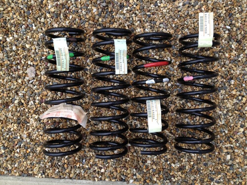

9 hours ago, kats said:
One surprising thing is , those PZR normal springs for normal suspension struts ( PZ & PZR front struts is -E4225 , rear struts is - E4125 ) have softer spring rate .
This is very interesting!
I was wrong about this , normal Z432-R has the same spring rate as Z432 , just free length is shorter than Z432 . Z432-R is 80 kg lighter than Z432 . To have equal dimensions as a variant of S30 series cars ( floor clearance hight is the same as Z432 , )  , the springs are shortened I think .
I am talking about this car , a plain , raw , ready for building a race car for your own .From Motor Magazine April 1971.
Kats
I probably can’t use my set of PZR springs because my Z is not light like PZR , the hight will drop slightly. I love Higher posture  like Safari car .
Edited by kats

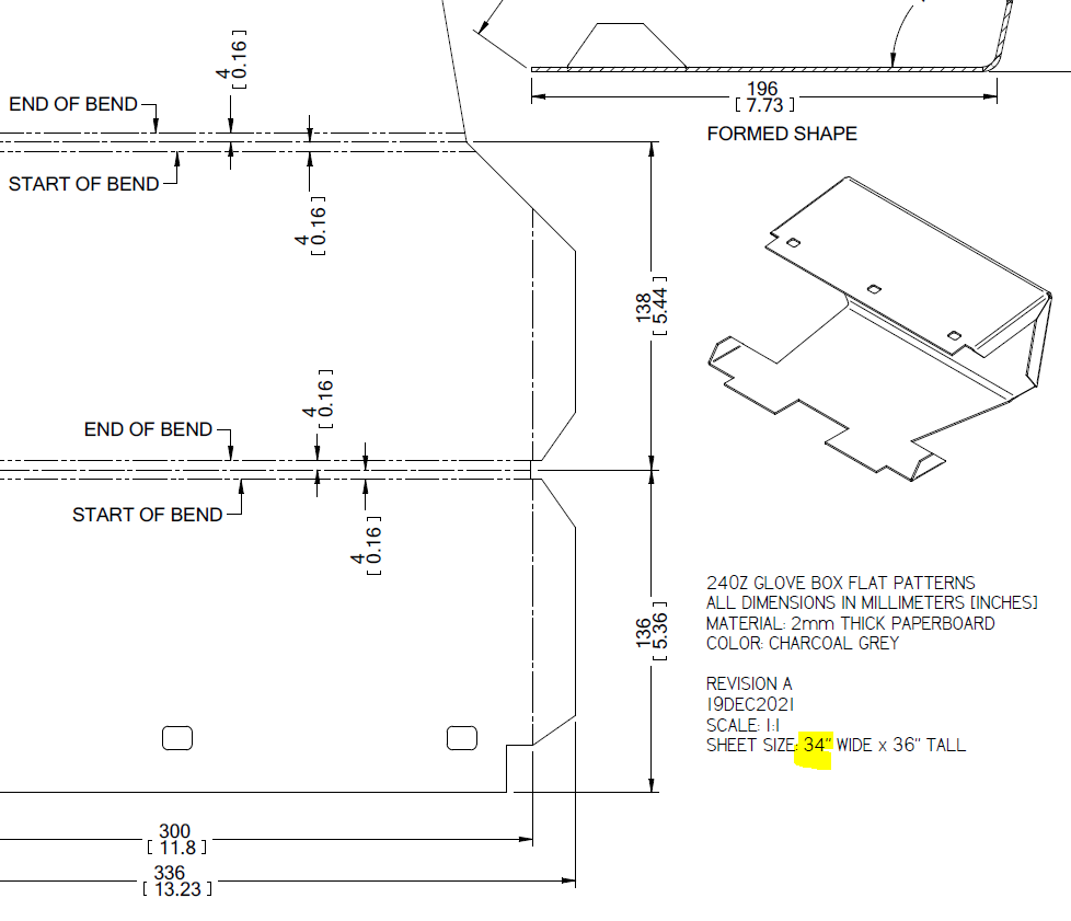

If it helps, I created a 3D step model and flat patterns from a 12/70 parts car glove box I have and uploaded the files here. The flat patterns are in acad.dwg format and pdf as well.  It's from a Canadian market LHD car but hopefully it might help.
FYI, I just noticed a typo for the sheet size I noted on the template drawing. It should be 24" wide x 36" tall, scale is 1:1 when printed on that size of sheet.
Edited by CanTechZ

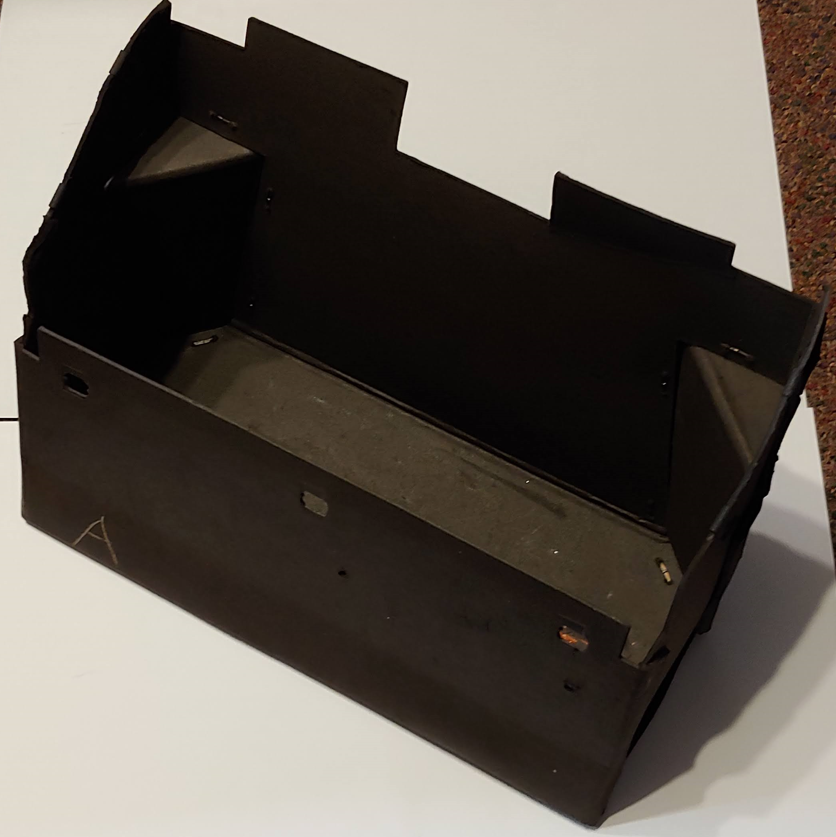

7 minutes ago, CanTechZ said:
You're welcome Kats, those chalk marks are interesting. My 7/70 HLS30 has an "A" marking. Any significance? It's not an automatic.
Wow ! Maybe “ A “ stands for USA ? I can’t wait to go and see my HLS30-02146 which may have an original glove box, my 2156 lost original when its restoration a long time ago .
This is my guess , at Nissan shatai factory , the number of car for USA was so high , so workers didn’t need to distinguish them , they needed to distinguish other destinations and rare model like an automatic . That could be why they just put A for our USA cars ?!
Kats

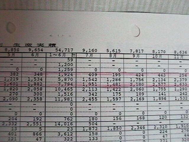

I looked up my parts catalog for tracking the glove box .  LHD model has E4600 , RHD model E4100 at first .
Then both cars have E4102 . When did that change ? I took and reviewed an old data which I have got from Mr.Uemura and Mr.Osawa ( test crew US & CANADA late 69) . Let’s do some calculations.
For S30 series domestic cars,
1969 total was 969 .
1970 Jan 127 , Feb 364 , Mar 378 . Total 1838 cars at that period.
Jul 1970 Aircon manual said cars up to S30-01629 have  to buy 68600-E4102 , after S30-01629 already have 68600-E4102.
Total 1838 S30 cars means that the number included S30/S30S/PS30/PS30SB .
I guess most of them were S30S ( Fairlady Z ) and S30(Fairlady ZL ) , PS30/PS30SB would be 100 or little more  at that point. S30S and S30 share the same chassis number on the fire wall “ S30-xxxxxx” .
So, maybe in March 1970 , the glove box changed to have notches on both sides . And why not for LHD model at the same time ?
We need to see a lot of actual glove box for this observation.
