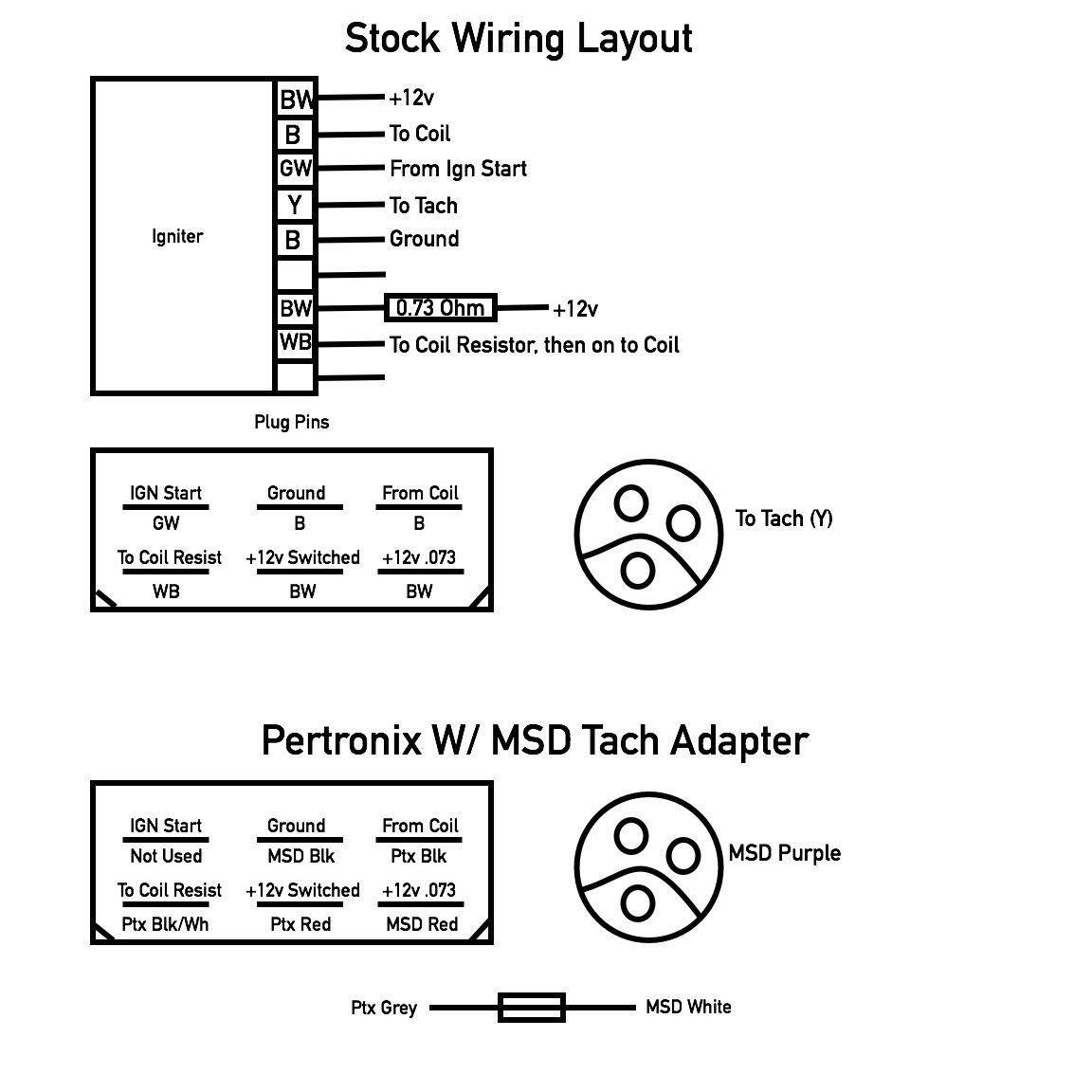

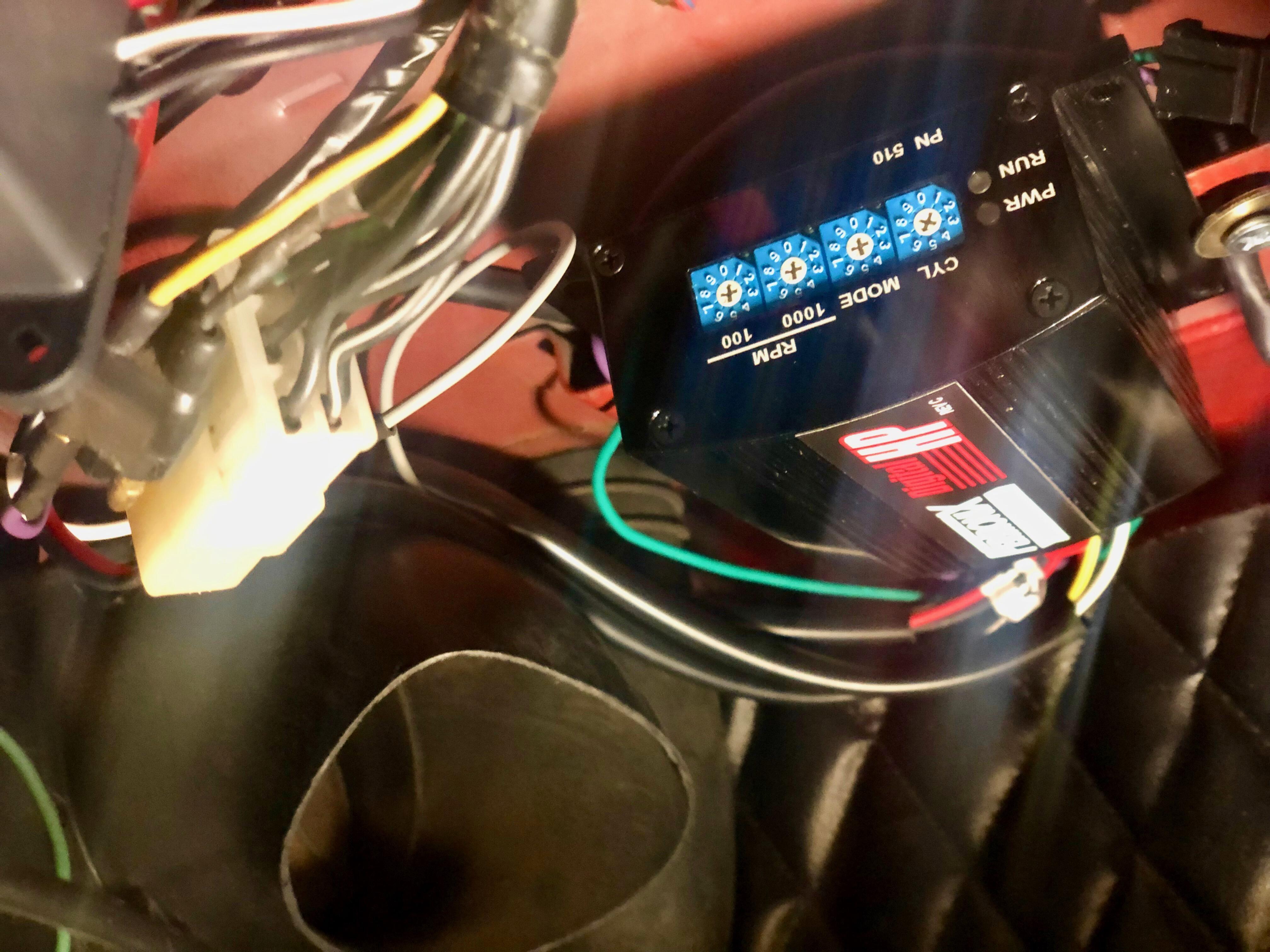

March 28, 20223 yr comment_638655 Here's my solution for replacing a PS30 Stock CDI with a Pertronix HP box, using the stock harness hookups. It fit neatly on the existing bracket, with the aid of a pair of "hold-down" fender washers. To get the Tach to work, I used an MSD Tach Adapter, as I could not get the Tach to respond to any alternate configurations using just the Pertronix setup alone. The Tach loses accuracy as the RPMs increase, with a 700 RPM difference at red line (reading 6800 at 7500 RPM actual) but for now, that deficiency will have to suffice. The other change I made is to remove the in-line coil resistor from the circuit, which is a simple matter of removing the electrical tape, removing the 8" wire connecting the resistor and the coil, and storing it for later use if needed. I'll probably just mock-up two dummy wires and re-tape it to the main harness to give a stock appearance. Of note, I think one can hookup the stock distributor trigger wires as well, but a prior owner had removed a good chunk of the wiring already, so I just used modern purple/green wires, bypassing the harness hookups. edit: in thinking a little about this tonight, I may consider adding a jumper to "Ign Start" to the +12v switched input of the Pertronix, and monitor the results. The car starts fine without this feature, but it's a little awkward, as some power is disabled during cranking (by the design of the ignition switch), which causes the Tach to jump twice. Edited March 29, 20223 yr by xs10shl Link to comment https://www.classiczcars.com/forums/topic/23900-datsun-240z-vs-fairlady-z432/?&page=154#findComment-638655 Share on other sites More sharing options...

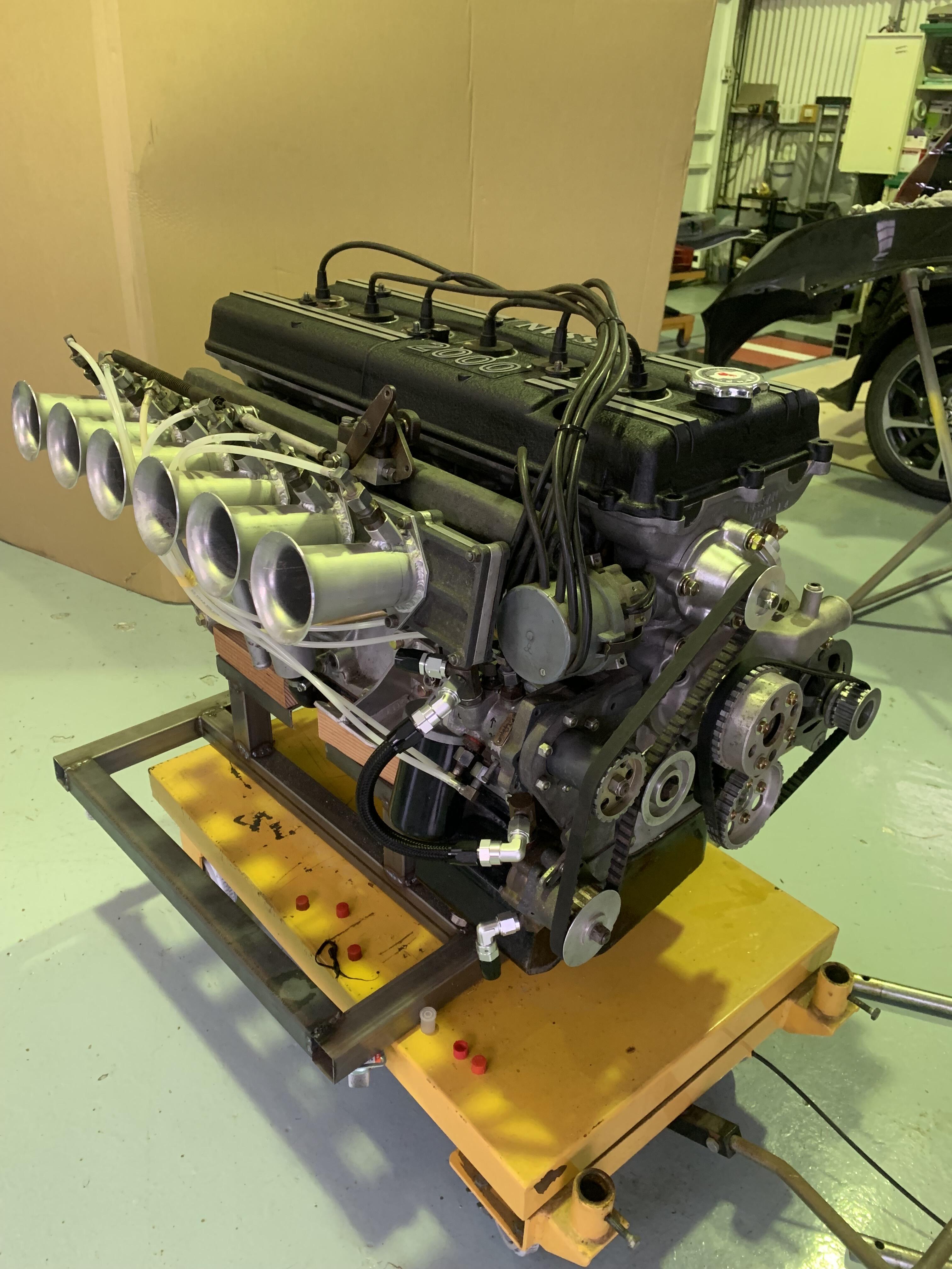

March 31, 20223 yr comment_638755 2 hours ago, kats said: Or like this , I am a bit fool for S20 even if it doesn’t sit on a car . Just looking at the machine, I can spend whole day of my life . I can do the same thing when looking at the Rb26 in my Nissan Stagea (260rs). I have been fascinated with the RB26 for 20+ years and I just like looking at the engine in the bay at times. Link to comment https://www.classiczcars.com/forums/topic/23900-datsun-240z-vs-fairlady-z432/?&page=154#findComment-638755 Share on other sites More sharing options...
March 31, 20222 yr comment_638760 15 hours ago, kats said: Or like this , I am a bit fool for S20 even if it doesn’t sit on a car . Just looking at the machine, I can spend whole day of my life . Except Alan ,I don’t think we can explain about this engine. This is probably a pinnacle of existing, working of all the S20. I will report when this engine starts fire up in a car . Kats Link to comment https://www.classiczcars.com/forums/topic/23900-datsun-240z-vs-fairlady-z432/?&page=154#findComment-638760 Share on other sites More sharing options...

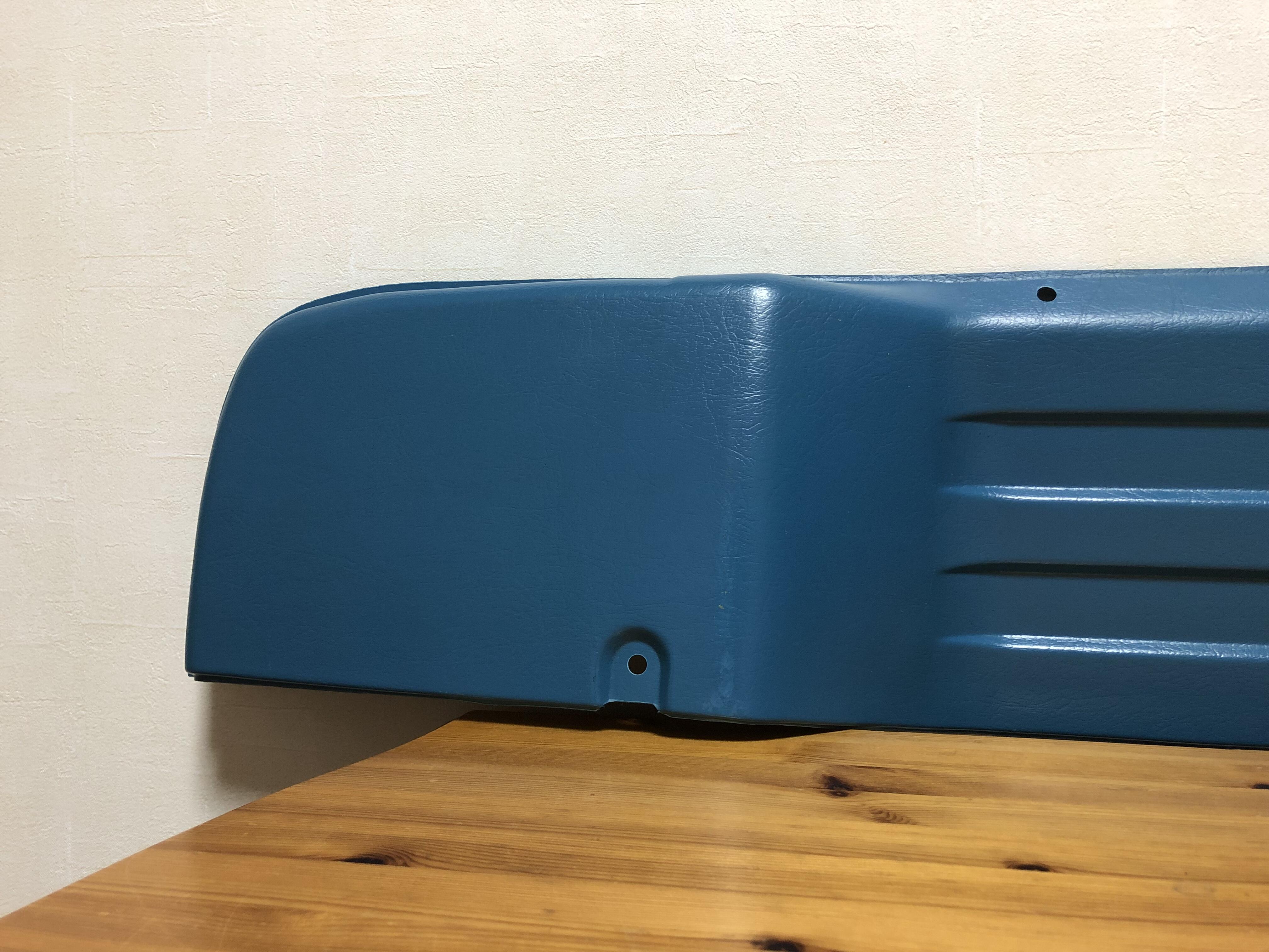

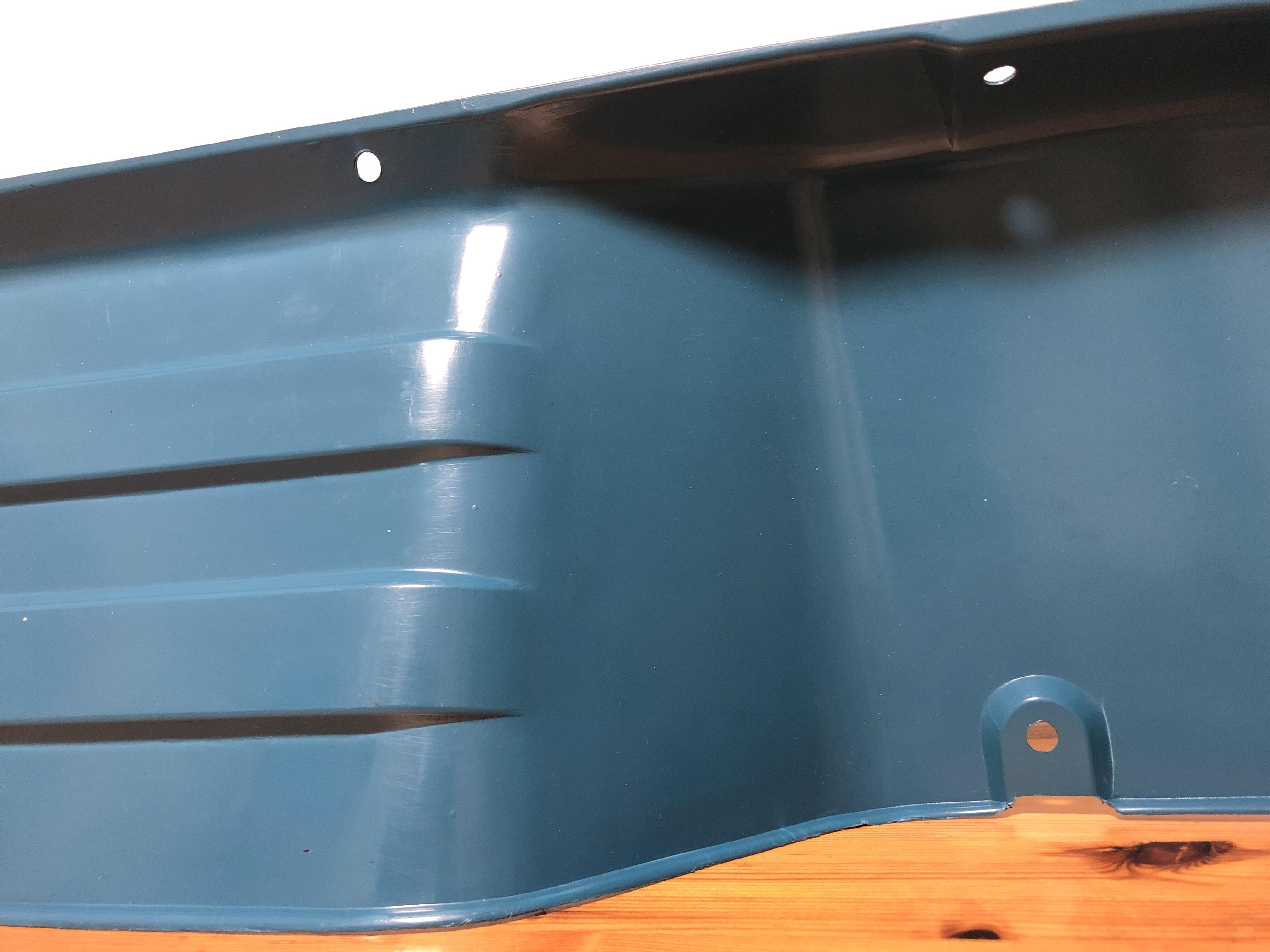

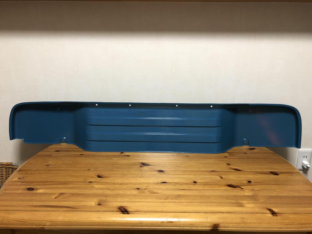

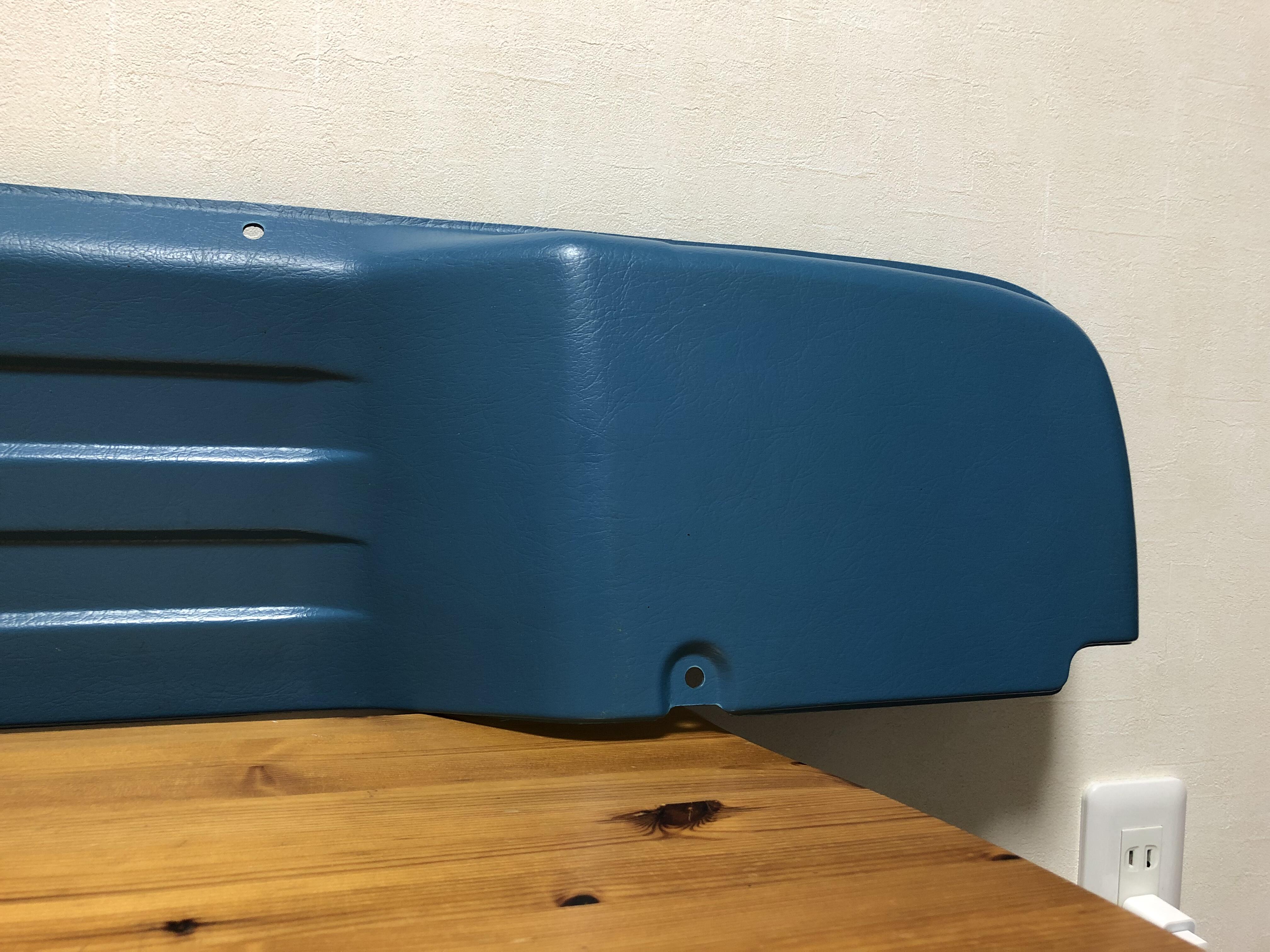

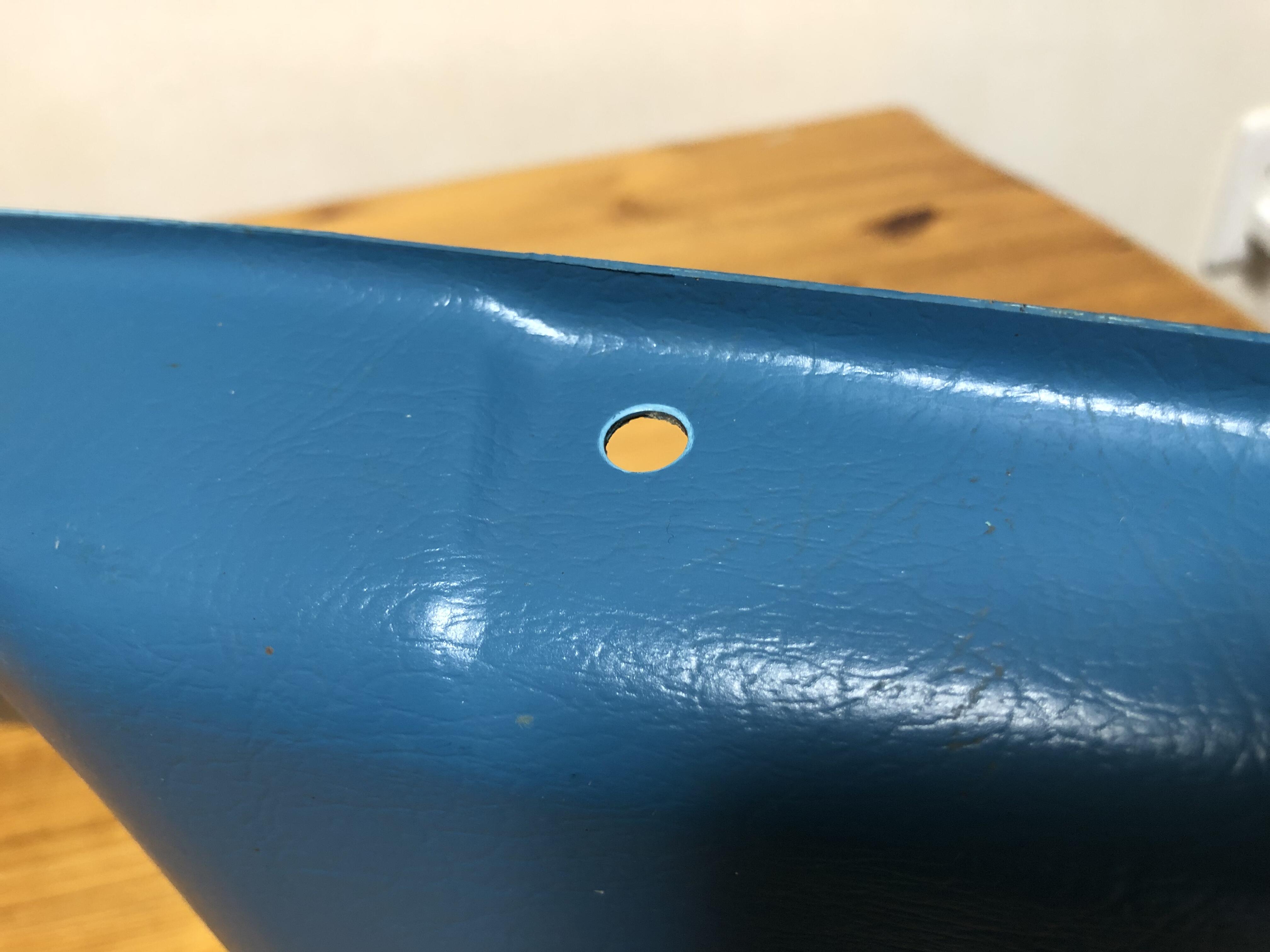

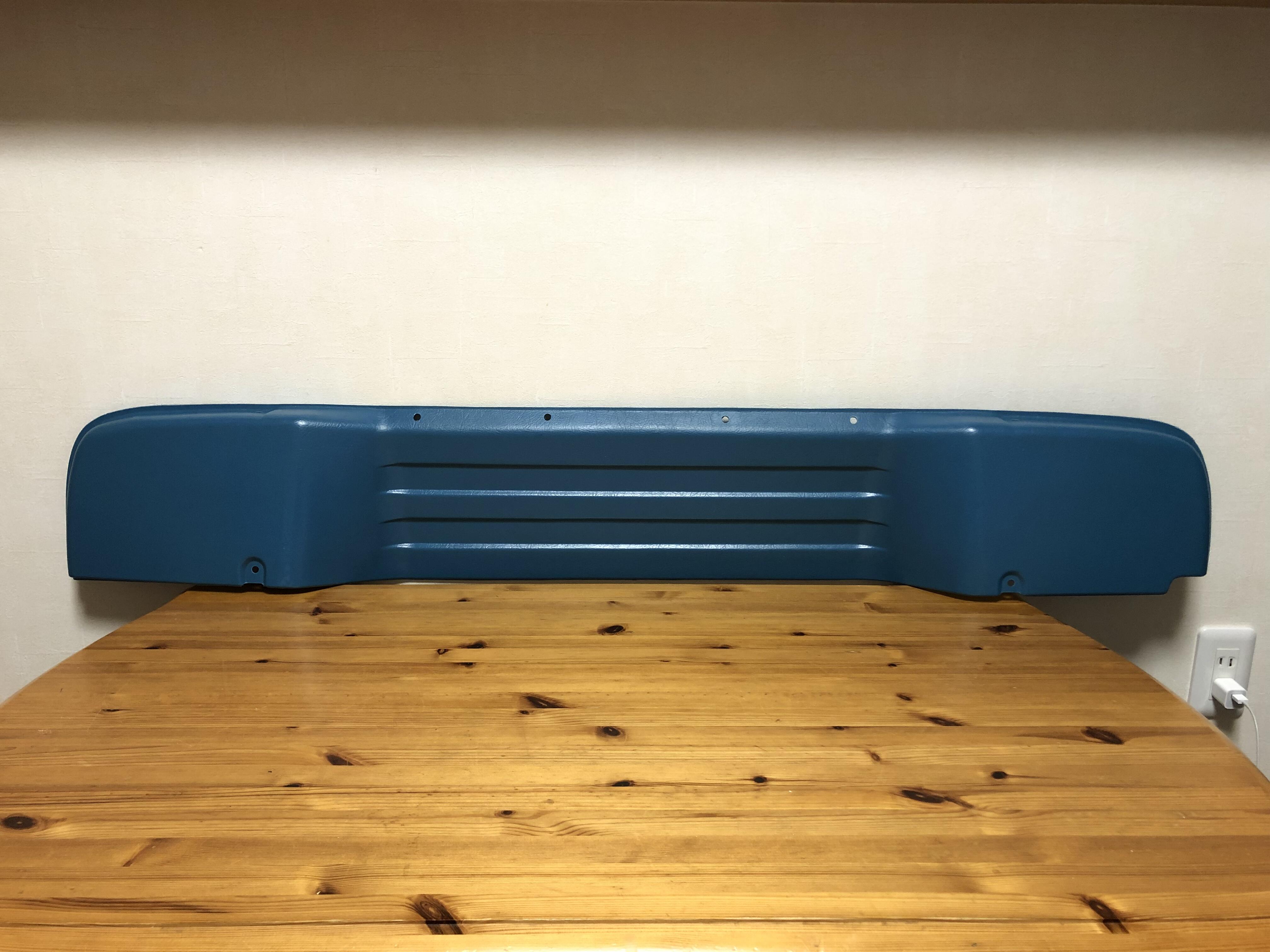

April 2, 20222 yr Author Popular Post comment_638846 Hi , today I would like to show you this , a NOS trim panel for my car . Thanks @SteveE, I appreciate your great help . This piece is now very hard to see in this condition, not only for the early car style ( non-access panel type ) , also this is a blue panel ! I can confirm the real color when blue cars left from the factory . Next time I do some work for my new blue 240Z , I will show you the difference of color between two of them , old and new . I need to work for the car as it deserves this beautiful piece. It will be a long way . Or I will put this on my -2156 until -2146 becomes beautiful. Kats Link to comment https://www.classiczcars.com/forums/topic/23900-datsun-240z-vs-fairlady-z432/?&page=154#findComment-638846 Share on other sites More sharing options...
