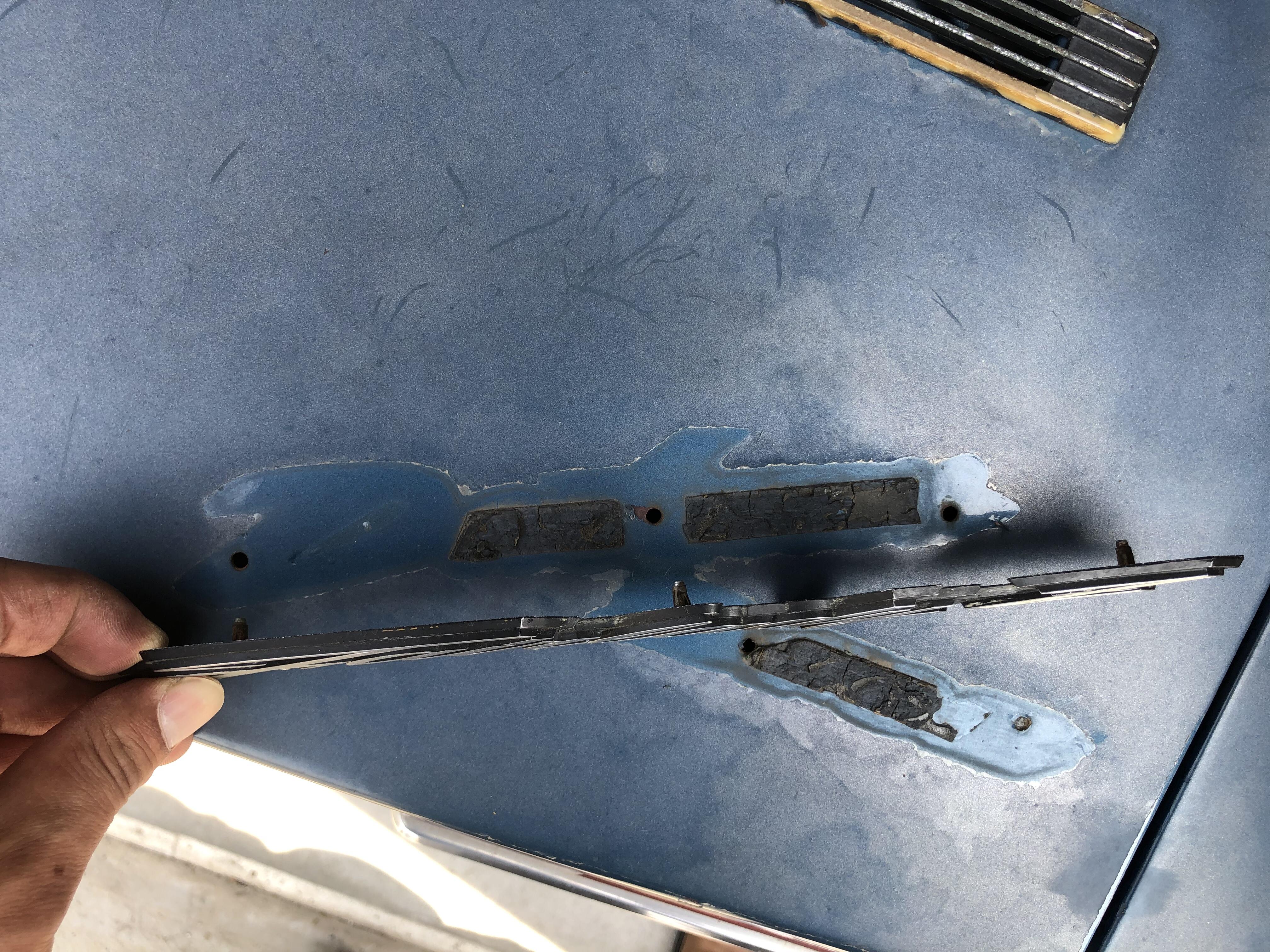

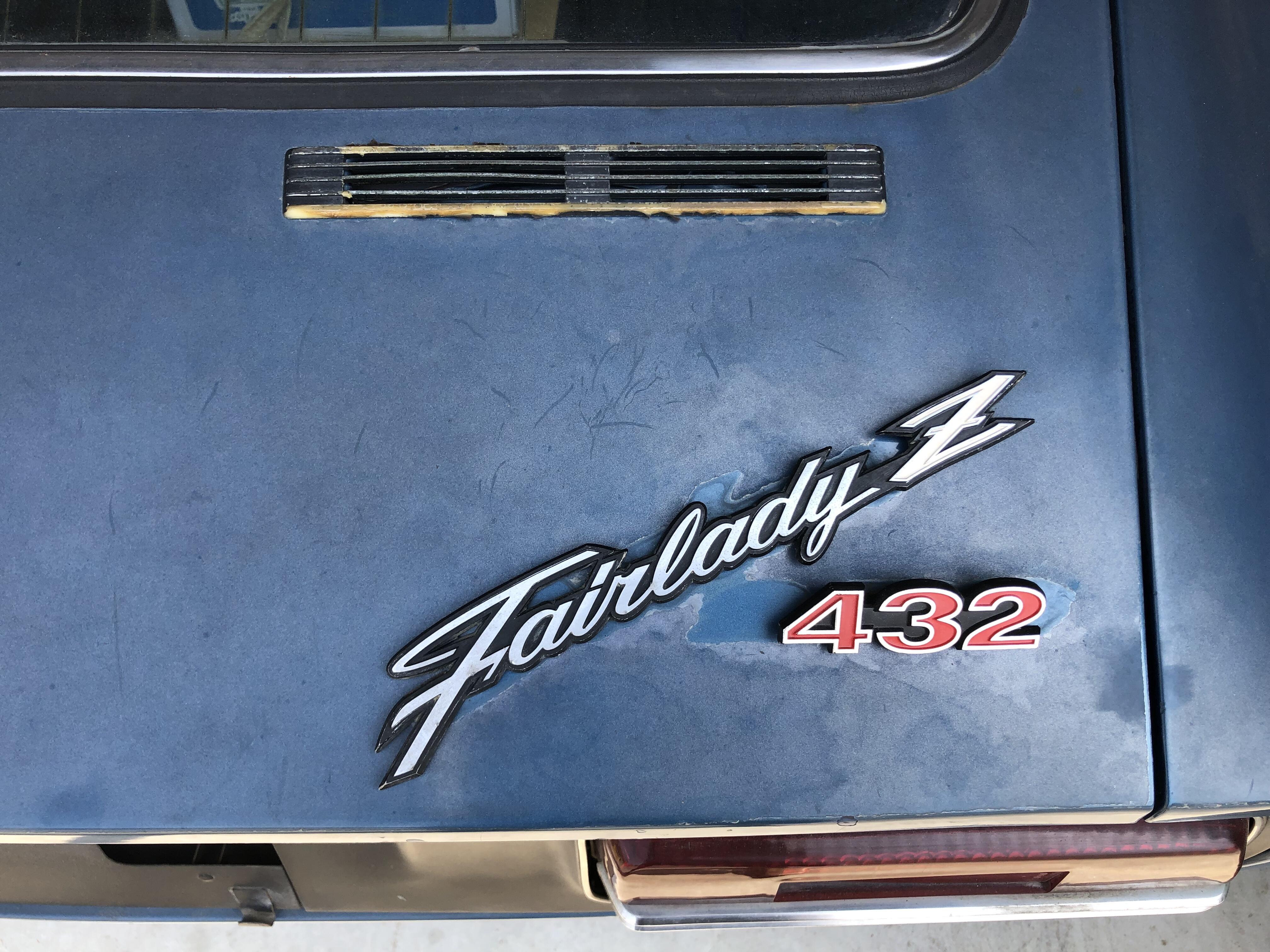

May 28, 20222 yr Author comment_640936 Some work for my second blue 240Z. I wanted to see if Datsun 240Z has the same pin hole for the rear gate emblems . I found three holes for “Datsun “ is almost the same , only the one on far right needs to be more outside for “ Fairlady Z “ . “ 240Z “ pin holes position is exactly the same for the “ 432 “ . Datsun 240Z doesn’t have “ NISSAN “ on the rear gate, so if someone wants to have it , he /she have to measure the original positions then drill the holes. I am not going to put them on , just checked it for my curiosity. Kats Edited May 28, 20222 yr by kats Link to comment https://www.classiczcars.com/forums/topic/23900-datsun-240z-vs-fairlady-z432/?&page=158#findComment-640936 Share on other sites More sharing options...

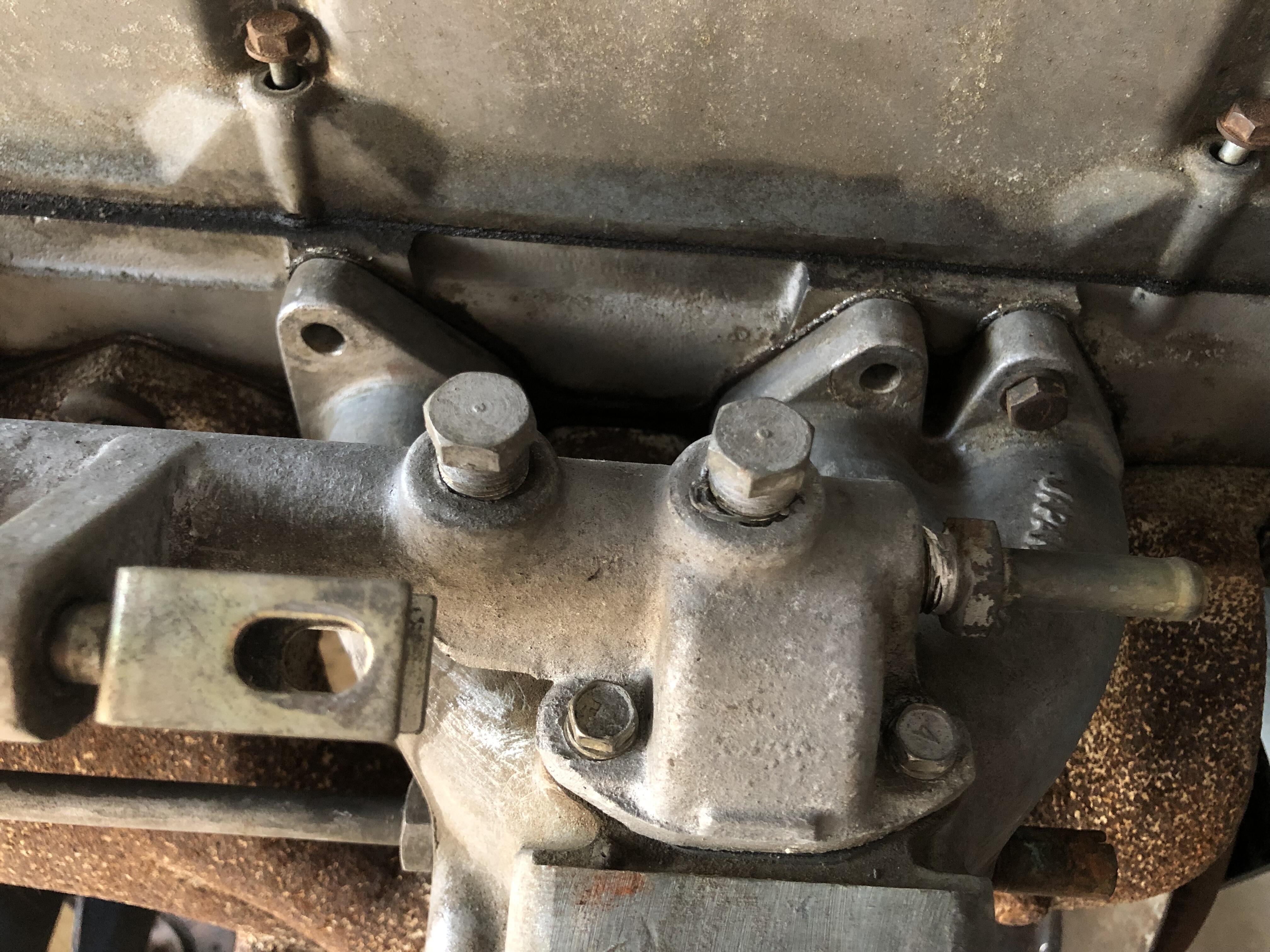

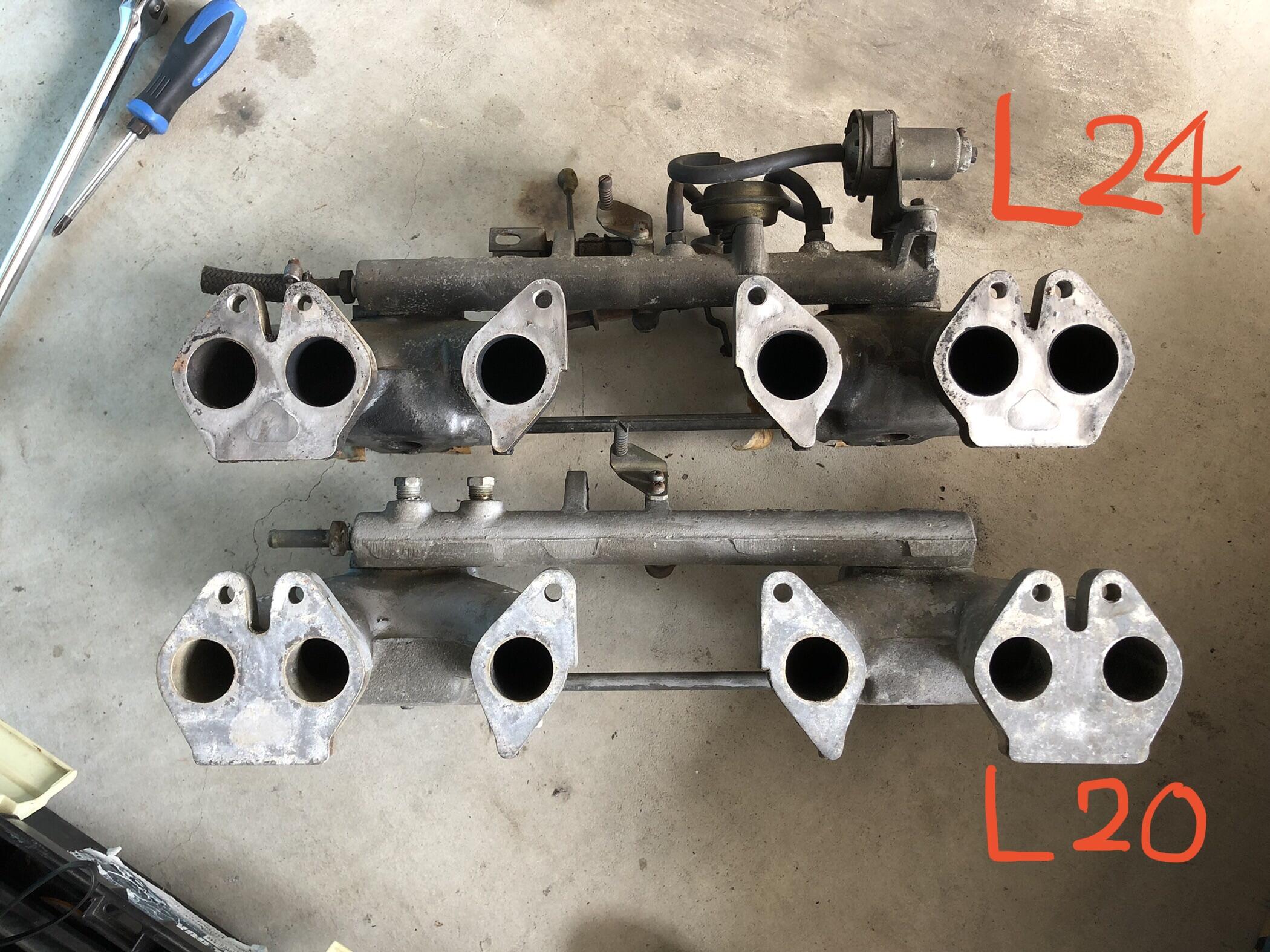

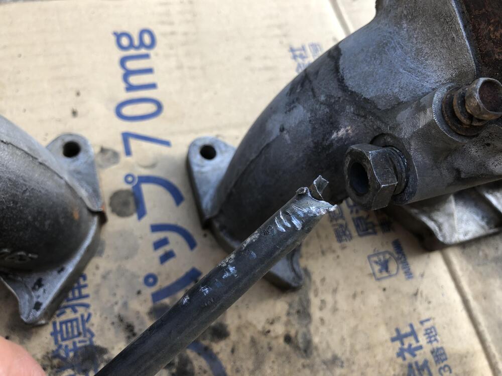

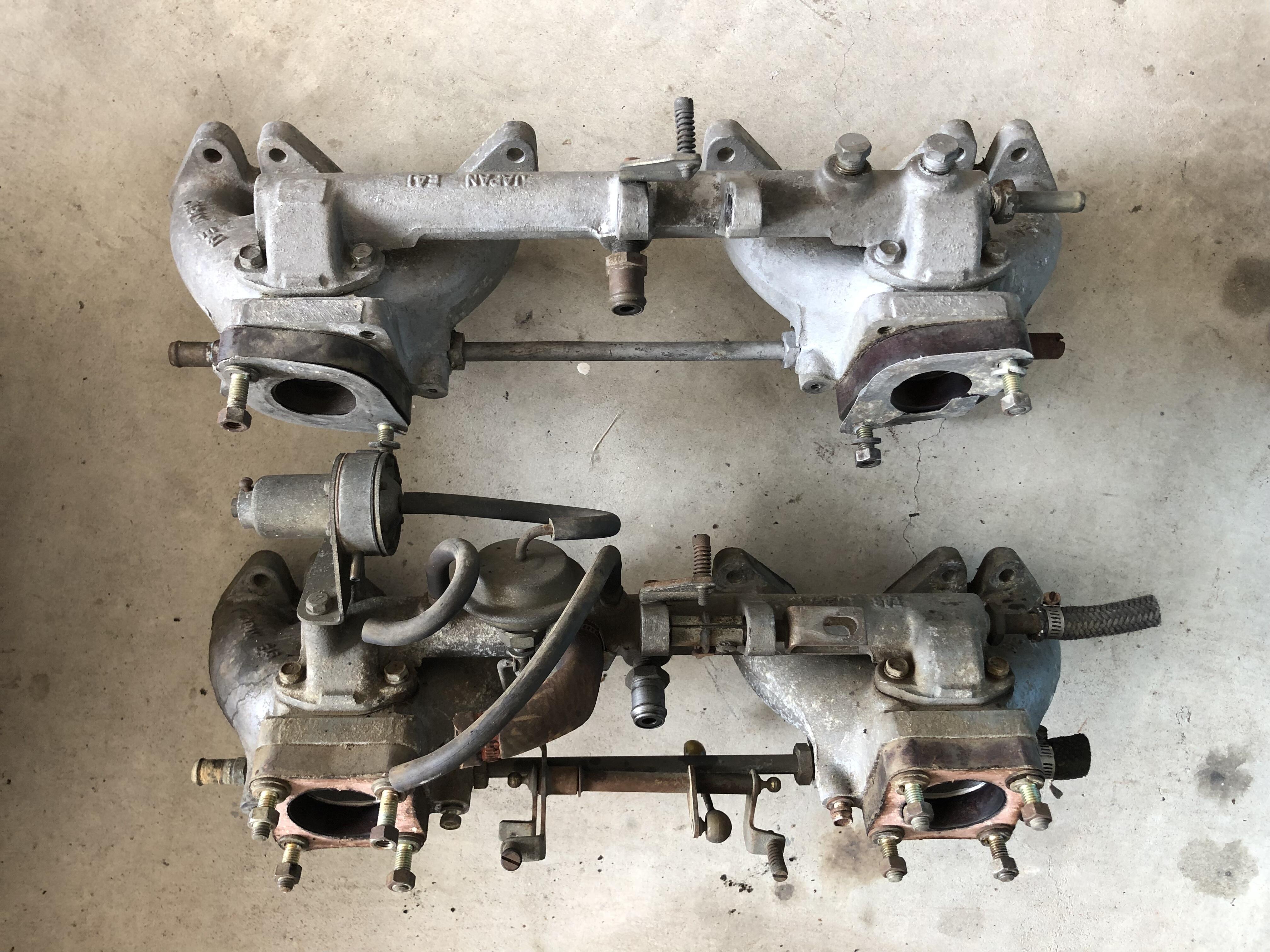

May 28, 20222 yr Author comment_640937 Transition to the non-US intake manifold, I have a donor system which was pulled from a 1972 Fairlady Z (L20 engine model) . I was expecting I only need the balance tube but the water tube of between the two manifolds was so rusty. I decided to replace it with the one from the donor. I snapped the rusty tube , I was lucky the donor is very good. Today I have learned that when assembling the intake manifold, I have to wait final tightening the bolts on the balance tube until the two manifolds are secured . Also I tightened the two nuts for the water tube after the balance tube was secured . As some of you are wondering about the two plugs on the balance tube which are not welcome for my 03/1970 car. I am thinking about it to look just like an early L-series balance tube. Kats Edited May 28, 20222 yr by kats Link to comment https://www.classiczcars.com/forums/topic/23900-datsun-240z-vs-fairlady-z432/?&page=158#findComment-640937 Share on other sites More sharing options...
May 29, 20222 yr comment_640985 Very nice exhaust manifold, Kats. I had the same idea for 26th and installed a 'U98' casting I bought in Australia. It does not have the dimples for the air injection ports - smooth transition. I had it ceramic coated so that it would not rust. Link to comment https://www.classiczcars.com/forums/topic/23900-datsun-240z-vs-fairlady-z432/?&page=158#findComment-640985 Share on other sites More sharing options...
May 31, 20222 yr comment_641076 Does anyone know if you can get replacements for the coolant pipe on the intake manifold? I see you snapped it Kats, as did I on HS30 00150 when I tried to remove it, it was so rusty and fatigued. I don't know if anyone sells replacement parts for them? I've noticed most people block off the coolant running through the intake manifolds. As @26th-Z points out Australian market cars got the clean balance bar and exhaust manifolds from 1970-73. Which looks a lot cleaner. Often mistakingly referred to as "euro" by a lot of Punters. Link to comment https://www.classiczcars.com/forums/topic/23900-datsun-240z-vs-fairlady-z432/?&page=158#findComment-641076 Share on other sites More sharing options...
