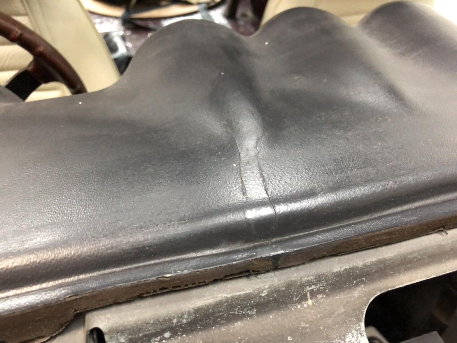

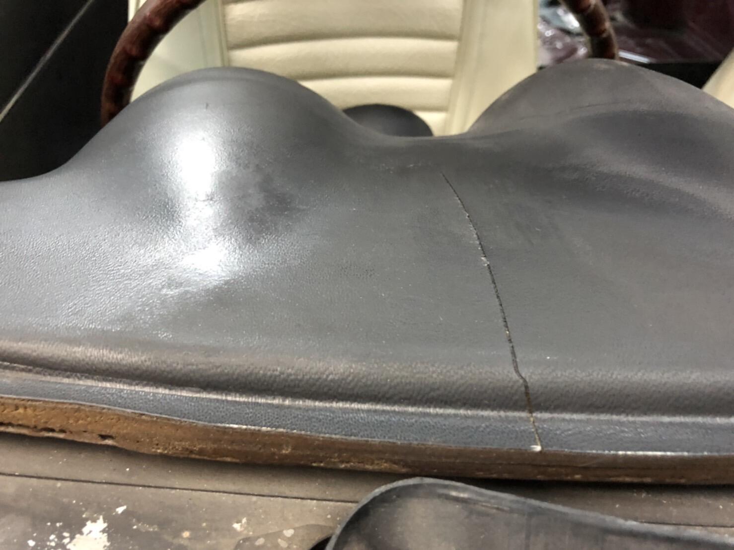

September 17, 20222 yr Author comment_645488 Here is a very interesting dashboard, an original one which has been taken off from a Z432-R . Takeuchi san got new one from local Nissan decades ago ( Nissan had PZR dashboards in their parts center until early year 2000 ) . Takeuchi san said he doesn’t need it , so I have got it .I will repair the two cracks . Or remain as it is for historical exhibitions? Maybe I want to have it clean. Because I will put some Z432-R parts into my Z432 just for fun . I am not aiming ‘wannabe’ car . I would like to have an ultimate both worlds . Luxury GT and Sunday racing . I respect Z432-R , and my Z432 too . Maybe this is for the first time to show the details for everyone here , please enjoy. Kats Link to comment https://www.classiczcars.com/forums/topic/23900-datsun-240z-vs-fairlady-z432/?&page=164#findComment-645488 Share on other sites More sharing options...

September 21, 20222 yr comment_645672 That dash is a nice piece,Kats, to compliment your other nice pieces. I personally think you are on the right track by doing it by hand. The parts that make that dash special are still intact, from what I can tell, and fixing the cracks by hand is imho the primary way you’ll guarantee they stay intact. Edited September 21, 20222 yr by xs10shl Link to comment https://www.classiczcars.com/forums/topic/23900-datsun-240z-vs-fairlady-z432/?&page=164#findComment-645672 Share on other sites More sharing options...
September 22, 20222 yr comment_645689 On 9/18/2022 at 11:02 PM, kats said: I want to have it fixed by my hand , it will be fun and yes a lot of money saving . And I want to remain its details as much as possible , every old originals are one and only! Both options (professional repair vs do-it-yourself) have their good and bad considerations. The do-it-yourself option requires much attention to detail in order to create a good and lasting result. There are two or three good threads available on CZCC that will provide you with a list of recommended tools, materials, and procedures. Based on my own experience, the main limitation is that the final exterior finish -- typically accomplished using texturized 'bed liner' paint -- has 'look' and 'feel' that is different from the original textured vinyl. Although a casual observer would not notice the difference, a knowledgeable person will see it very quickly. I found some upholstery vinyl (long sheet with 1m width) that had a texture very close to the original material used by Nissan. Unfortunately, it was only available with a bonded fabric backing. Despite the use of a heat gun, it would not stretch enough to follow the contours of the S30 dash surface (those contours become quite extreme around the openings for the instrument pods. If you can find a suitable vinyl that does not have a fabric backing, you might be able to achieve a successful result. I look forward to reading about your dash restoration. There may be materials available to you in Japan that we in North America have not discovered. Link to comment https://www.classiczcars.com/forums/topic/23900-datsun-240z-vs-fairlady-z432/?&page=164#findComment-645689 Share on other sites More sharing options...

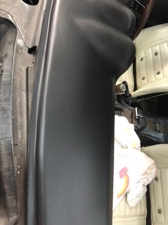

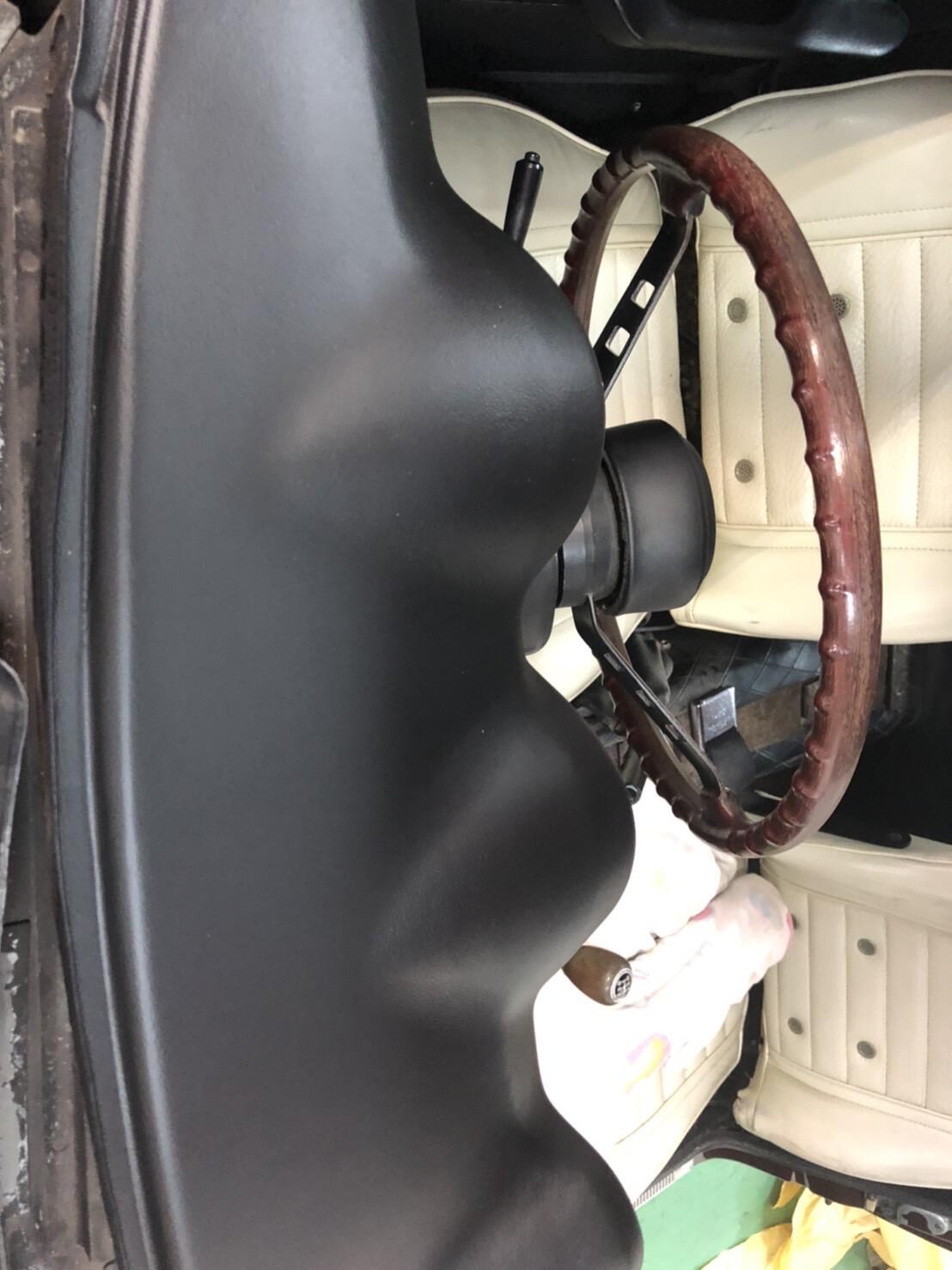

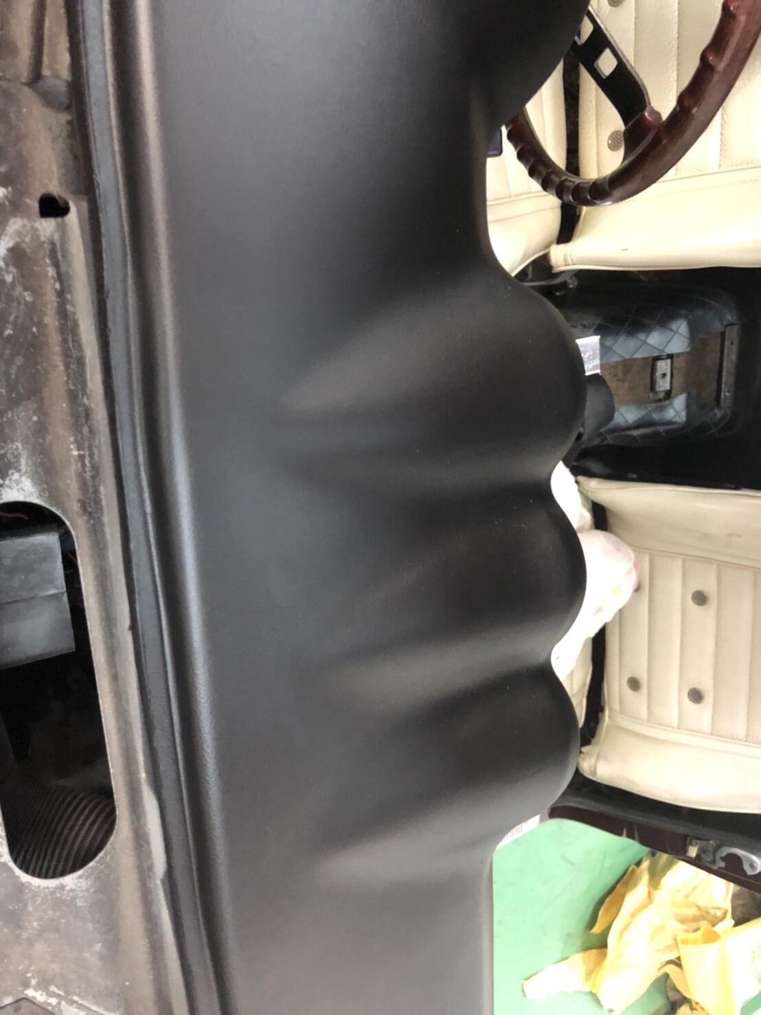

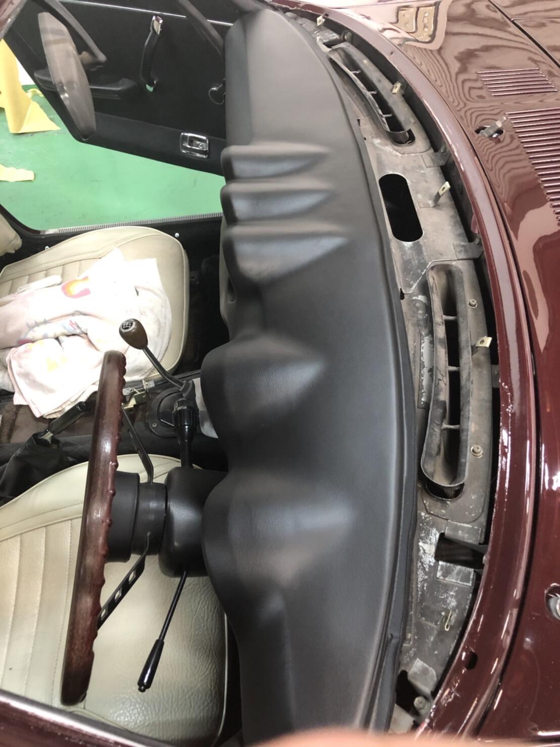

October 13, 20222 yr Author Popular Post comment_646357 Thanks Gavin, xs10shl, Namerow, I will think and think before starting the repair job . A good thing is I have a very bad 240Z dashboard to start with , I can do anything and no worries if I do stupid things. Here is an example which was repaired recently by Tasaka san . He is offering to teach me how to. But as Tasaka san said , he is still learning and seeking what is better and this example is just a test bed. We have to wait until we see something happens on the surface . Or hopefully don’t see any defects after passing one year, two years, and more , that will be wonderful. Kats Edited October 13, 20222 yr by kats Link to comment https://www.classiczcars.com/forums/topic/23900-datsun-240z-vs-fairlady-z432/?&page=164#findComment-646357 Share on other sites More sharing options...
