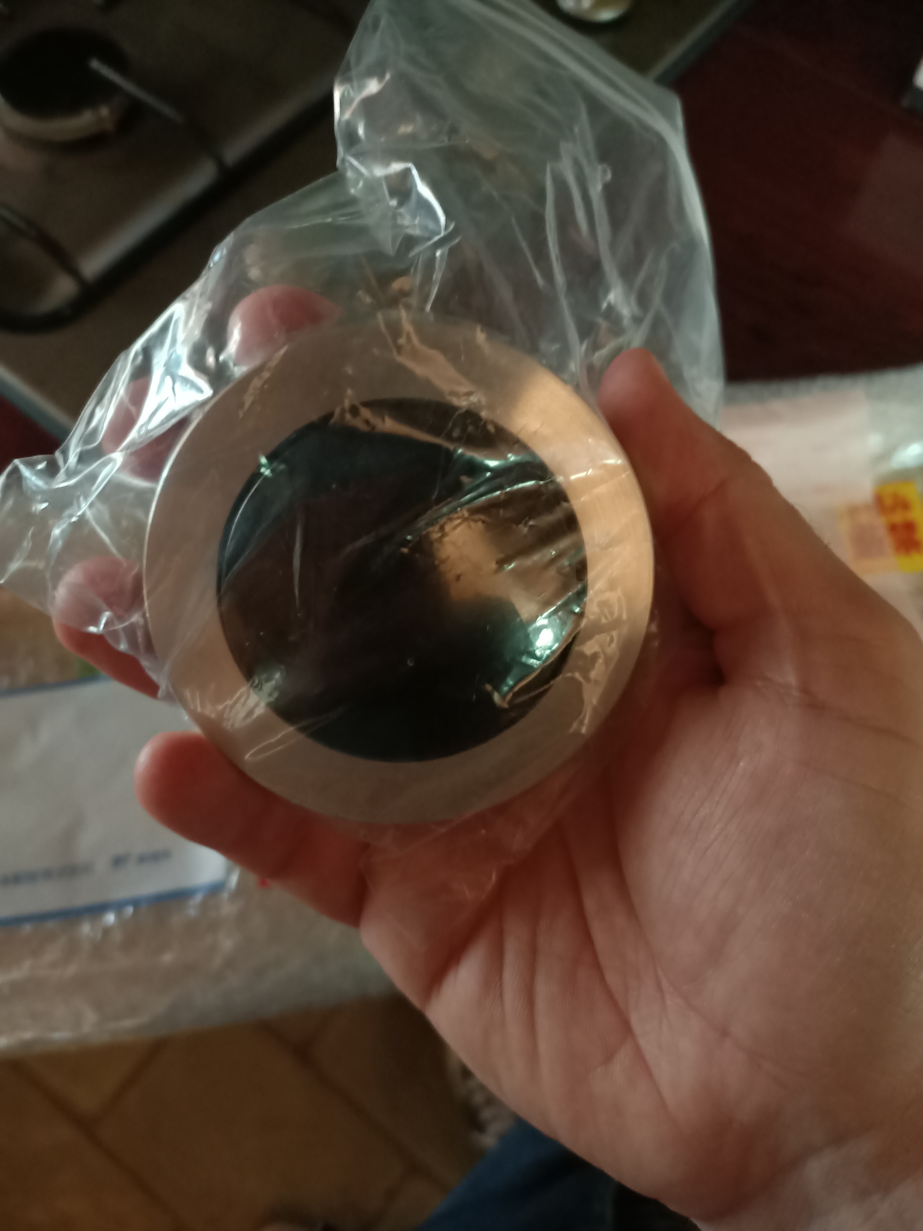

December 19, 20222 yr comment_648422 On 9/17/2022 at 4:16 AM, kats said: I have been sourcing sports option parts for my Z432. Pistons and other engine parts as well as tachometer, seats , steering wheel , etc. Some of them were hand crafted to replicate using a genuine parts as a donor. Put the parts for track , remove them for daily use . I've got the same addiction. I just noticed however your black Ura Mach Wheel has a transparent looking horn button? I recently won a horn button for my black Ura Mach Wheel on Yahoo! auctions but it has a black horn button. Did the black wheels get transparent buttons? Also do you know anyone selling the hub adaptors for these wheels? I recall I found a website in Japan ages ago selling parts for these wheels, but I think they said they had stopped production.. Link to comment https://www.classiczcars.com/forums/topic/23900-datsun-240z-vs-fairlady-z432/?&page=166#findComment-648422 Share on other sites More sharing options...
