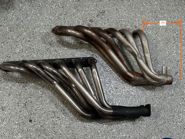

April 5, 20231 yr comment_652187 Today's puzzle. I have two s20 exhaust manifolds, which to my eye appear to be meant for the C10 GTR models. One of them has been shortened, i'm guessing for use in a Z432. Since I don't have an original-looking Z432 S20 exhaust manifold on my Z432, I thought it would be a suitable exercise to get this manifold re-flanged for use in a Z432. At the same time, I'd replace the one section of pipe that has somehow been squashed. Not entirely sure of the origin of these manifolds. Any thoughts as to where they might have come from? The pipes appear to be stainless. The cut unit appears to have a custom mounting bracket, which I'm guessing by it's position was mounted onto a custom bracket off of the bell housing/rear of engine block. The bracket does not appear to be aligned with anything I can see on my cars. What I'd like to know is the horizontal distance between the last bolt-hole on the exhaust port and the exhaust pipe flange. In other words, how far back from the rear-most bolt hole is the flange located, in order to properly bolt up to a standard exhaust setup? If anyone has a part that's out of the car (even an aftermarket bolt-up part will hopefully have the same dimension) this would be a straightforward exercise, and I'd be grateful. Edited April 5, 20231 yr by xs10shl Link to comment https://www.classiczcars.com/forums/topic/23900-datsun-240z-vs-fairlady-z432/?&page=169#findComment-652187 Share on other sites More sharing options...
April 5, 20231 yr comment_652188 25 minutes ago, xs10shl said: What I'd like to know is the horizontal distance between the last bolt-hole on the exhaust port and the exhaust pipe flange. In other words, how far back from the rear-most bolt hole is the flange located, in order to properly bolt up to a standard exhaust setup? If anyone has a part that's out of the car (even an aftermarket bolt-up part will hopefully have the same dimension) this would be a straightforward exercise, and I'd be grateful. I've got an OEM exhaust manifold from an early 1970 432 hanging on the wall in one of my garages. I can measure it for you tomorrow. Link to comment https://www.classiczcars.com/forums/topic/23900-datsun-240z-vs-fairlady-z432/?&page=169#findComment-652188 Share on other sites More sharing options...

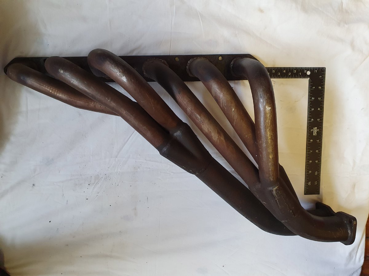

April 6, 20231 yr comment_652204 Here's my early 1970 PS30-type S20 OEM exhaust manifold and the dimensions from the centre of the rearmost hole in the mounting flange horizontal to a 90 degree line from the mounting face of the 'binocular' flange and the centre of its innermost bolt hole (does that make sense?). Anyway, pictures saving words: Link to comment https://www.classiczcars.com/forums/topic/23900-datsun-240z-vs-fairlady-z432/?&page=169#findComment-652204 Share on other sites More sharing options...
April 6, 20231 yr comment_652205 Hope that helps. Happy to take any other measurements/photos if required. 13 hours ago, xs10shl said: Not entirely sure of the origin of these manifolds. Any thoughts as to where they might have come from? The pipes appear to be stainless. The cut unit appears to have a custom mounting bracket, which I'm guessing by it's position was mounted onto a custom bracket off of the bell housing/rear of engine block. The bracket does not appear to be aligned with anything I can see on my cars. Can't help with any identifications here I'm afraid, although I have seen brackets in that area on C10-series GTR-specific aftermarket manifolds in the past, bracing them to the bellhousing. Actually I have seen many, many aftermarket exhaust manifolds for these engines. Some of them were one-offs or made in really small batches. The ex manifold on my KPGC10 was made by a race car builder called 'Ito Racing' specifically for the car in the late 1970s, and was beautifully made in the old school sand-filled hand-bending method. It would have been almost impossible to identify without the knowledge passed-on by the previous owner, who commissioned it. Link to comment https://www.classiczcars.com/forums/topic/23900-datsun-240z-vs-fairlady-z432/?&page=169#findComment-652205 Share on other sites More sharing options...
April 6, 20231 yr comment_652209 2 hours ago, HS30-H said: Hope that helps. Happy to take any other measurements/photos if required. Yes, this is perfect!. Many thanks! I'll use this to give the fab guys something to go by. Edited April 6, 20231 yr by xs10shl Link to comment https://www.classiczcars.com/forums/topic/23900-datsun-240z-vs-fairlady-z432/?&page=169#findComment-652209 Share on other sites More sharing options...
