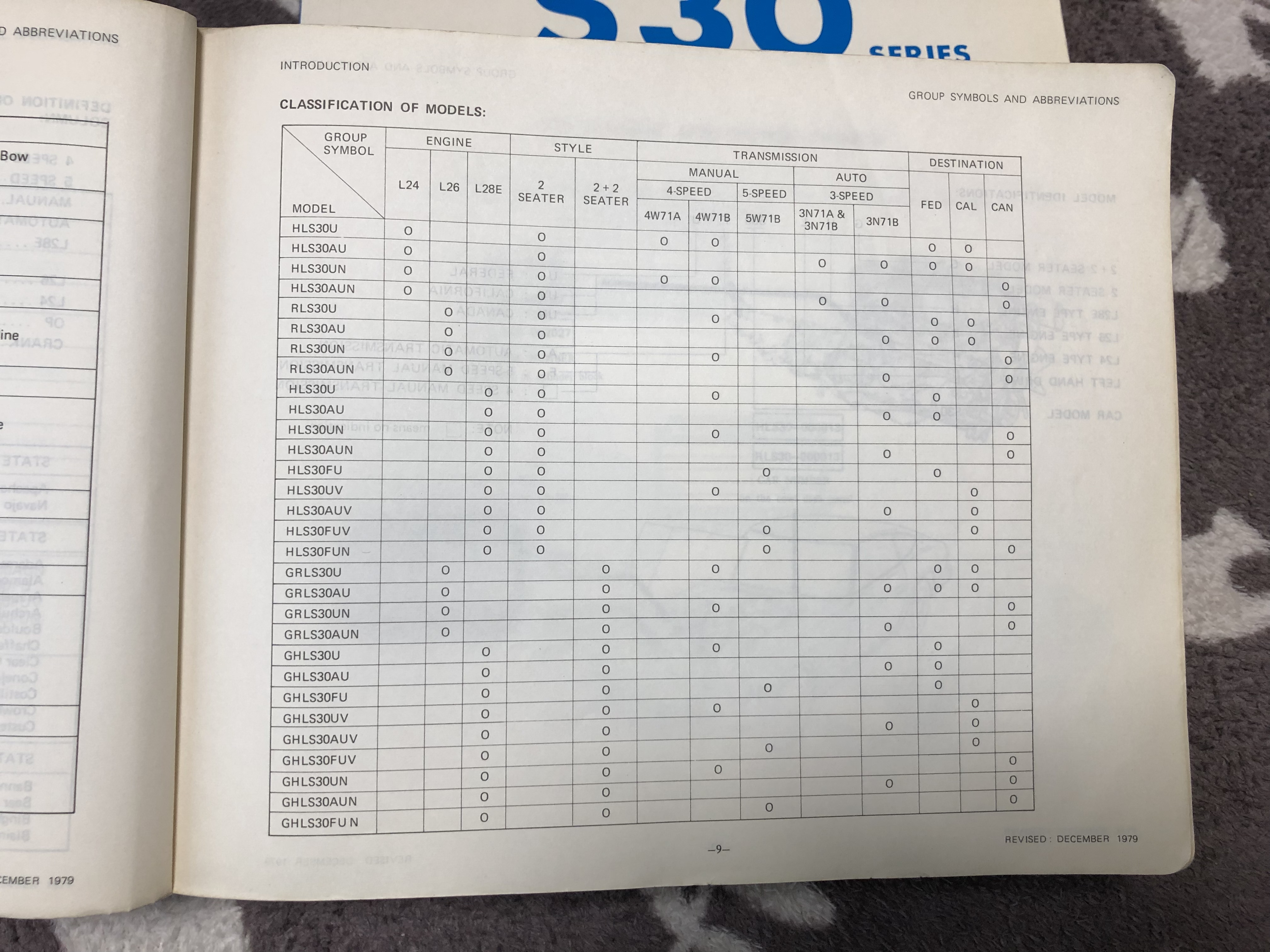

Today I finished my homework,
summary of transmissions.
For S30 series
[F4W71A]
3.549 2.197 1.420 1.00 3.164
All except Europe and AUS
(optional for HS30)
Oct 1969 to Aug 1971
Sleeve type
[FS5C71A]
2.957 1.858 1.311 1.00 0.852 2.922
JPN(S30 HS30 PS30), EUROPE, AUS
Oct 1969 to Dec 1971
Flange type

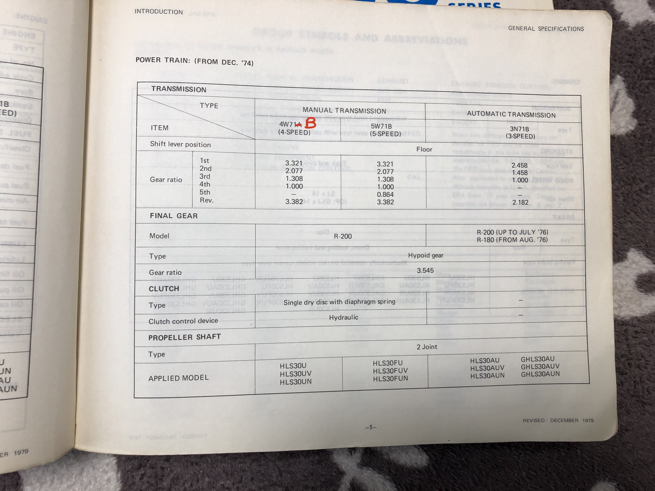

[F4W71B]
3.592 2.246 1.415 1.000 3.657
JPN (S30S GS30S S31S GS31S)
Sep 1971 to Jun 1978
US & CANADA
Sep 1971 to Nov 1974
Sleeve type
3.321 2.077 1.308 1.000 3.382
US & CANADA
Dec 1974 to Jun 1978
Sleeve type

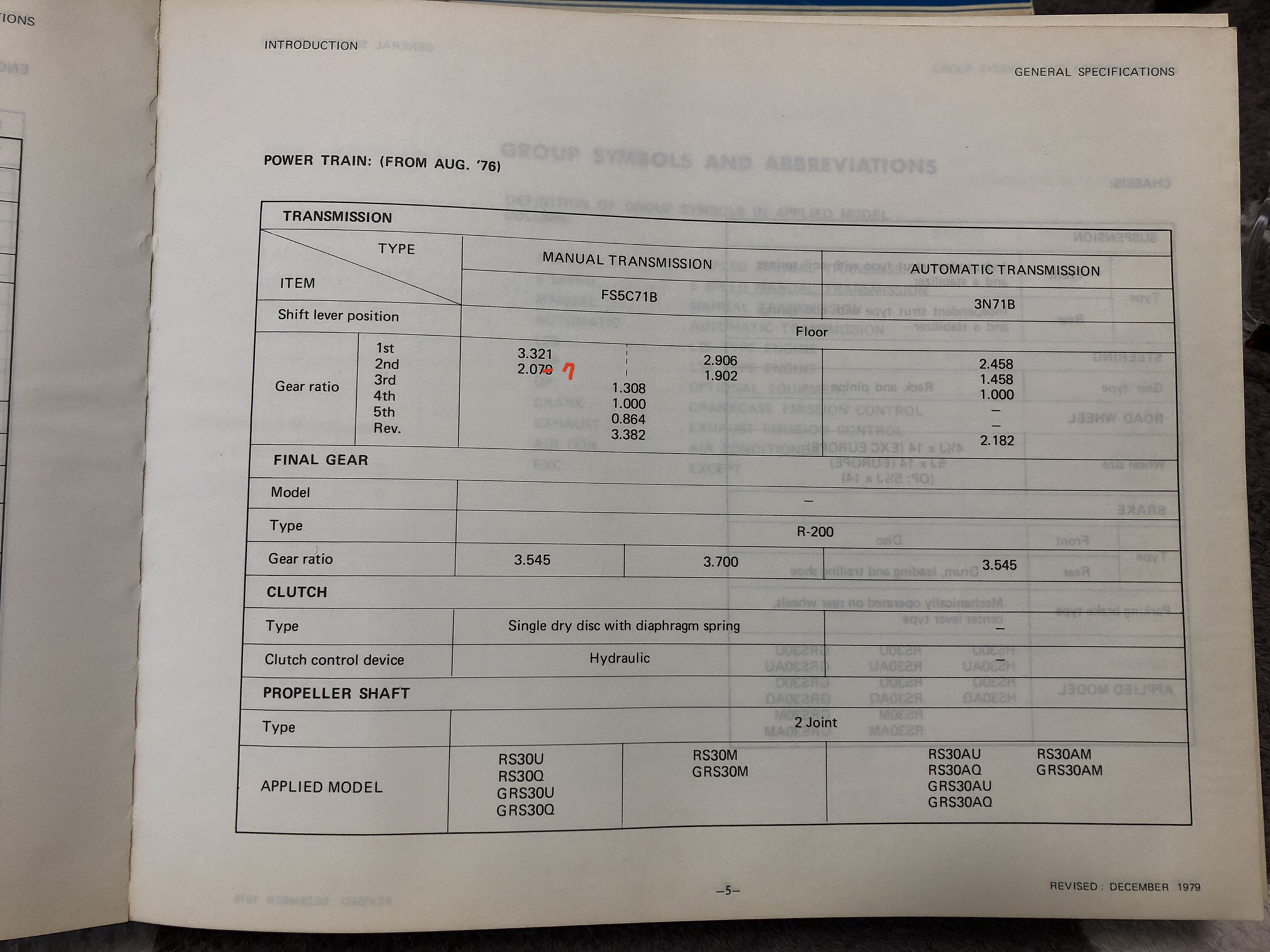

[FS5C71B]
2.906 1.902 1.308 1.000 0.864 3.382
JPN(HS30 PS30)
Jan 1972 to Aug 1973
Europe
Jan 1972 to Jul 1976
AUS
Jan 1972 to Jun 1978
Flange type (up to Aug 1972)
Sleeve type (from Sep 1972)
3.321 2.077 1.308 1.000 0.864 3.382
JPN (S30 S31)
Europe
Aug 1976 to Jun 1978
[FS5W71B]
US & CANADA
Sleeve type
Anyone can add or correct if you find something needed.
Even the factory manuals have some errors!

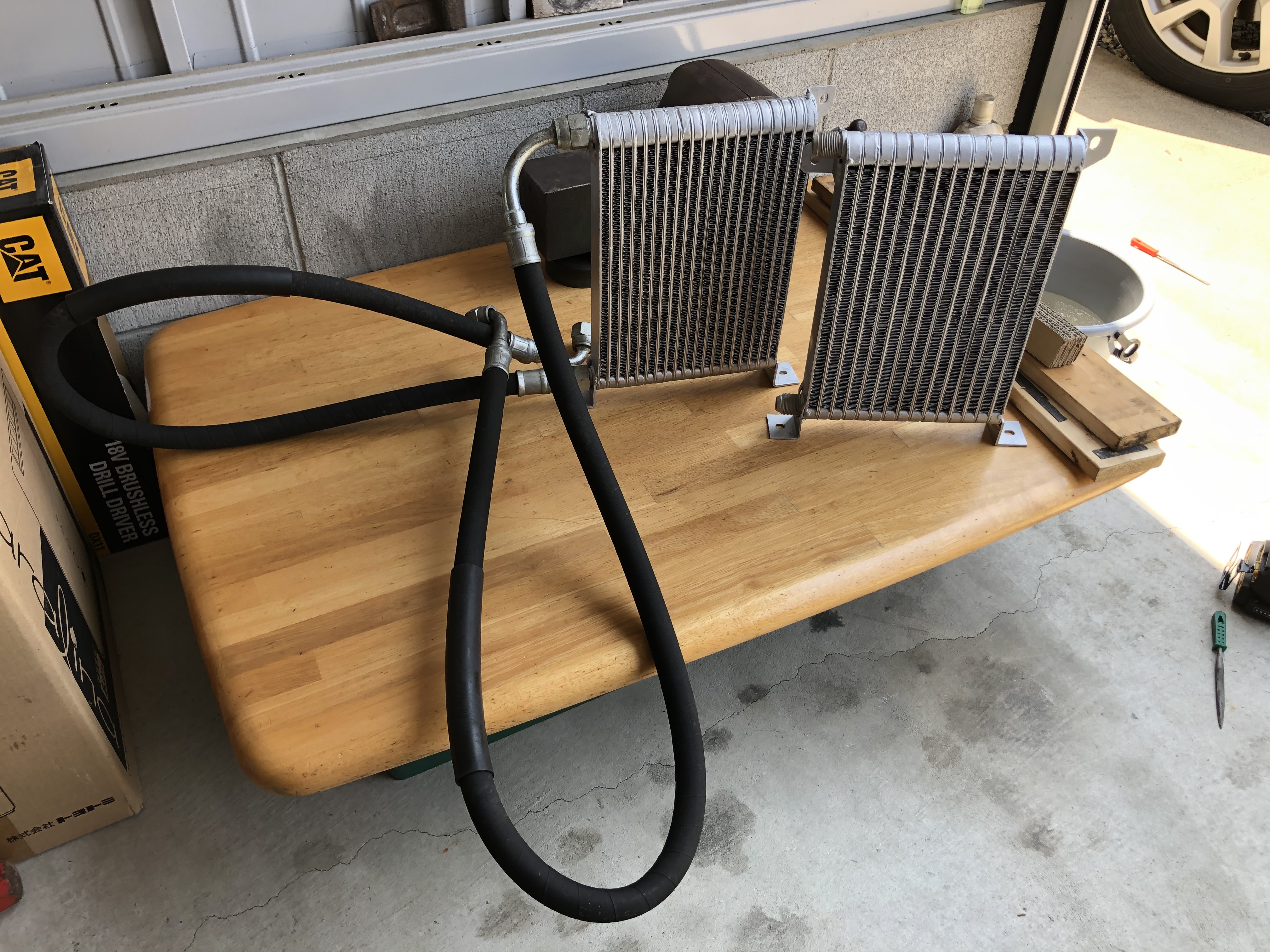

Here is my oil cooler for my Z432.(they are not for sale, the one on sale is a different one )
I have found there are two different types. The one has 18 cores while the other has 14 cores. Which one is older? I have seen 18 version was used on some works Z432, but haven’t seen 14 version yet.
Maybe works rally car has both types?
Kats
Nice parts Kats!
I'm not sure which is the best way to count the cores? Do you count the sections (cores?) or the joints? I would suggest the sections are the actual cores?
I can't remember how many sections are on the two 432-R coolers I've got, but I'll count them. I also have a Works 240Z rally cooler and I count 19 sections (cores?). Here it is in period, still attached to the (heavily crashed) car that it came from, one of the 1973 Monte Carlo Rallye cars, built in 1972:

A core is the galley by which the oil flows through.  At first, I noticed a difference between the top brackets.  One side mount and another top mount, as you show, Alan.  But I see both side and top on the 18 core cooler, so...
