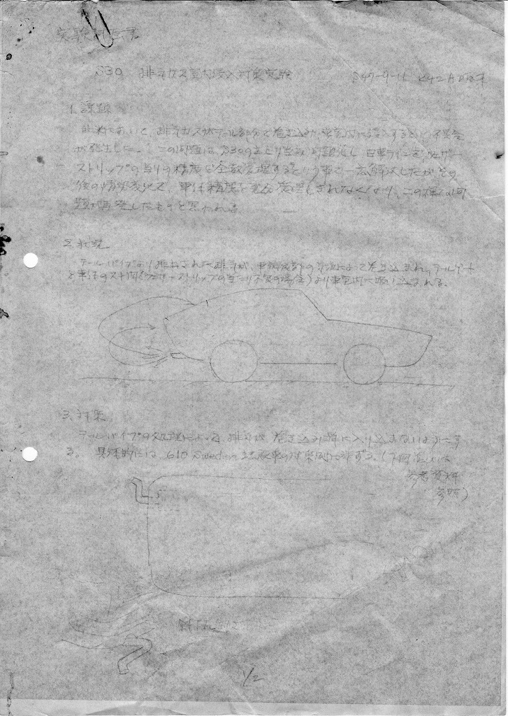

Hi,
I have been thinking up load these test reports from a gentleman who worked Nissan as a member of test drive section.
I think it is a good idea to show these before I turn to be unable do it.
Details will be available later I hope.
#1, PS30(Z432) performance report ( From 25th Feb 1970 to 14th Mar 1970)
#2, Avoidance of Exhaust gas entering in a cabin (11th Sep 1972)
#3, Improvement of stability at high speed cruising for HLS30Q for Europe
(from Feb 1970 to 27th Mar 1971)
kats
