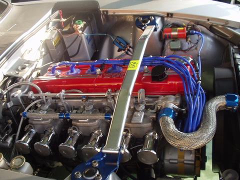

Hi,
I did these in a week,
Replaced wheel nut Z432 original, -E4201
Replaced heter hose long to cloth braided
Replaced choke cable rubber grommet(used to I put throttle linkage grommet)
kats
Edited by kats

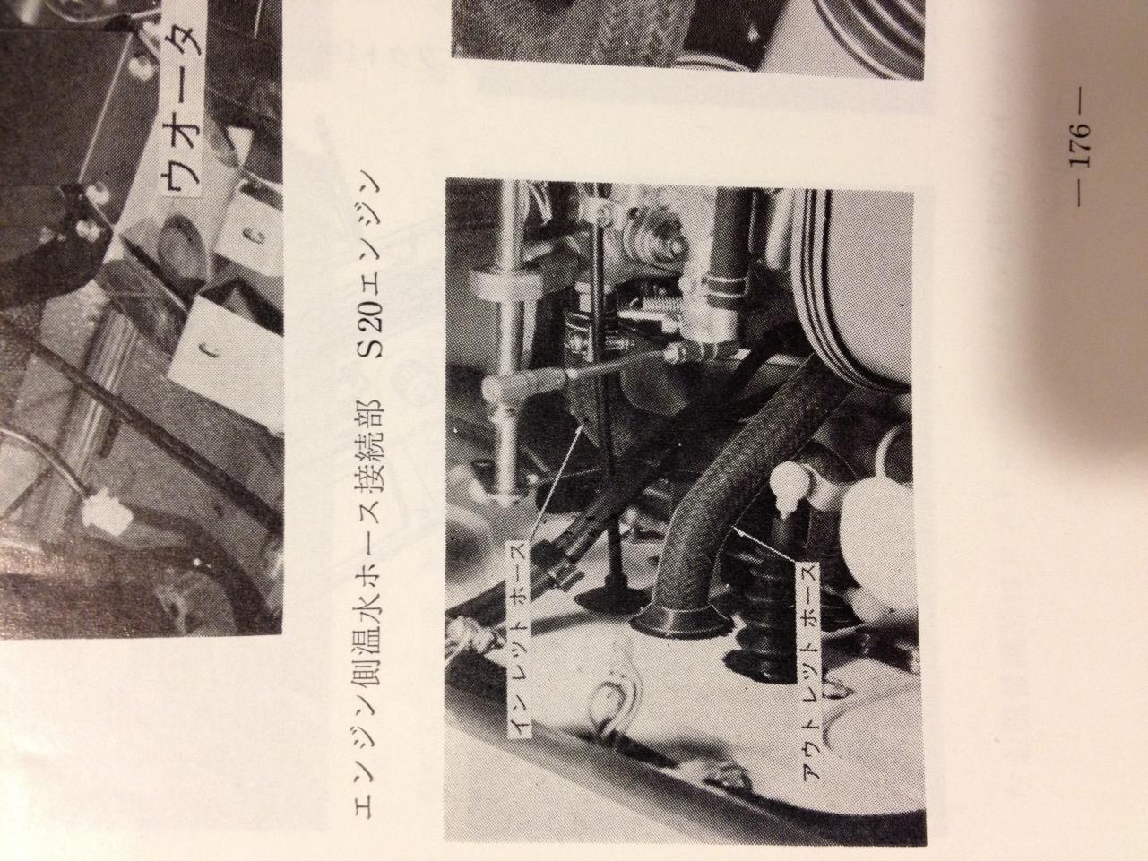

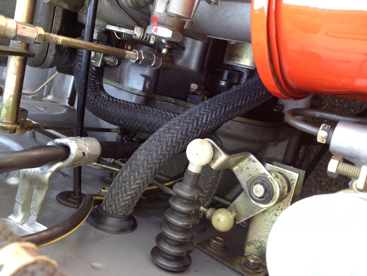

Hi,
I changed long heater hose to cloth braided but I realized my mistake,
Heater hose from manifold (intake to the heater core )
should go through under the hose to water pump (out from the heater core).
Also I organized battery cable to be looked it should be.
kats

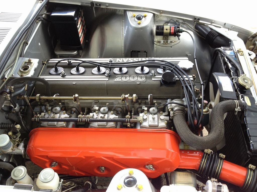

I think this car could be PS30-00009
used as a example for the service manual.
Please see this car does not have a bracket for the battery cable
,just there is a clip you can see on the cables.
This car also has unusual clamp for the brake and fuel line.
We know the existing lowest chassis number for Z432 is PS30-00011
,I am curious to see the car and want to check if the car has same unique
parts like PS30-00009.
