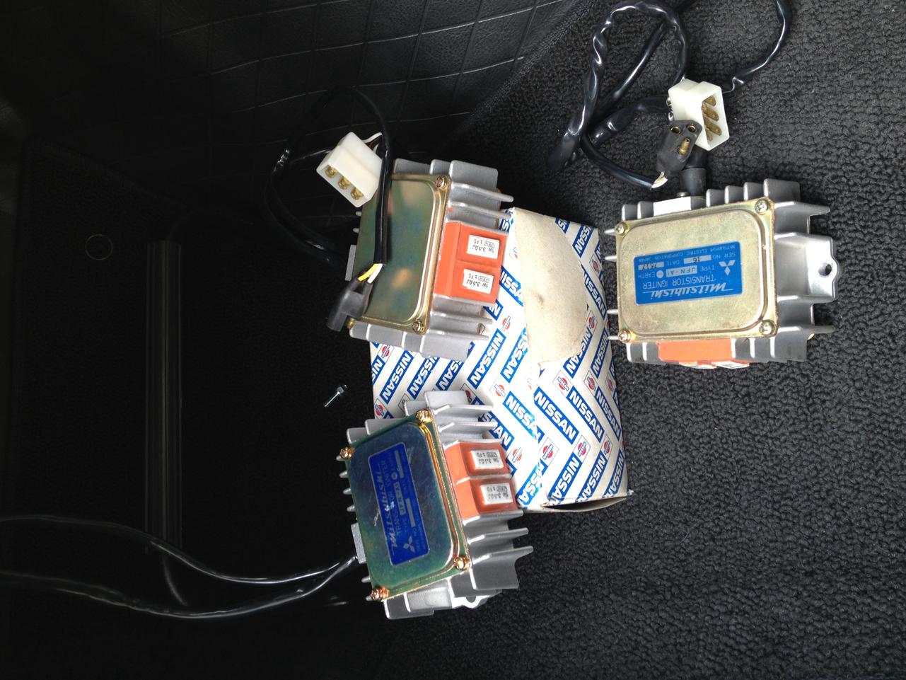

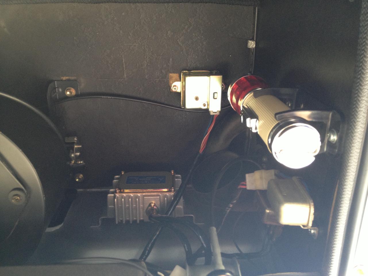

August 29, 201410 yr Author comment_454330 Hi, I just want to show this, the location of the transistor ignitor box. Skyline GTR has the box near the radiator, it is not good idea because it is very easy to have water and moisture. Many GTR owners have the problem then they modify entire ignition system and its location. And the horn relay,Passing light relay avobe the emergency frasher. The gold box is an oscillator. Kats Edited August 29, 201410 yr by kats Link to comment https://www.classiczcars.com/forums/topic/23900-datsun-240z-vs-fairlady-z432/?&page=42#findComment-454330 Share on other sites More sharing options...

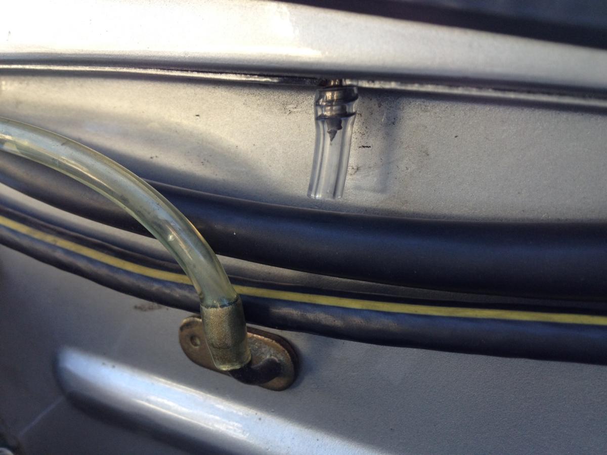

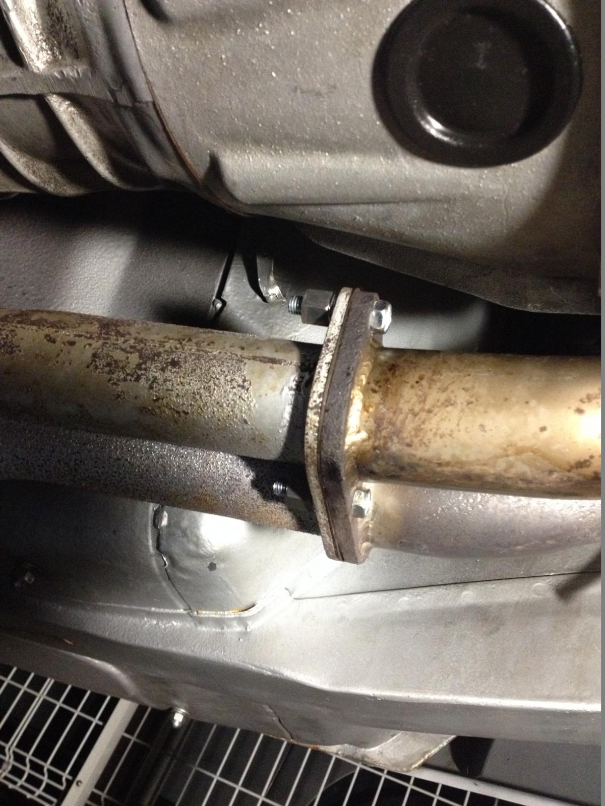

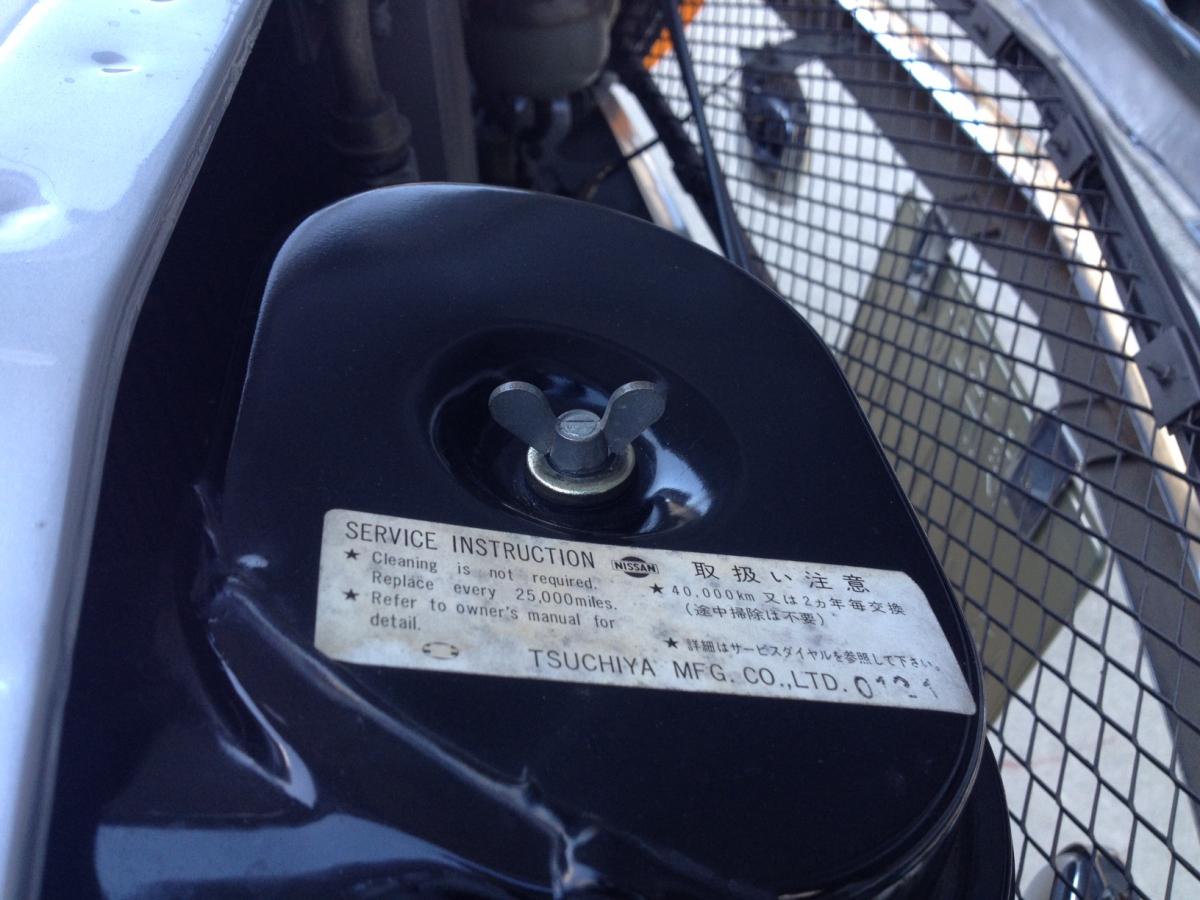

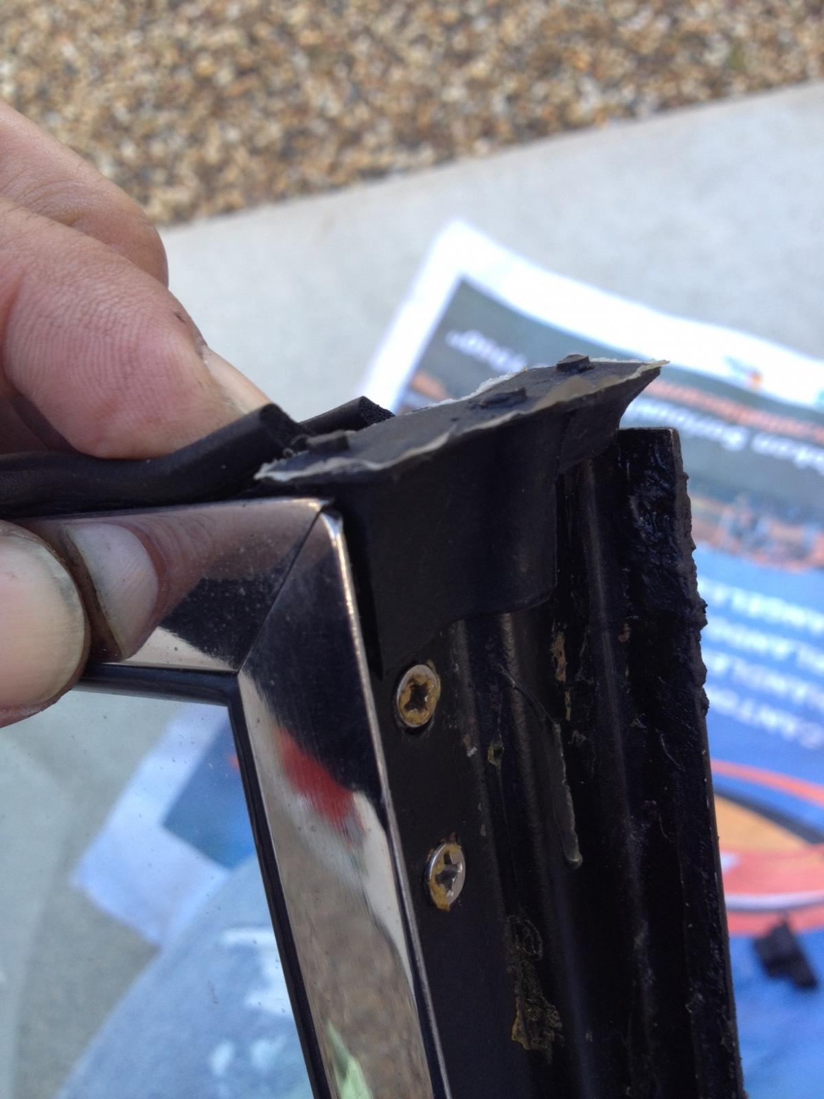

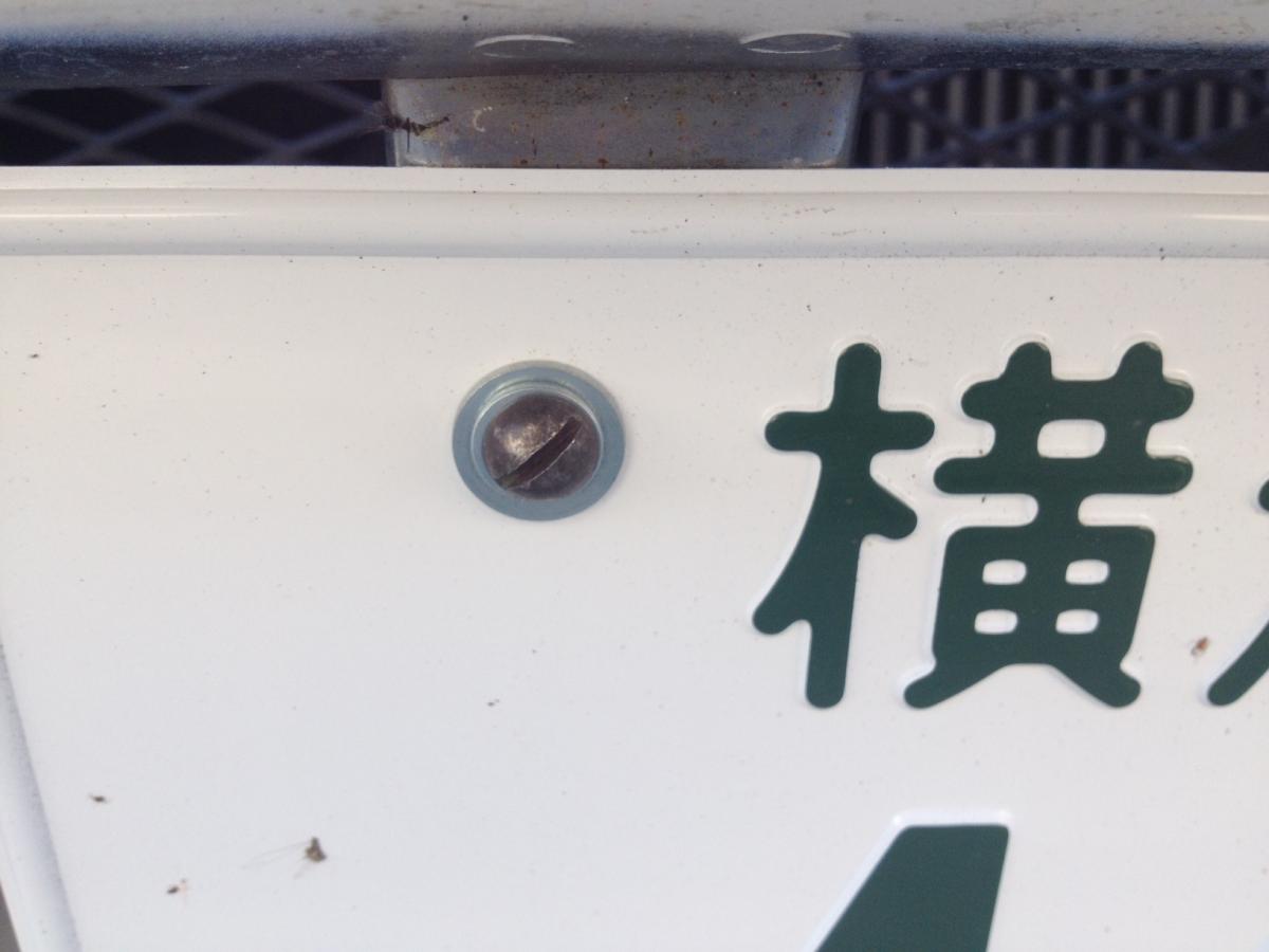

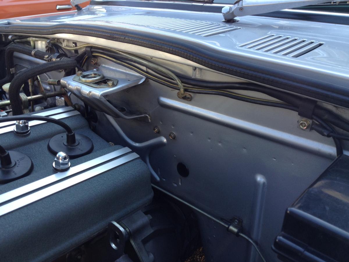

November 27, 201410 yr Author comment_459346 Hi, my Z432 came back home safely in late September. I am very happy the car had no scratch and no mechanical damage. After receaving my car I took my car to the photo studio right away. My Z432 wil be on a top cover "Nostalgic Hero" coming on Mar. 1st. I recently did small things that I was not able to finish before the ZCON. They are, #1 replacing door weather strips to E4100, I had later ones which I did not like the shape. #2 replacing correct old style butterfly wing bolt for the air cleaner box in front of the radiator.Looks like "micky mouse" #3 organize battery cables correctly using clips on the fire wall. #4 added vinyl tubes for the cowl top screws like factory instaled to prevent damge the cables and short circuit. #5 added rubber pieces on the top edge of the quater glasses.My car was missing them when I bought. #6 replacing exhaust bolts and nuts to S20 correct ones. #7 I found old licence plate bolts used in Japan back in 60's and 70's.They were in the tool box and could be used for my father's car when I was a kid. #8 Changed pilot jets from 55 to 57.5 this gives good torque and feelings. Now 180/135/57.5 for my Mikuni 40. I should have done these before the ZCON! Kats Link to comment https://www.classiczcars.com/forums/topic/23900-datsun-240z-vs-fairlady-z432/?&page=42#findComment-459346 Share on other sites More sharing options...

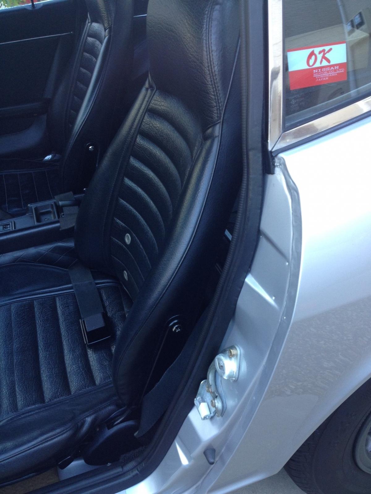

December 8, 201410 yr Author comment_460032 Hi Chris! Thank you, how are you doing? I hope 26th & 27th are doing well too. Today I am asking this, I have never think about these wellded very big nuts on top of roof rail,I have just found them last week.2 nuts each side, left & right. What are they for? Are they related to roll bar? Does every S30 have these nuts? Kats Link to comment https://www.classiczcars.com/forums/topic/23900-datsun-240z-vs-fairlady-z432/?&page=42#findComment-460032 Share on other sites More sharing options...
December 8, 201410 yr comment_460033 Hi Chris! Thank you, how are you doing? I hope 26th & 27th are doing well too.Today I am asking this,I have never think about these wellded very big nuts on top of roof rail,I have just found them last week.2 nuts each side, left & right.What are they for? Are they related to roll bar?Does every S30 have these nuts?Kats Just looked at my 7/71 and they are there also. Steve Link to comment https://www.classiczcars.com/forums/topic/23900-datsun-240z-vs-fairlady-z432/?&page=42#findComment-460033 Share on other sites More sharing options...
